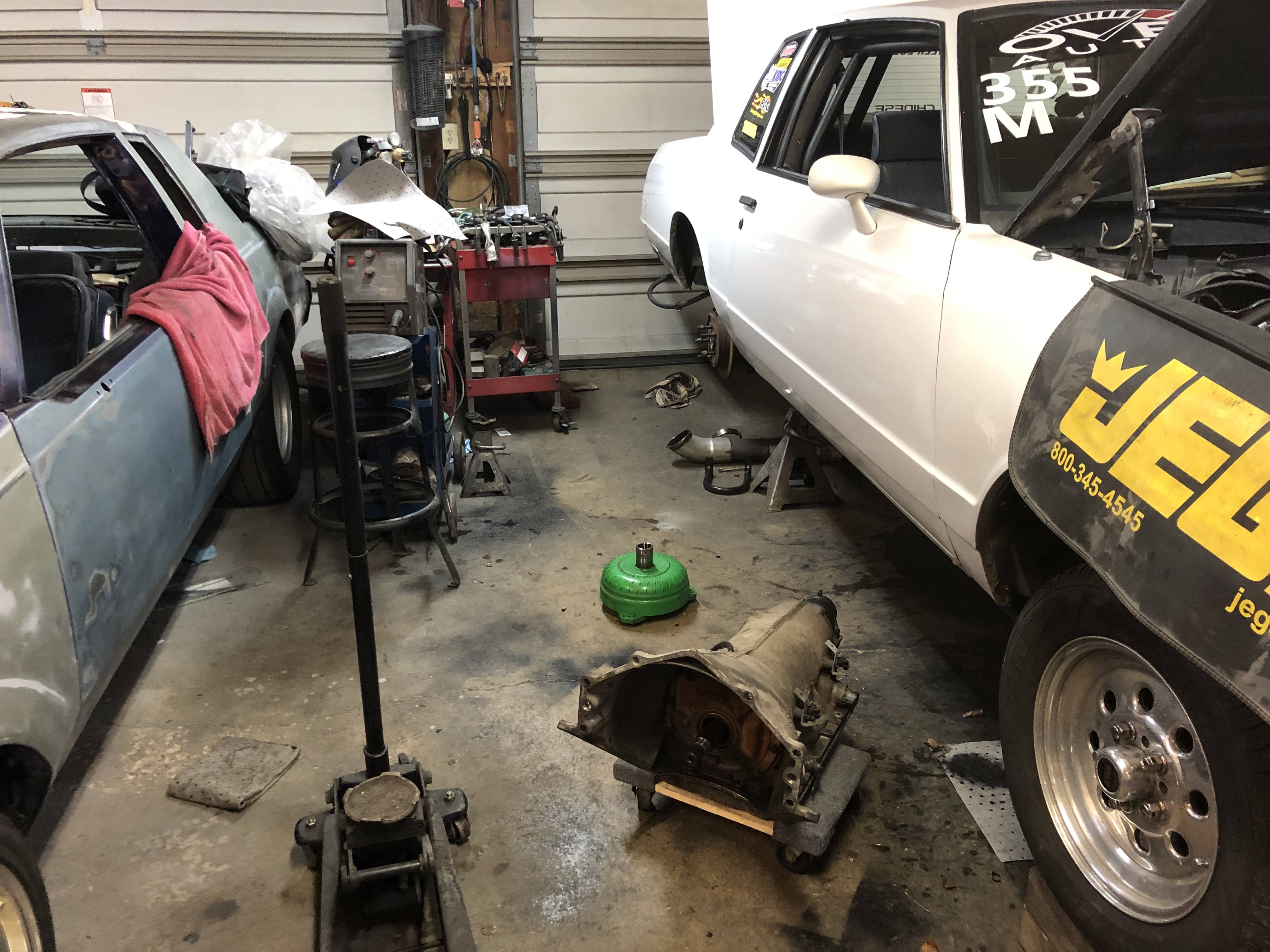

For God's sake man!! How are you ever going to get Anything done, working in such a cramped environment.
Step one should be to find a place with some room in it!!!!~
Stop over, get my wife drunked up and convince her that I need an 18x28 add on. I’ll buy the booze if you can pull it off.

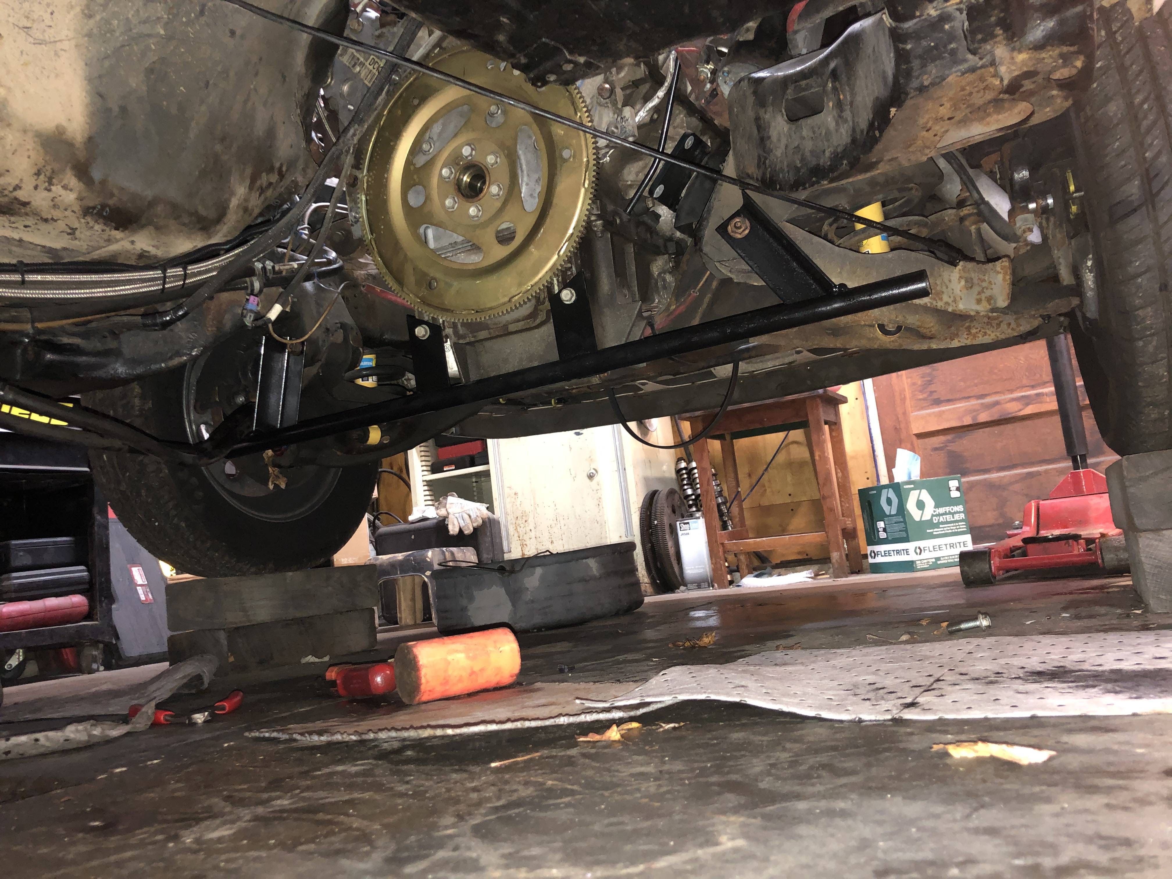

I made this bracket to set the engine at normal install height so I can keep working on it while the trans and converter are out for upgrading. The bolt holes on the rear of the oil pan have turned out to be handy.
The converter is going to Texas and the trans to Homer…….Homer,NY that is 😉
View attachment 190452View attachment 190453
That is a damn fine solution!
Thanks. Made from scraps laying around. I can’t pull the trans with it hooked up because I have to drop the rear of the engine to get to slide off, but ….. 565 mentioned that he made a device of some sort to mount to the bell housing bolts to do the same thing. It got me to thinkin’ :-/
Pfft you wouldn't need that if you had solid motor mounts...
