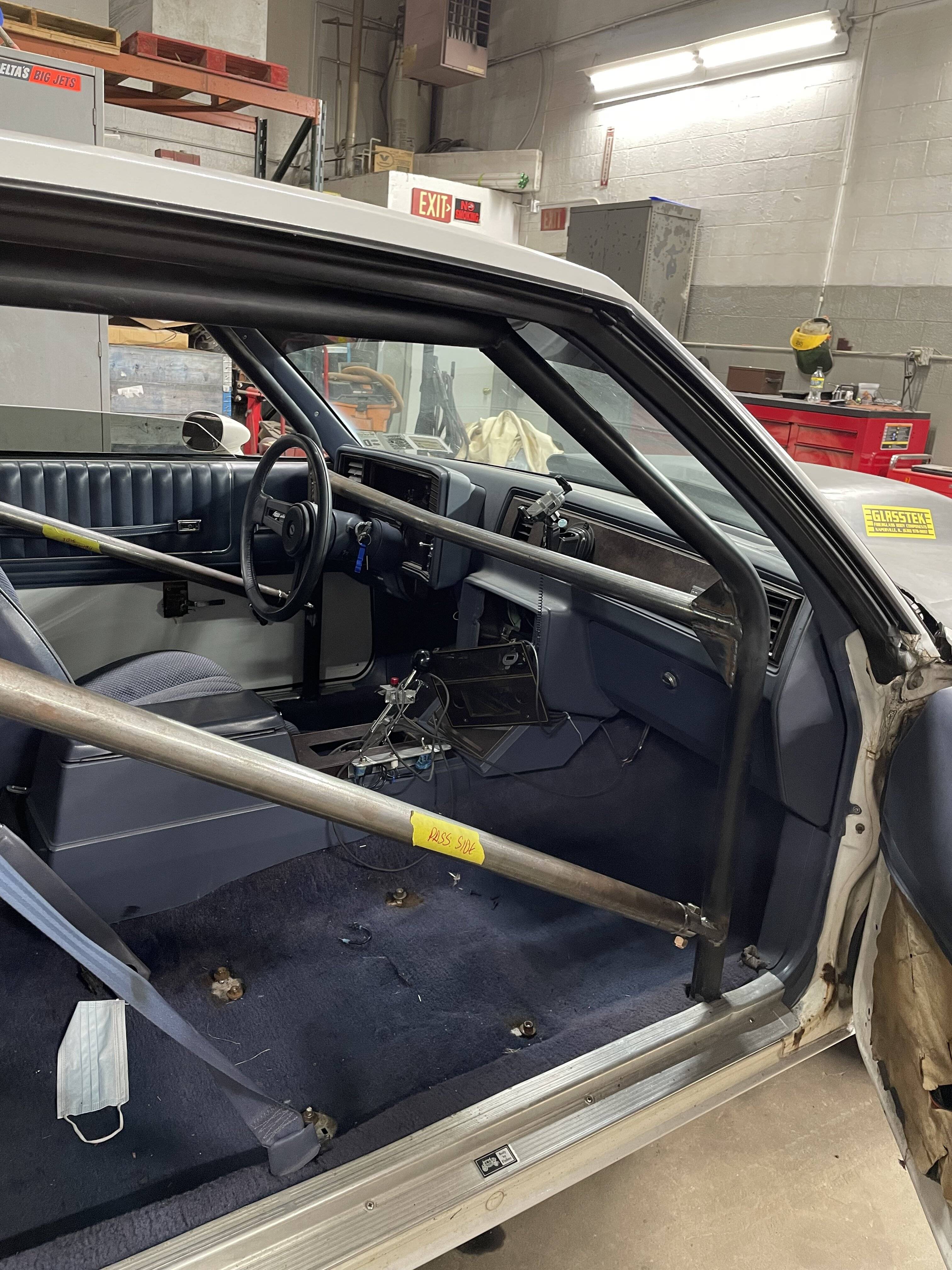

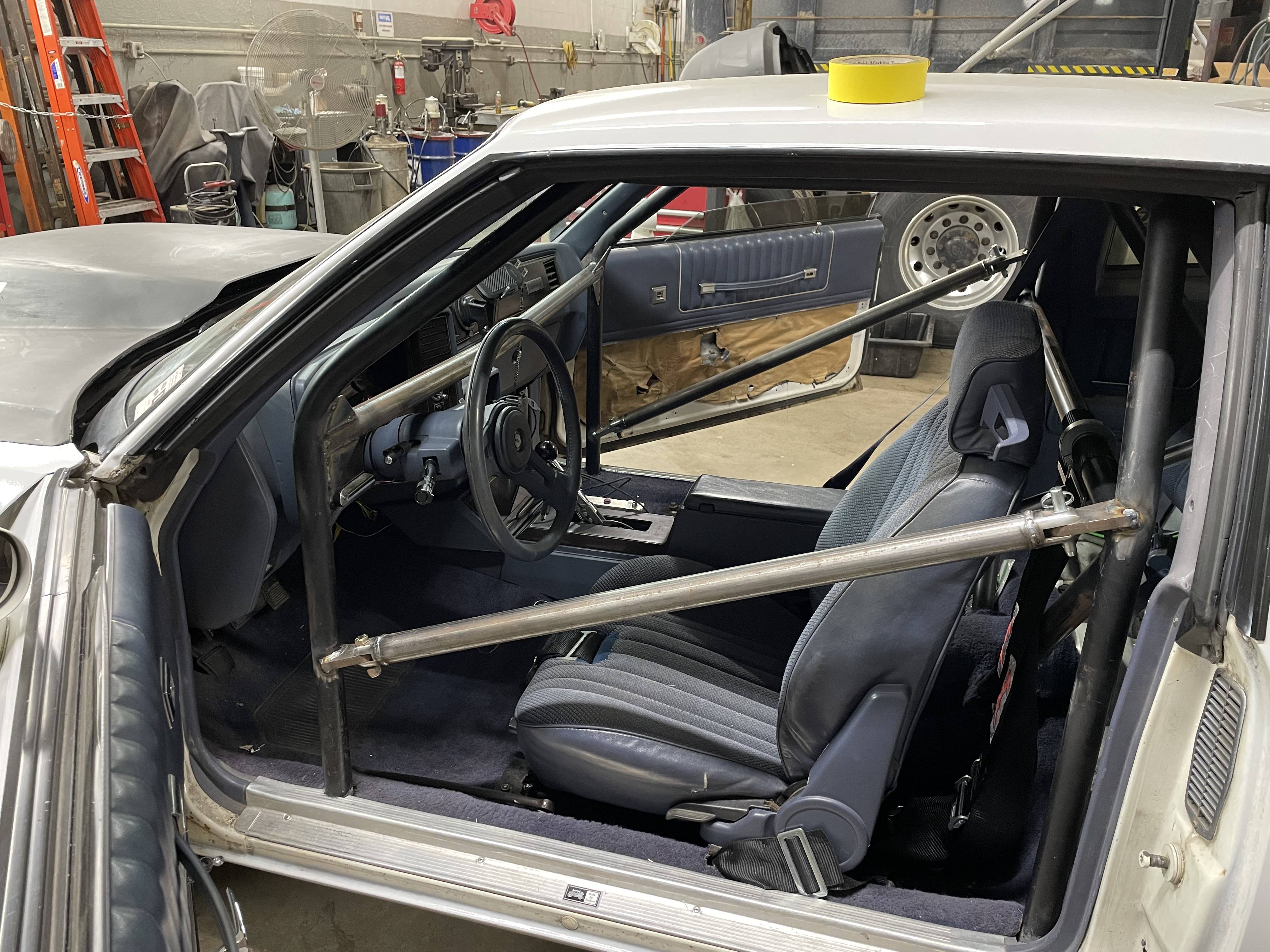

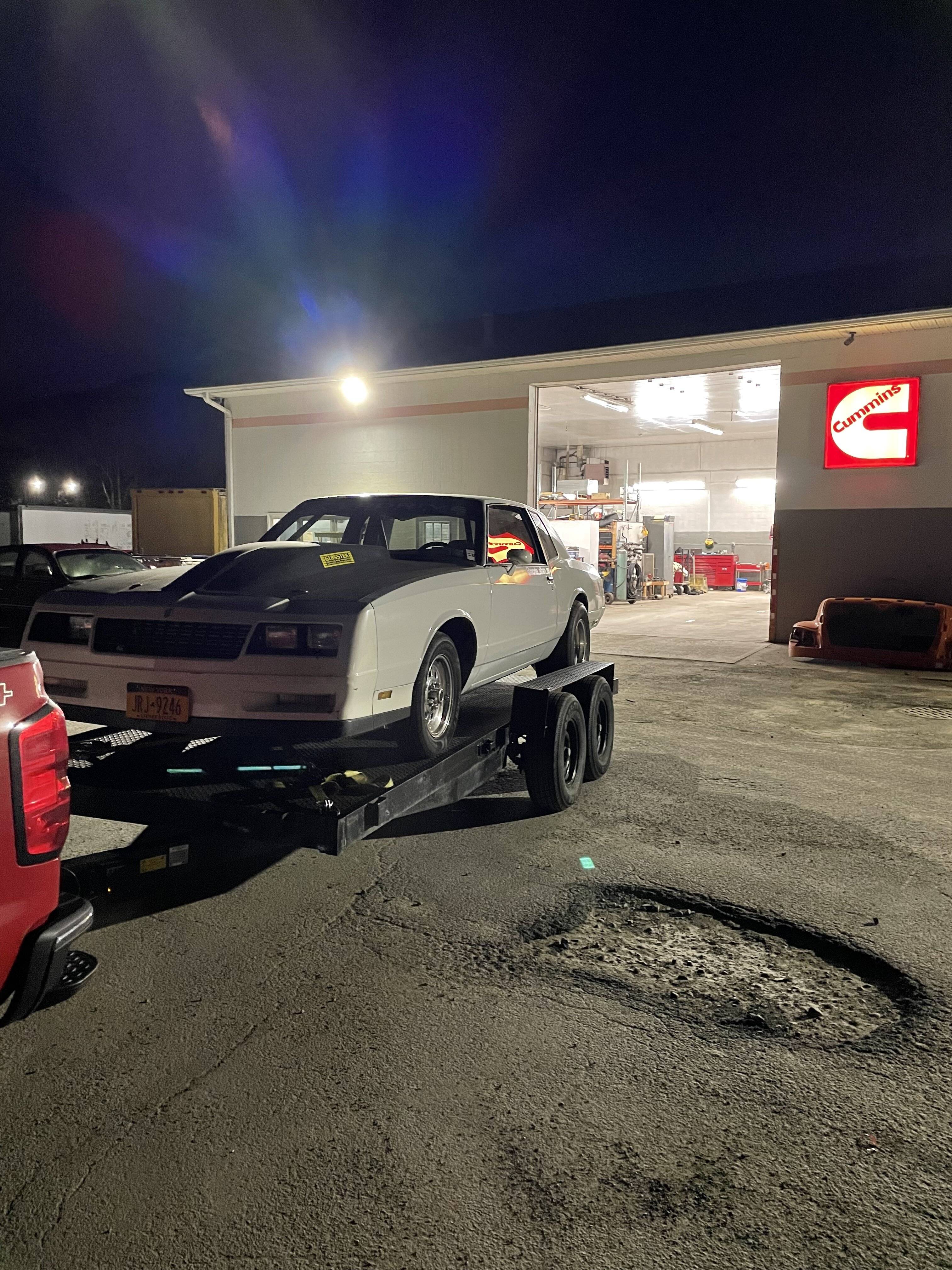

Made it to my NHRA tech inspection - barely. I had no idea what to expect. As it turns out the car never left the trailer. If I’d a known that, then I would’ve not bothered installing the converter and trans. I will be be more knowledgeable next time lol.
I had to drag the car to my work for access to a welder that would burn in the door swing outs. Thursday’s night I had a friend help me winch it on the trailer and off I went. I got the dash bar in Thursday nite by 3am. Friday night, last night, I got the door bars in and the trans and converter. The converter showed up Friday at 4pm. I had assumed that the car would need to move, but I was wrong.
So I finished with the bars, converter and trans, and loading in the trailer at 4:55am. I got home and showered and slept for 2.5 hours and headed off to the inspection (1 1/2 hours away).

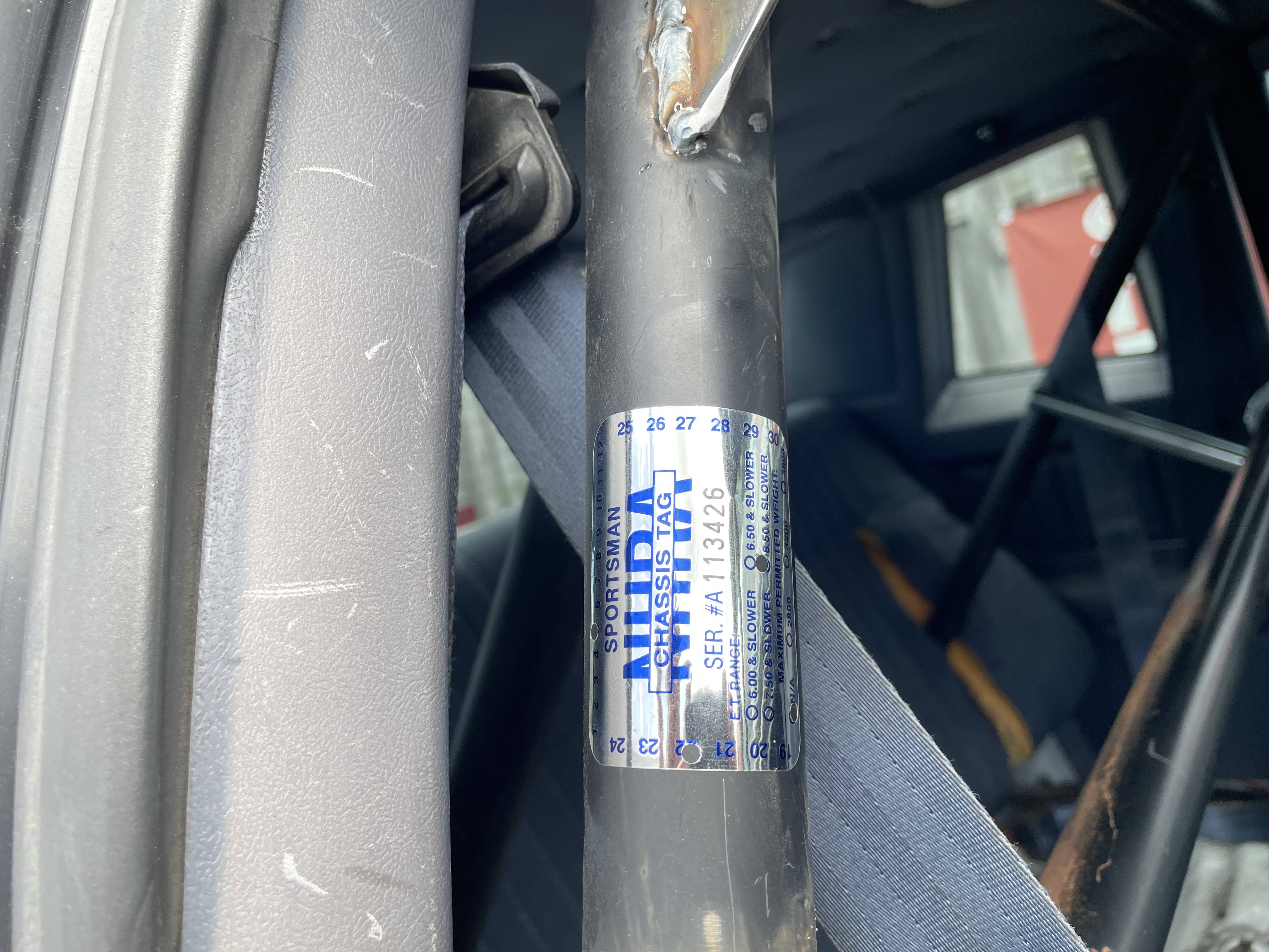

They were most concerned about the cage attaching points to the frame .They mentioned that the welds, despite not being pretty, obviously had penetration and enough heat (no bird sh*t). He recommended an additional gusset on the passenger side where the main hoop intersects the roof hoop. And they told me my driver door bar is about an 1” to high in the front, but it’s not a big deal because I had the dash bar. They didn’t look under the hood, they did verify the 9” wheel ends, checked the seat, seat brace and belt mounting.
He also checked every tube for thickness and diameter.
It was pleasant deal. The two NHRA guys were great - friendly, knowledgeable and didn’t mind discussing what they seen on my car.
I’m glad it’s done, I was stressing over it too much, unnecessarily as it turns out.

Yeah if I was here more I could have told you a chassis cert has nothing to do with the drivetrain. It’s a common thought. You can bring a bare chassis with no body and they could put a sticker on it. If you ever have a drag racing question send me a message. My car was 8.50 certified for 20 years. Nhra Super Gas 1221.
