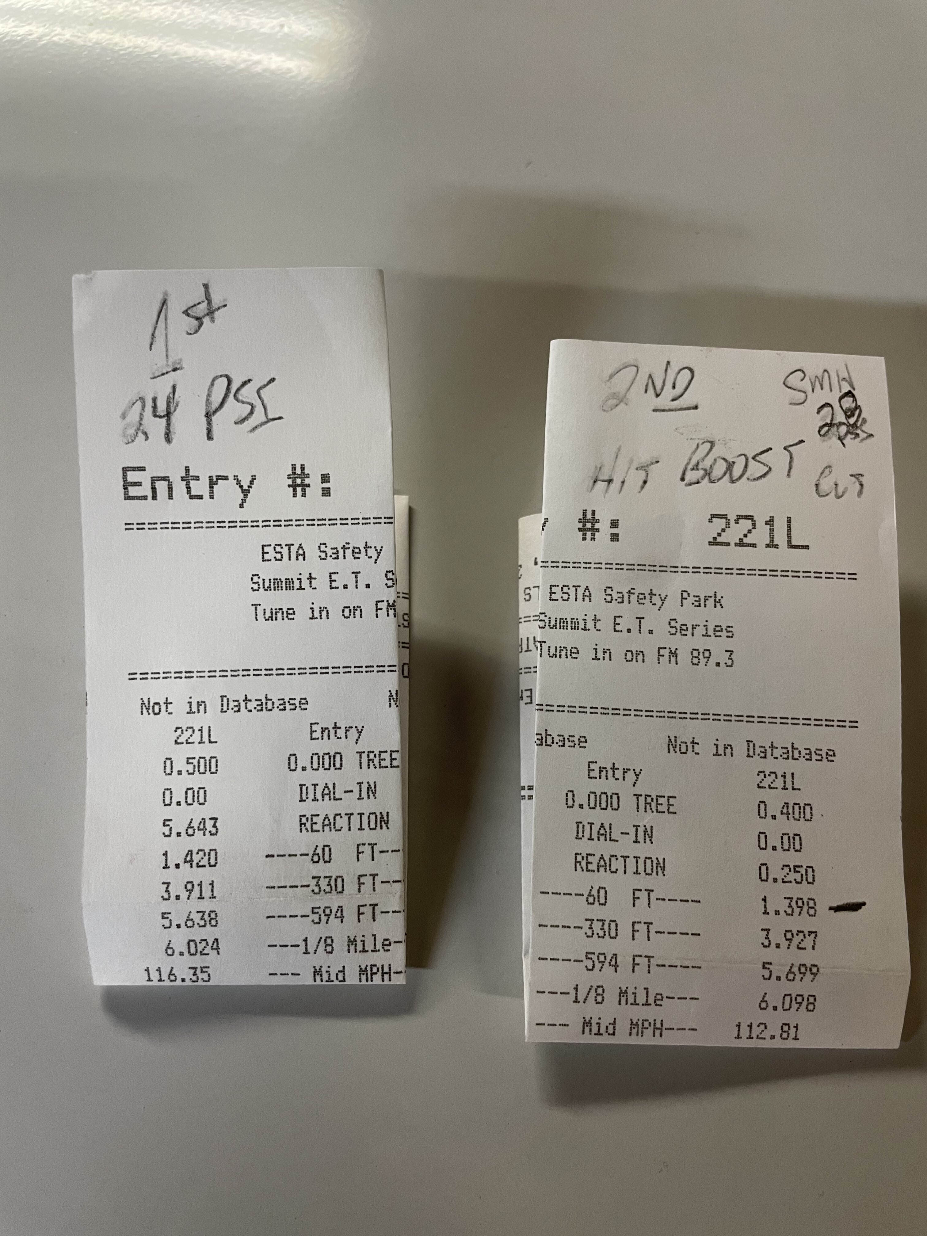

Made it to the track Sunday. They only ran 1/8 due to a wet shut down area - so that sucked somewhat.
The 3rd fuel pump works. I had a couple of minor issues with the settings after the 2nd run. I made a couple of adjustments to the activation of it and I made them in the wrong direction. When I did that, it never ran out of fuel to the point that the injectors weren't big enough, but he injectors had to compensate for my change. I also learned something about the Holley I/O box.
Regarding the I/O box that I recently praised, and still do, there is one thing about it that is different than the main ECU. Whenever a change is made to any of the settings or tables for the I/O a power down cycle HAS to be performed for the changes to take effect. The settings in the I/O box are are sent to the I/O box from the main ECU EVERYTIME the power is cycled. This unlike the main ECU which can have changes made on the fly. This is indicated in the instructions in a sentence that I had forgotten about. But live and learn.
Regarding the runs, the 1st was a low boost (24psi) to make sure the 3rd pump worked - it did. The second run was my best, except I forgot to turn off the boost safety from the 1st run. So during the second run when it hit 29psi I hit boost cut and it went to - degrees of timing and felt like the transmission slipped. It was late enough in the run that I just lifted and still ran a 6.098. But, the surprising win to me was my first sub 1.4 60'. Albeit barely less than 1.4, but I did not think that I would be able to get into a 1.3____anything with this low budget suspension setup and I WAS WRONG. If I hadn't hit the boost cut I'm quite sure I could've ran a 5.8 with that 60'.
