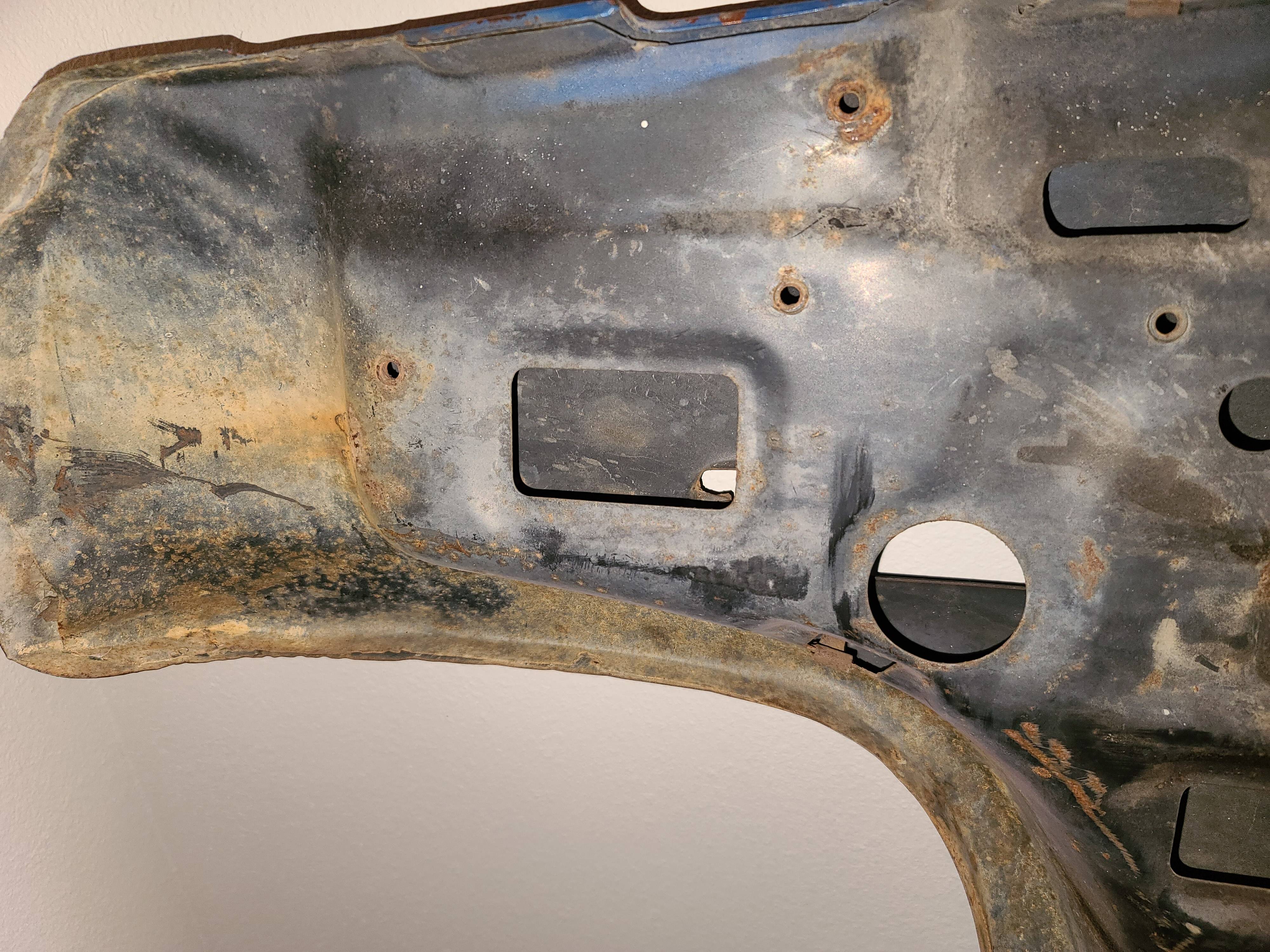

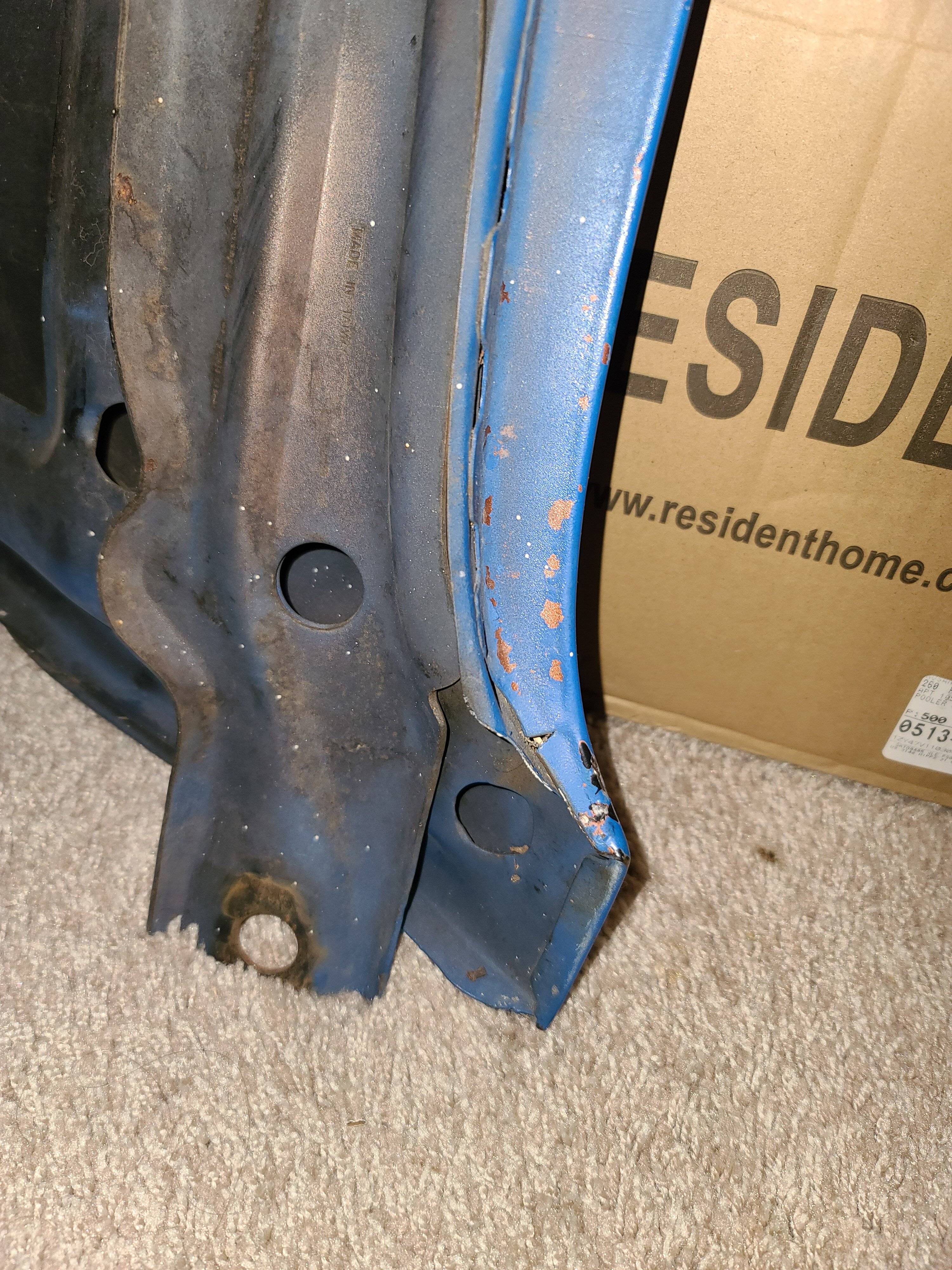

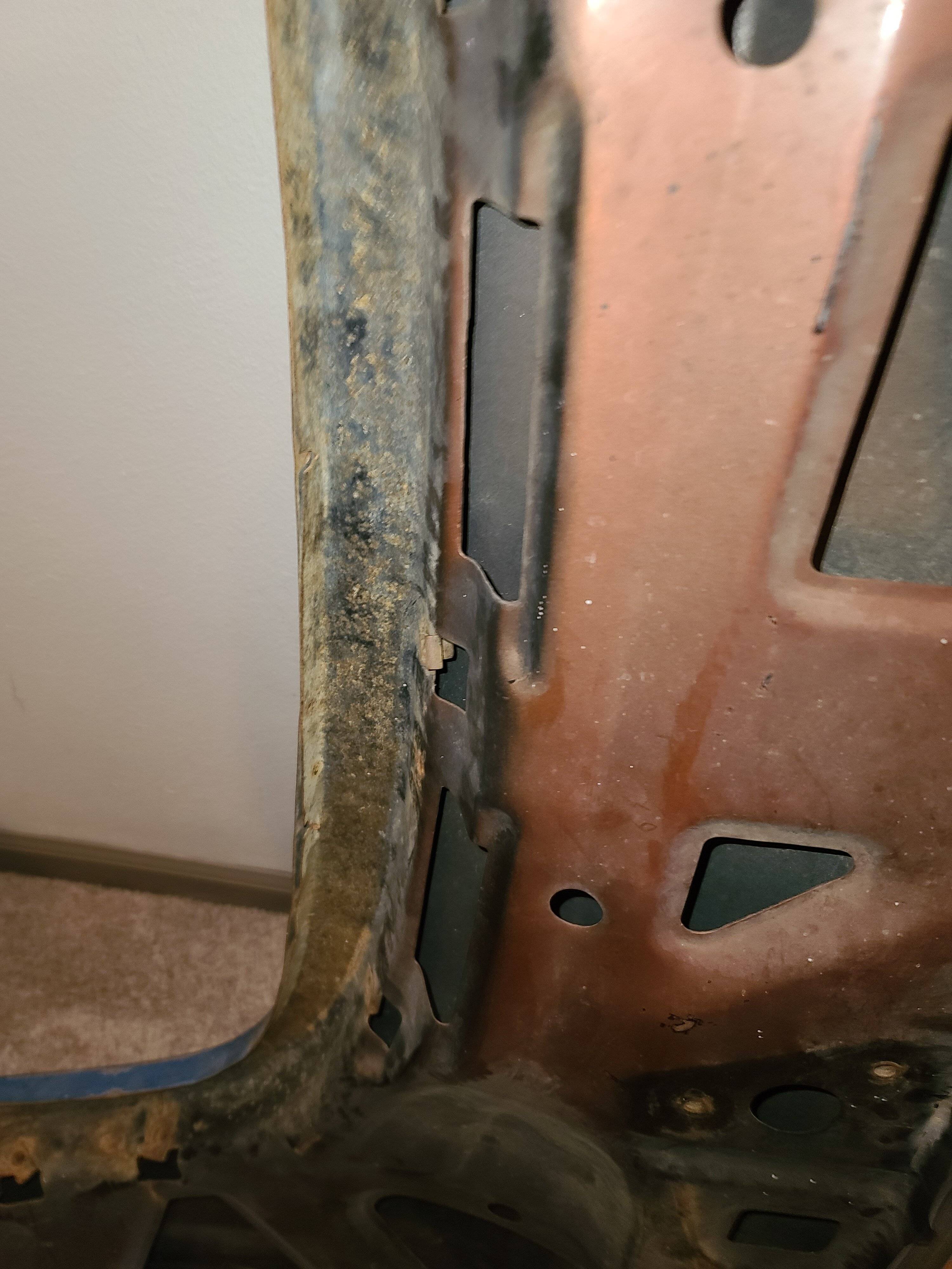

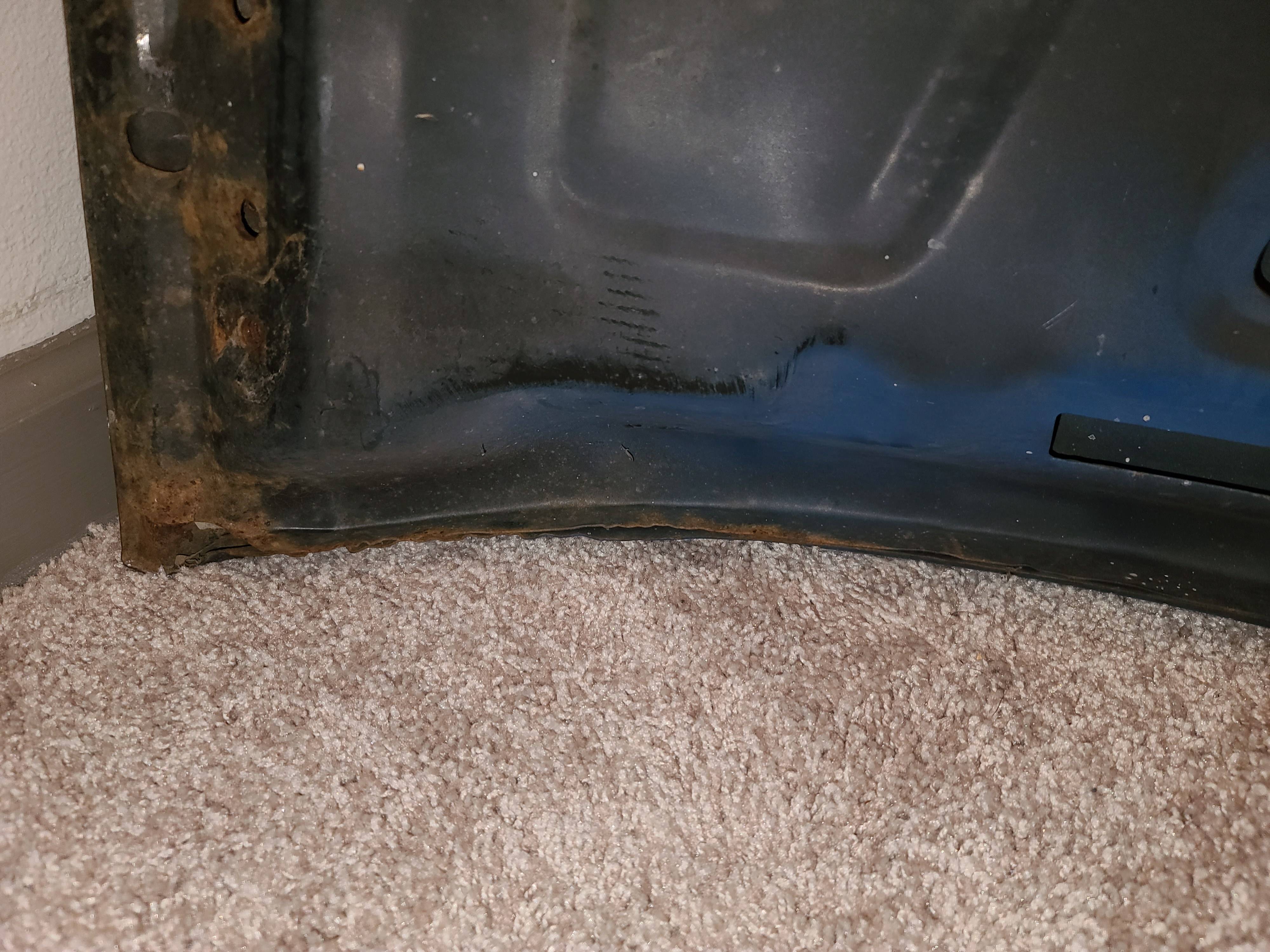

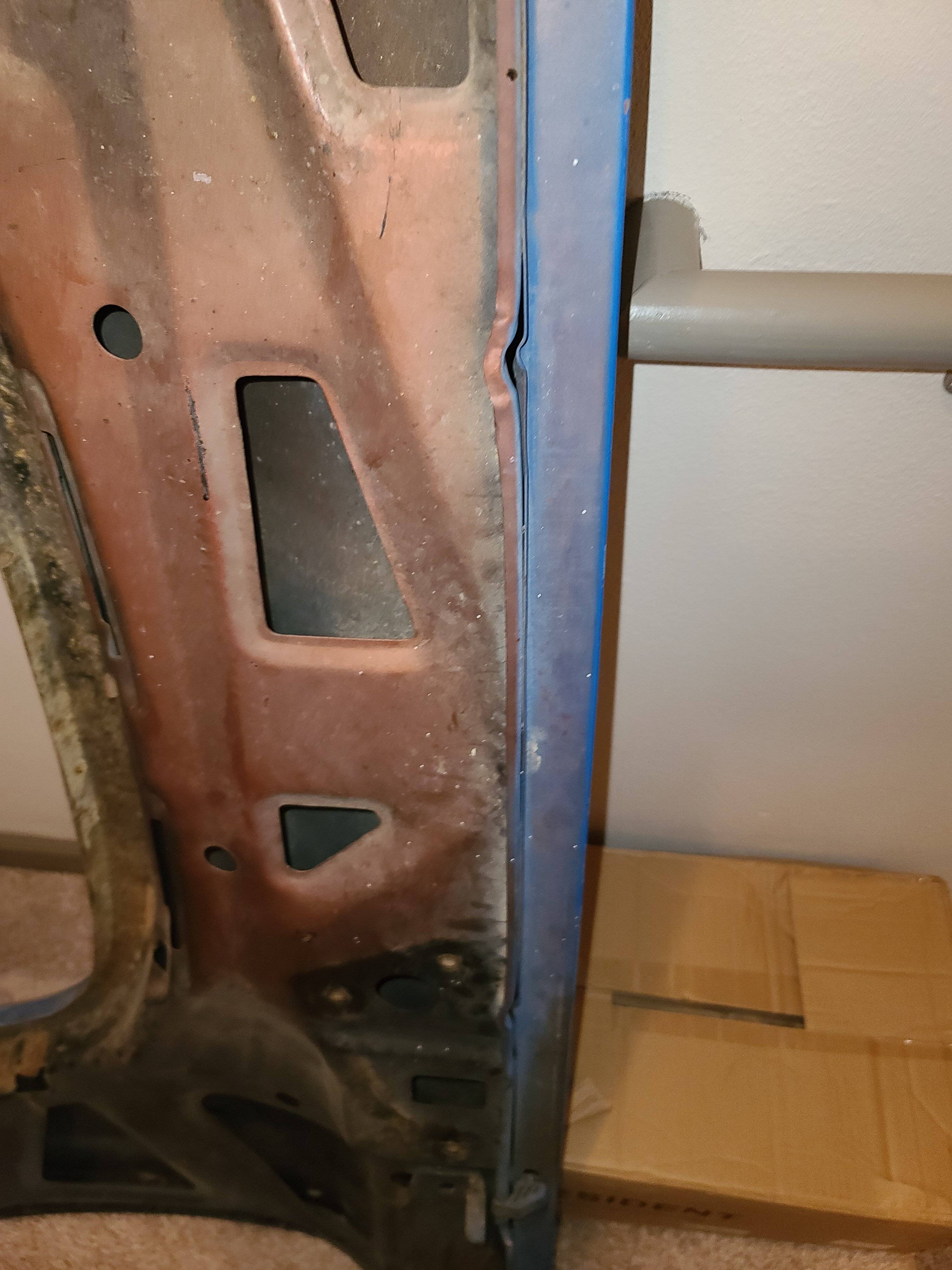

Thanks for the feedback so far, but.... Well, I'm not interested in any type of "encapsulator" or "neutralizer" coatings. There are so many seams at so many angles, it's not going to seal it all, it just won't.
Here's some pics of the volume of seams. Basically the whole perimeter is involved.
The amount of flipping, twisting, contortions, and then having exposed surfaces where the stuff is glopy drippy, running, what have you.... not for me. Plus, that's just a cosmetic bandaid... even if it did fully penetrate (which I doubt) it's not removing the rust which is what I'm after. Still, for a broken truck repainted blue once they're pretty decent compared to Chinese.
