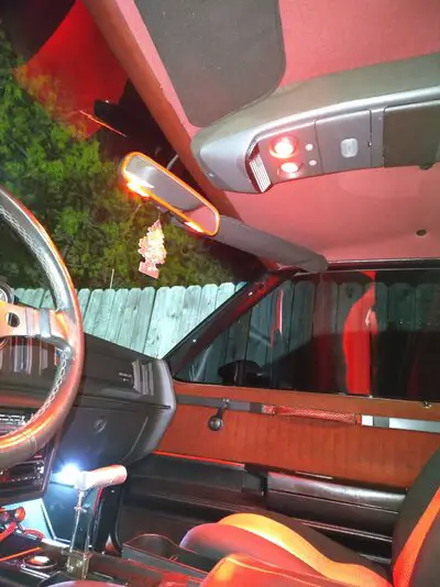

Also, you probably already know this but get rid of the stock bulbs in there if you havent already, they suck! 😂 I put red LEDs up front and a really bright white LED in the back. I got them on amazon and i can give you the link to the bulbs if you want

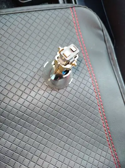

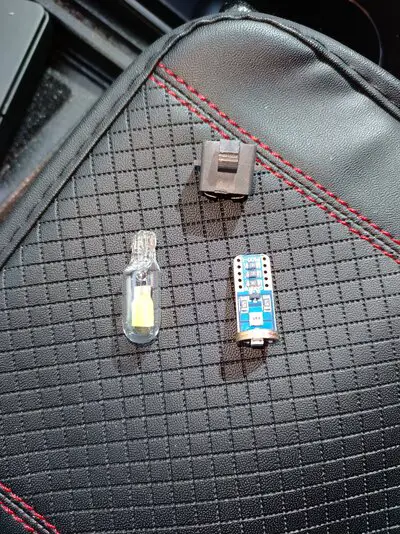

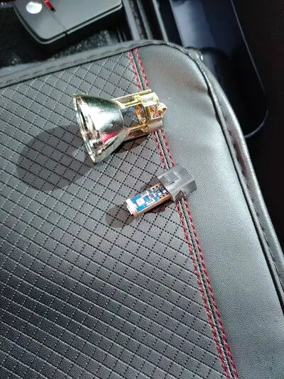

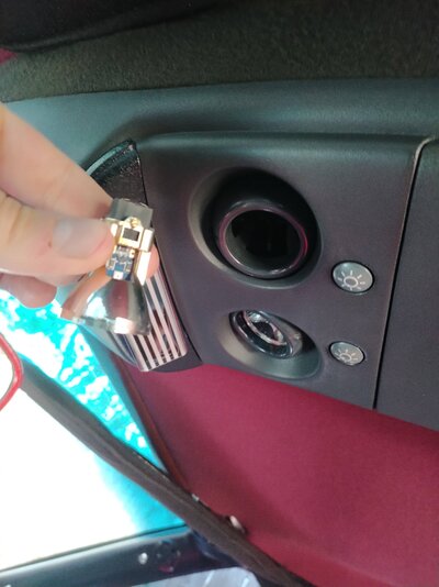

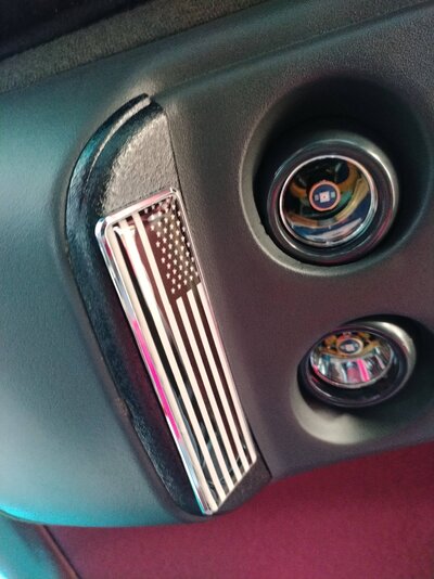

Ok, im out here right now, and popped them in and out. no tools used. Check it out. You can twist the housing out with the bulb in there already with two fingers. Reinsert it the same way. Depending on the size of the Led bulb, you can either insert the bulb from behind or in front of it. Also as pictured, i have a superbright led next to the led bulb im using, and i can confirm the sueprbrightled 194 will fit in this socket and work if you choose to use them for the bulbs!

The actual bulb, I used a screwdriver and pushing to release it from the housing. But once it is out, it has a safety or something keeping it together with the lens
Hmmm, mine appear to be different. They have a lens on them
