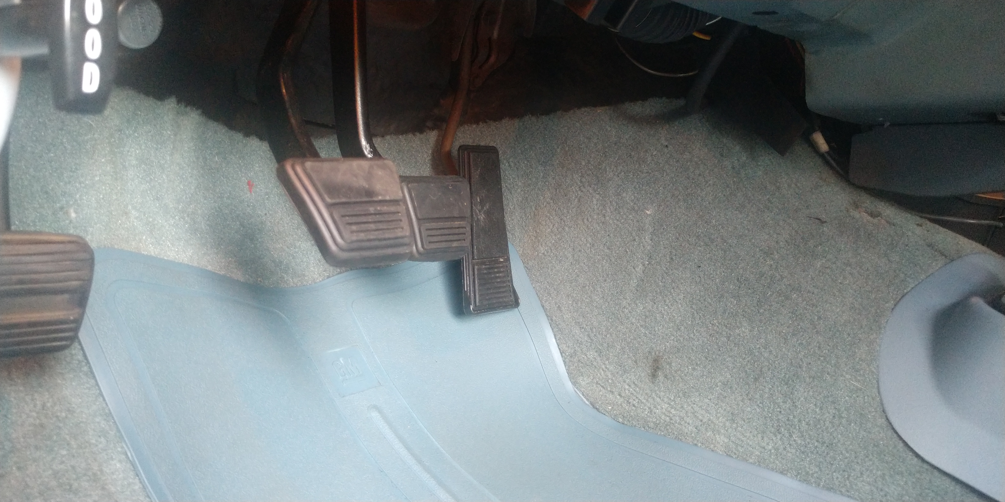

This aftermarket kit doesn't include one and the pedal will lift quite high without it. This is how it looked with the lower pushrod included in the kit.
The pedal comes up high even with the factory pedal stop. You need the high pedal to get full travel of the clutch.
Where it is in my picture the clutch was fully disengaged before the clutch pedal was even with the brake pedal, any more than that and it was going to start bending the linkage.
Here is mine. Keep in mind I am using the heim jointed Speed Direct clutch push rods. Mine was still like this with stock GM parts.View attachment 154398View attachment 154399
Yeah that's where mine is now. Hard to see in my picture, but where it was before was probably the same height as the front of the seat. I'd never be able to get my foot in it.
