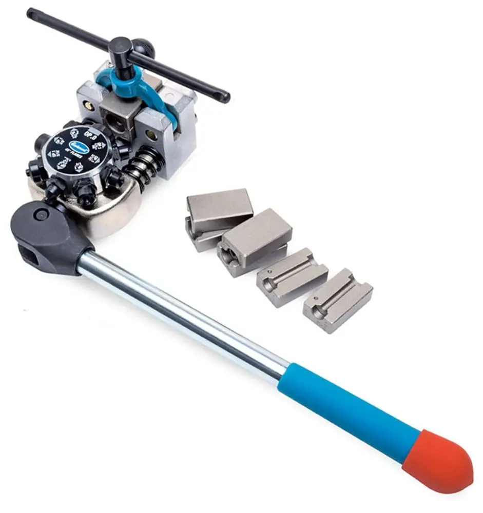

It's not cheap, but the Eastwood Flaring tool worked great. From the first practice flare (I did several) to the actual lines I needed.
Here's a video of me using it. (It's at minute 8:18)
Hutch
Hutch
That tool would be great if you are doing all the flaring on the bench but when doing the flaring on tubes that are installed in the car the common style of a flaring tool works. I use the KD flare kit
