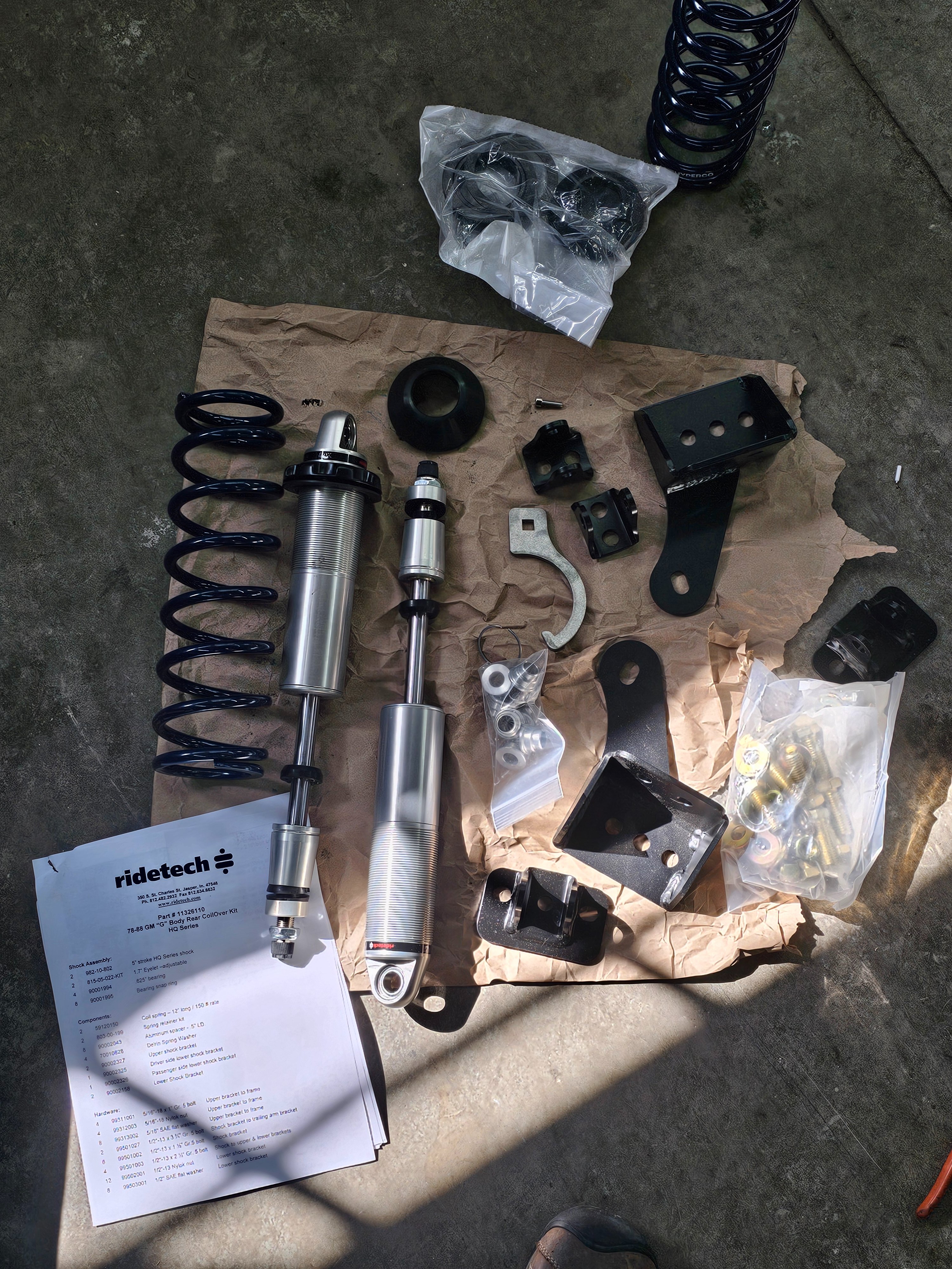

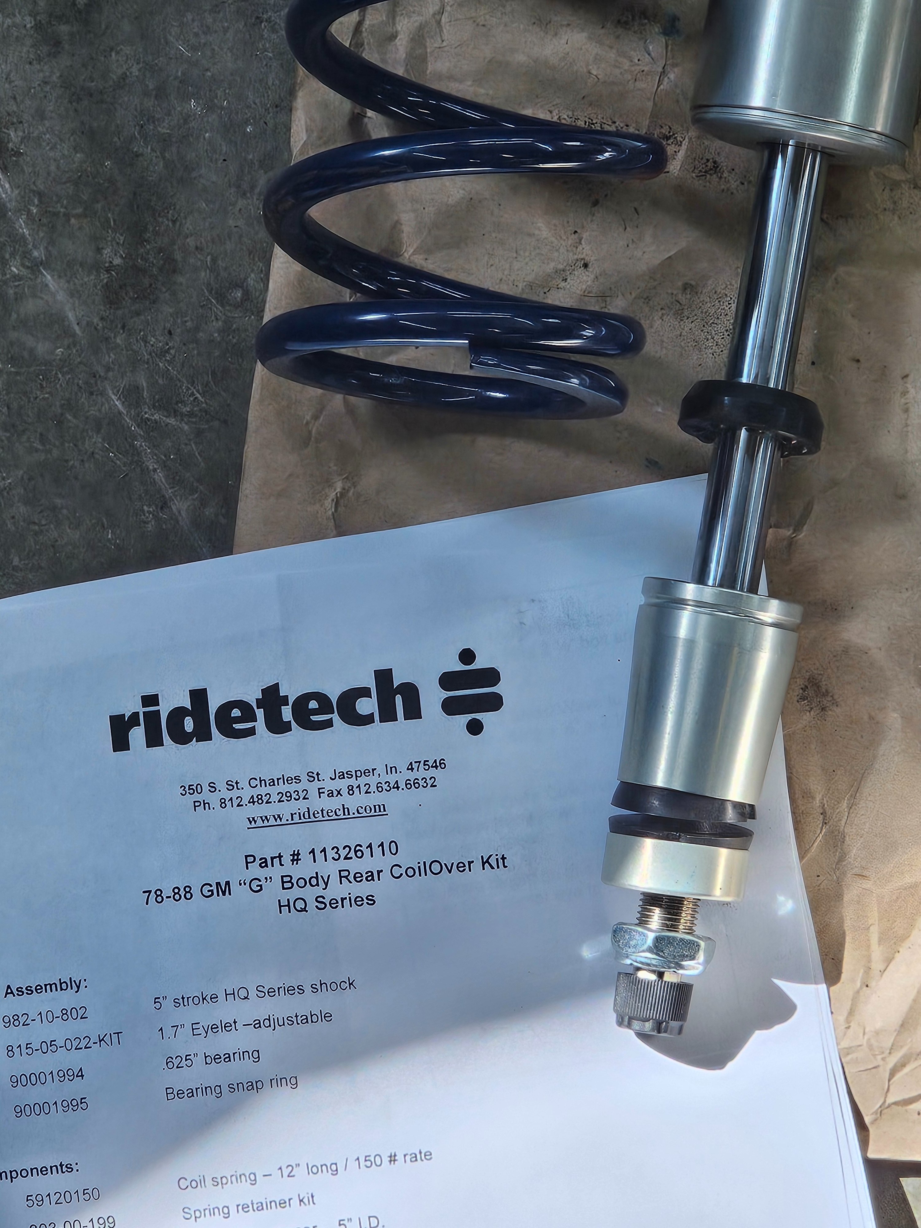

Today I was going to install my new RideTech rear coilovers. Sat down, read thru the instructions and started assembly. Once it came time to compress the spring and get the retaining clip on, I realized they sent me the wrong shocks. They are supposed to have an eyelet at both ends, and these have a stud on the top. Of course they are closed on the weekends, and I had a h3ll of a time getting ahold of them when I ordered these. I guess that should've been my sign. I'll have to start dealing with that on Monday I guess.

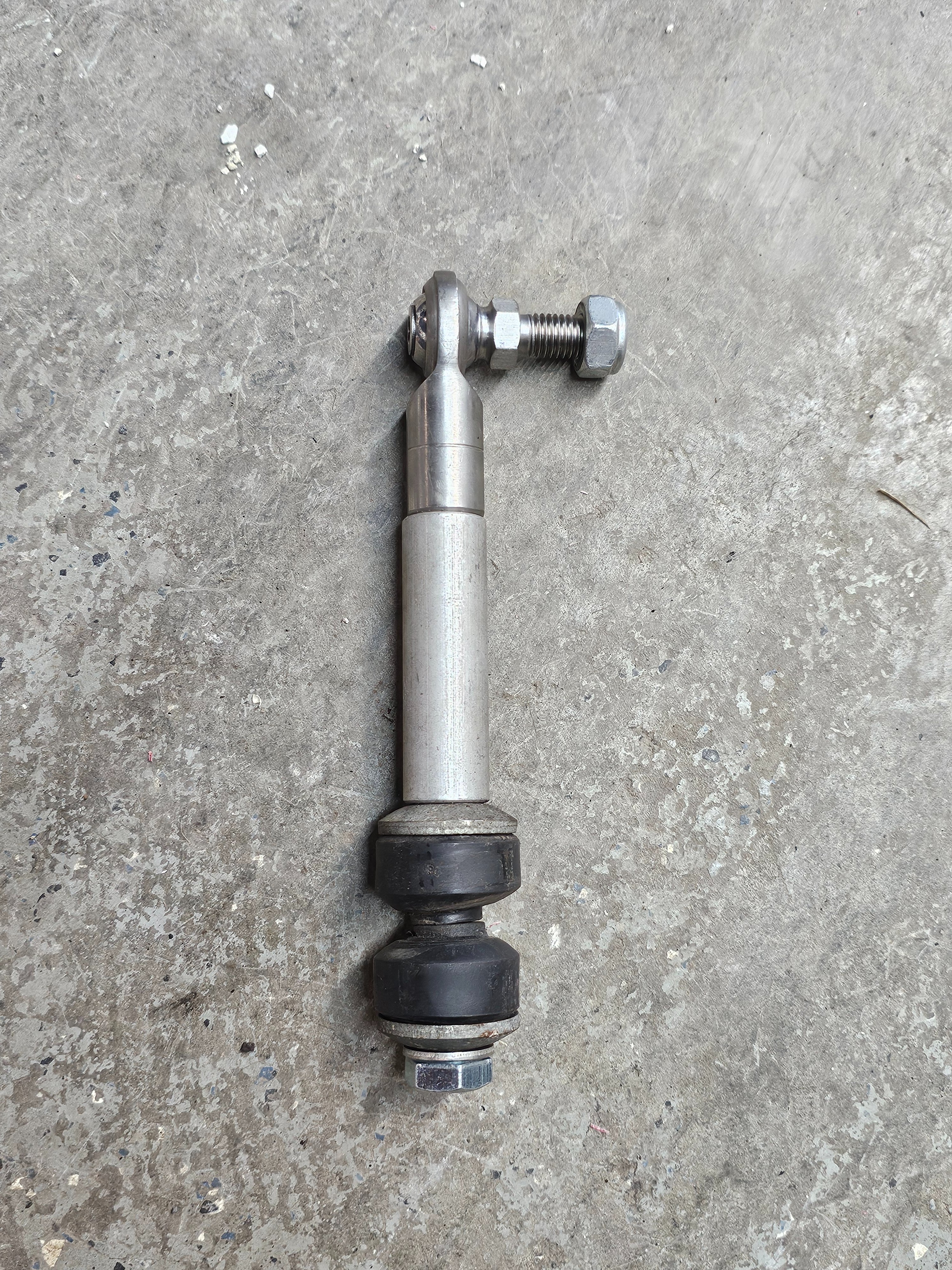

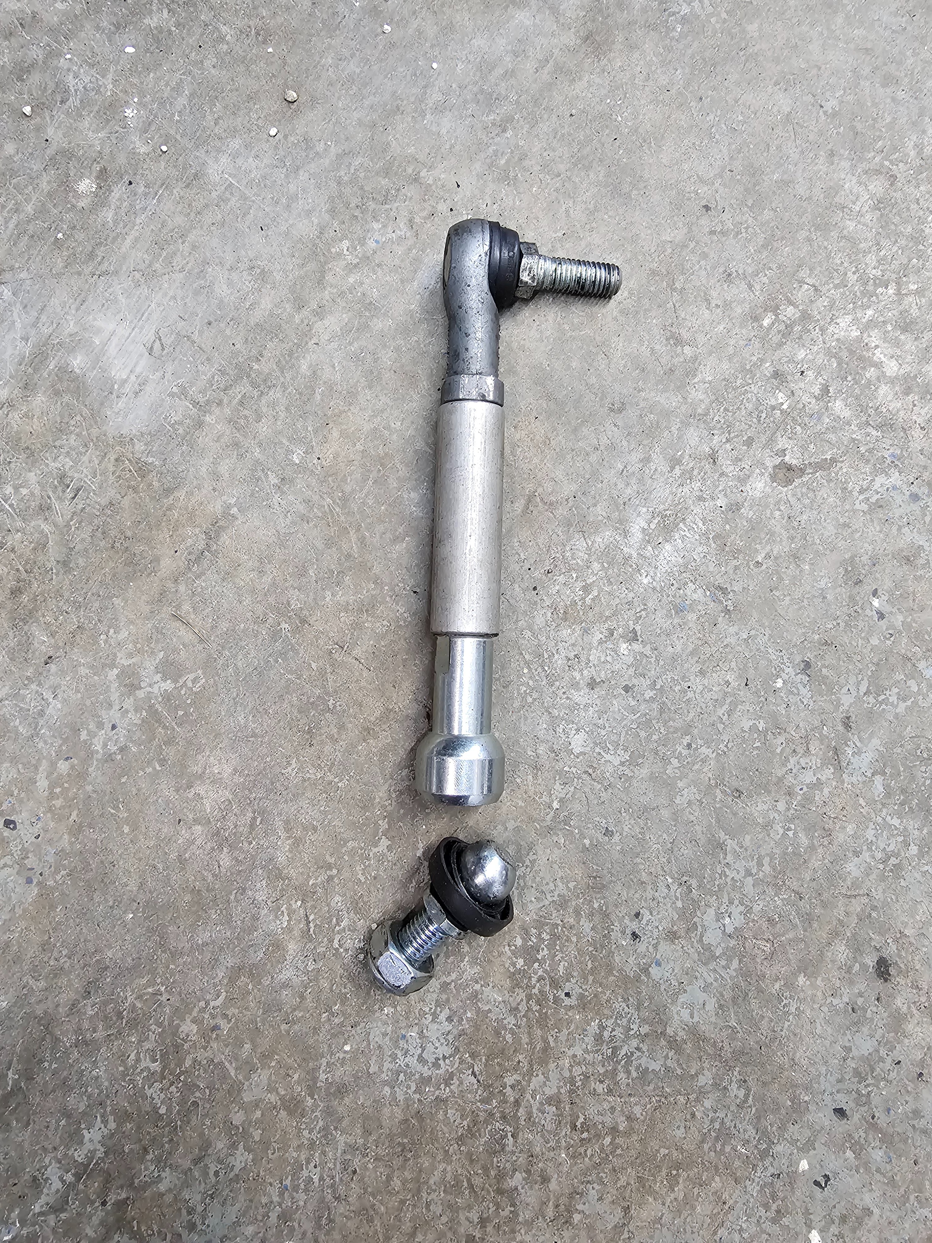

Now onto yet another RideTech issue. I bought their front sway bar, which is no longer in production, from a friend online. The bar itself seems to be great, the end links, not so much. They used swivel style balljoints on both ends. Those are not meant to be used in tension, but rather compression. This causes the lower joint to constantly fail.
This is my fix. G body poly end link bushings on the a arm side, and a heavy duty rod end with included stud on the sway bar end. I reused the RideTech aluminum spacer and a M10x1.5 x 130mm bolt going thru it all and threaded into the rod end. I know the lower side won't fail now 🤣 Hopefully this solves this issue once and for all.

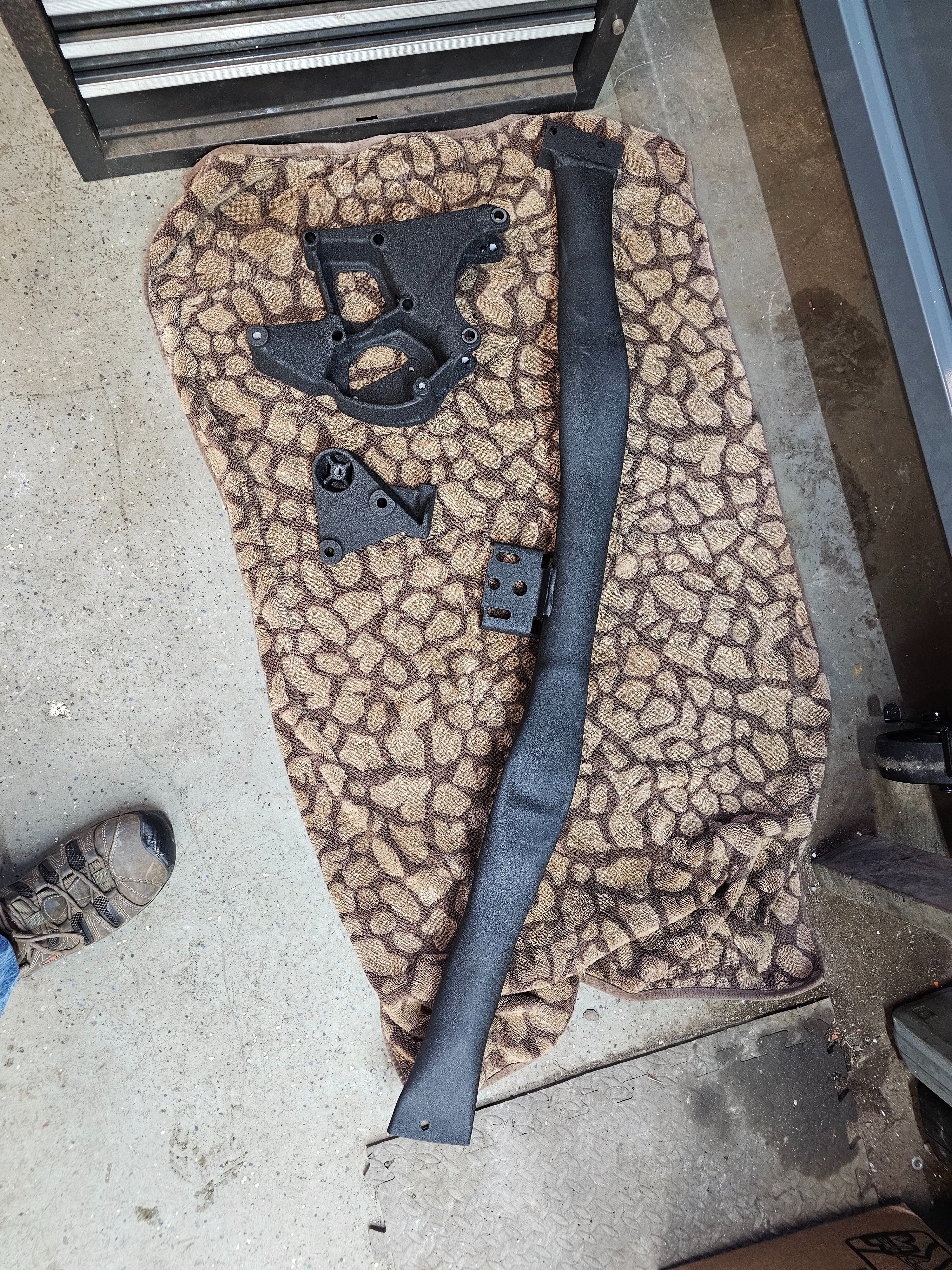

I also picked up my parts from the powdercoater. Two brackets for the belt drive, and my old transmission crossmember. Had them all done splatter black.

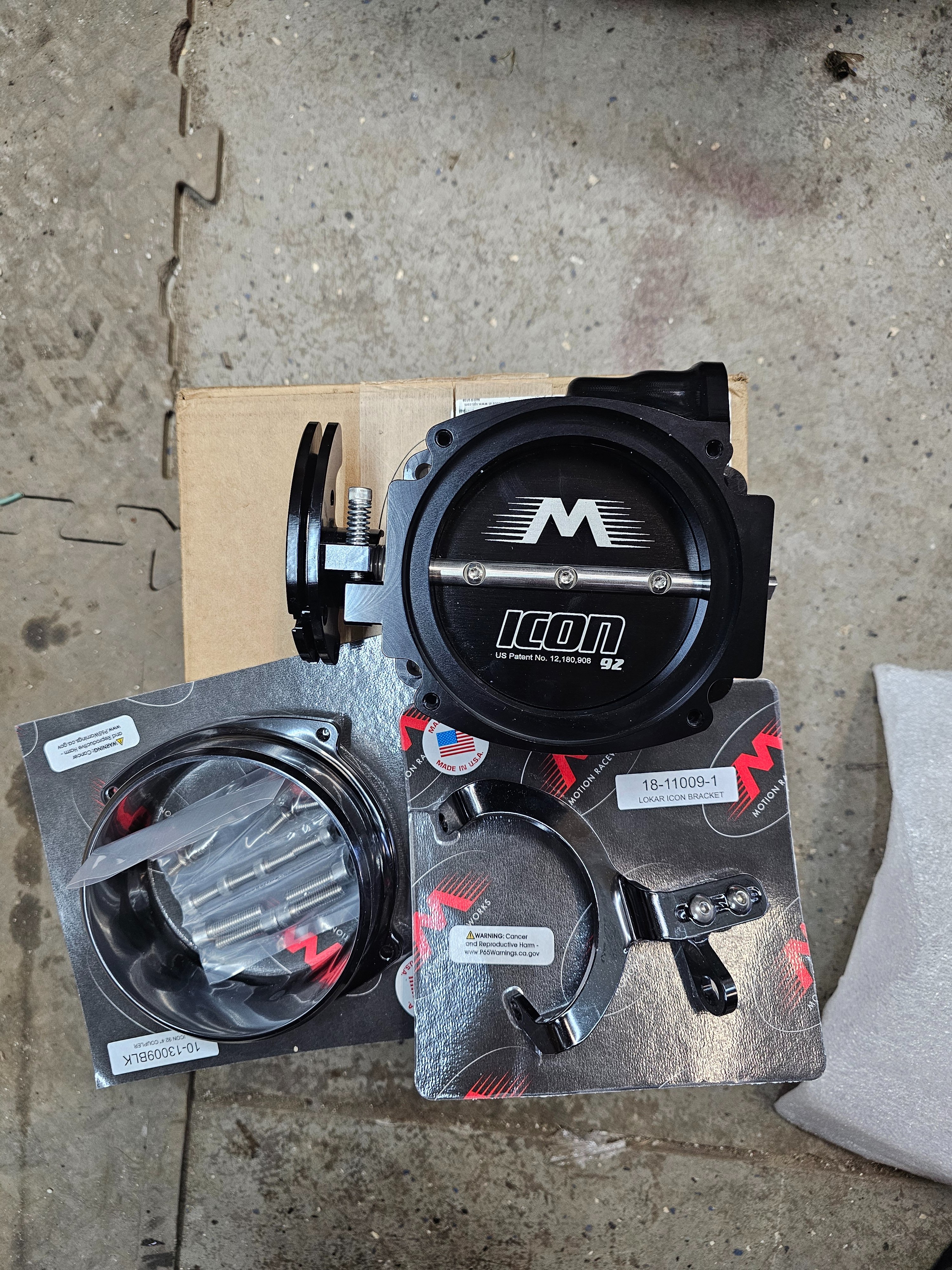

The parts fairy showed up again. Since I sold some of the old parts with my old engine, I needed to replace a few. One being the throttle body. The old one was an Amazon special and worked fine, other than the horrible IAC whistle when starting cold which they are known for. Decided since I hopefully won't be doing any of this again, to get a decent one.

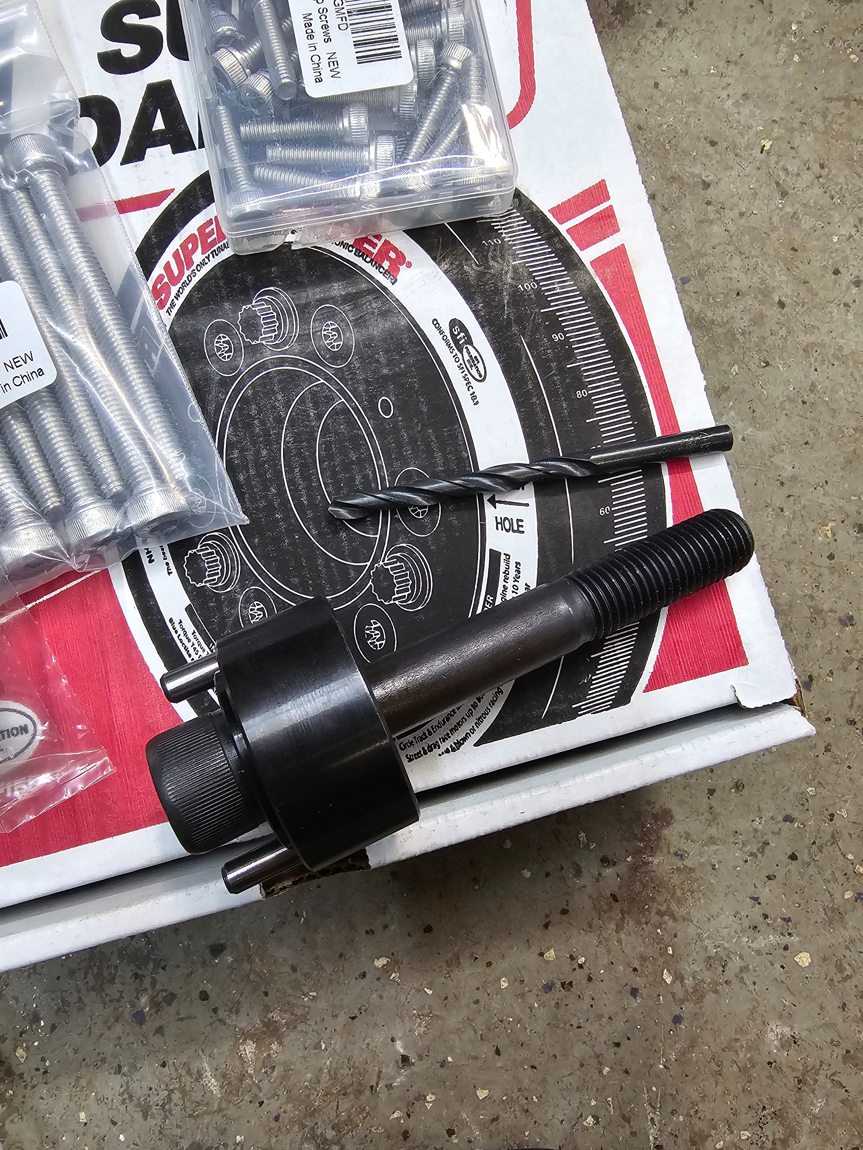

Also I needed a new balancer to line up with the Corvette accessories, and a crank pinning kit while I'm at it.

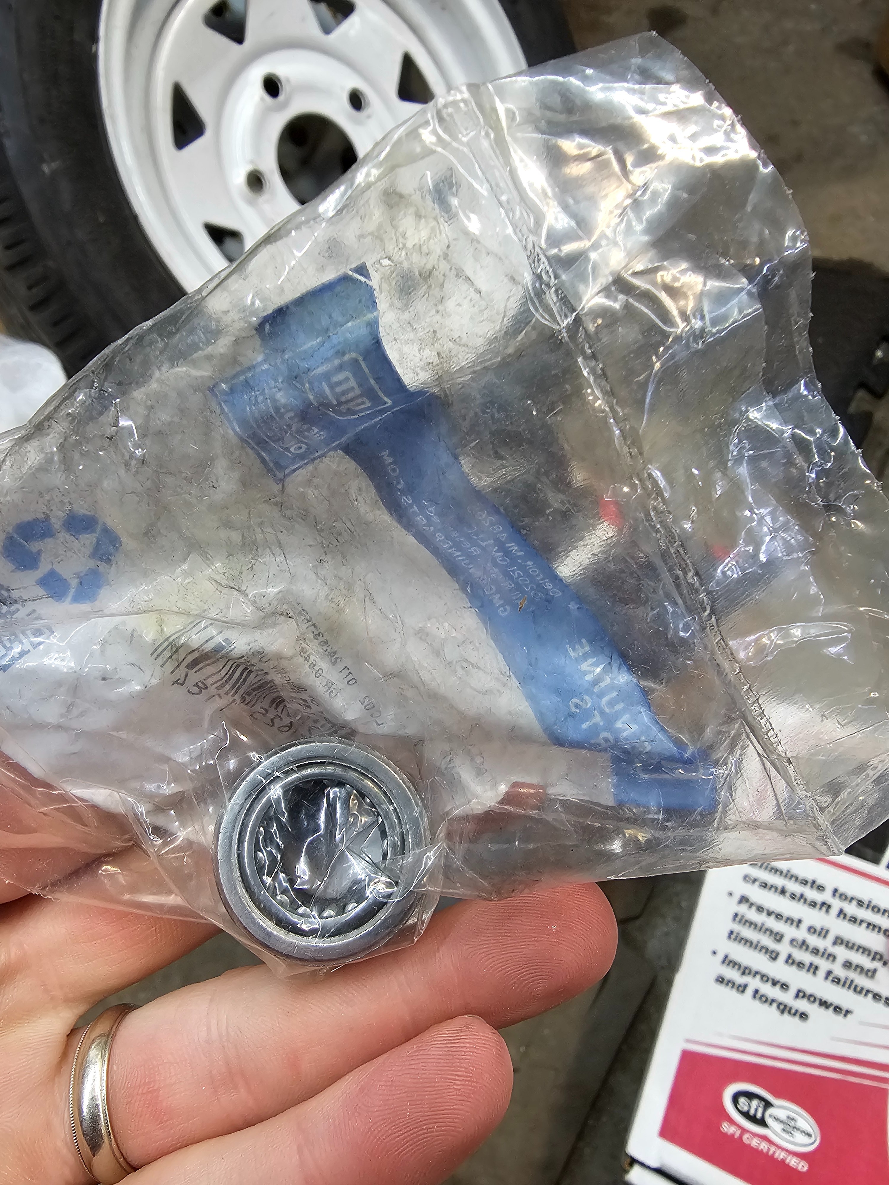

New GM pilot bearing, and some stainless hardware for the intake.

You sure there isn't a thread on adapter in there to get you what you need on those coilovers?
