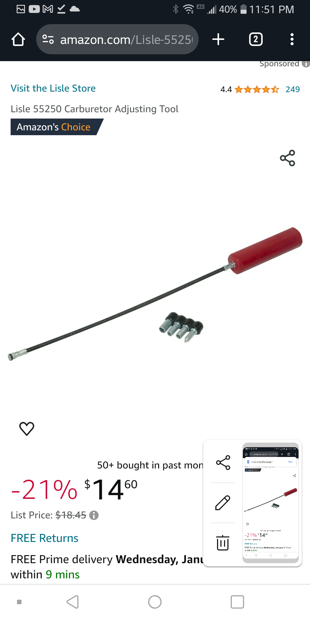

It will need special tool for idle metering adjustment.
