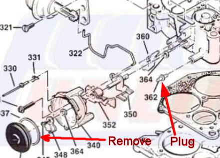

If the choke housing was removed, even an electric housing has a plug installed to prevent a vacuum leak. Part #362 in the diagram below is the plastic plug used with a electric conversion from hot air. In your photo that is a wide open vacuum leak.
A smear of silicone sealer or even JB weld (If you never plan to install the choke housing) should work to seal that port.

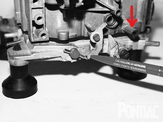

I'm just outside Buffalo NY, we've had over 4 straight days of "Liquid Sunshine" so I get the frustration. As far as the choke housing I would re install it or just plug the hole that part #362 installs into. (Red Arrow) While you are there also remove the lock out lever that contacts the roll pin on the secondary throttle shaft. (Pen Point) I've done this to every Q Jet I have to allow the secondary throttle plates to respond even with the choke activated.
