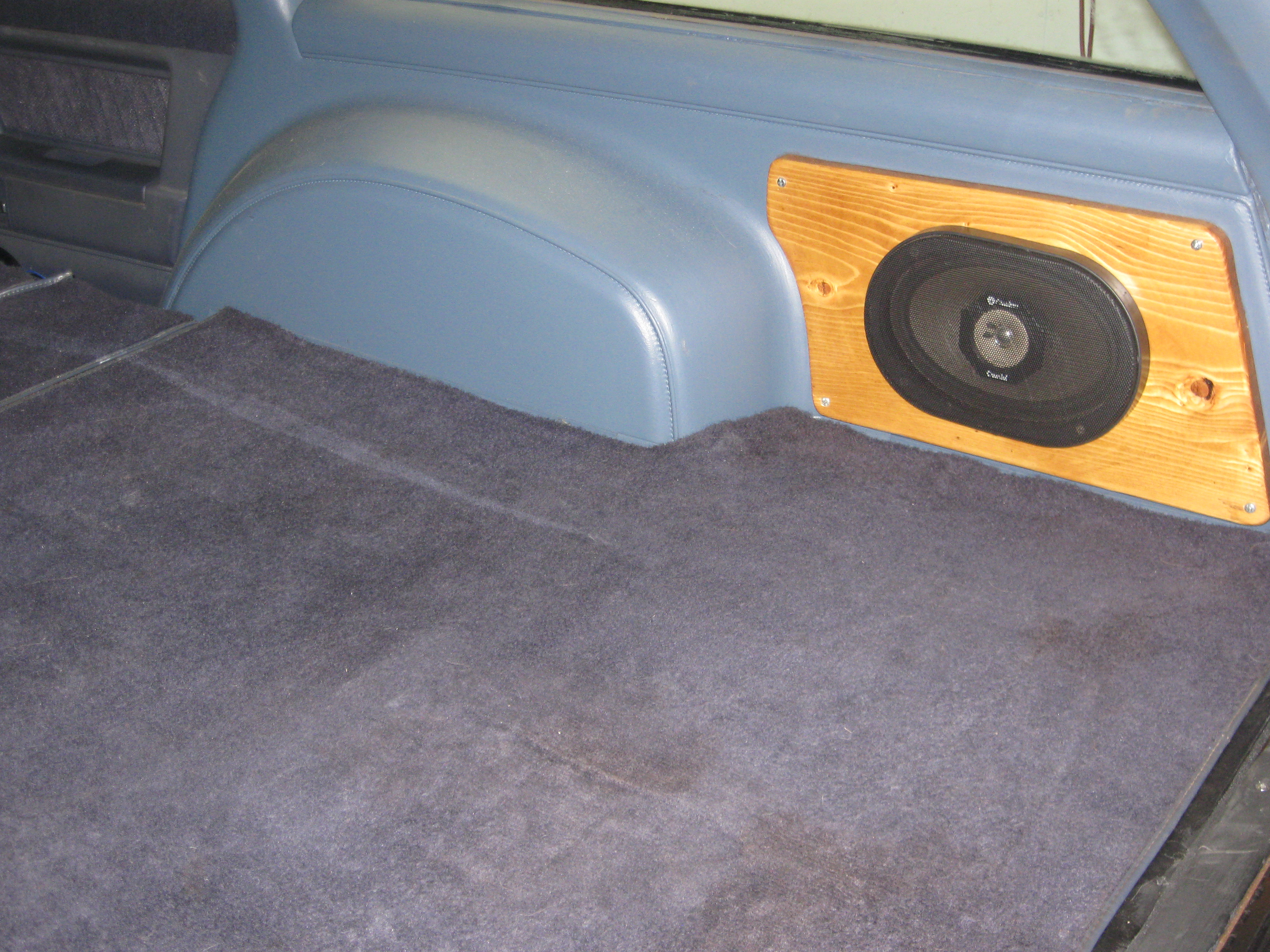

My stock panels have dry rot issues, the best replacements I found have factory speakers plus I want it to appear factory and have the optional locking security doors to add to the cubbies. All part of the plan. What Mark has above looks great, just doesn't fit my goals/vision.
I might be willing to be the guinea pig although that price gives me pause for concern. Rather not resort to a BFH to the wheelwell to fit something 😀.
Yeah, those shallow profile speakers from Crutchfield look great, but the price is definitely an eye opener. 😳
I do like that you intend to keep the cubbies intact with the locking doors. I always thought they were a cool feature...although optional.
