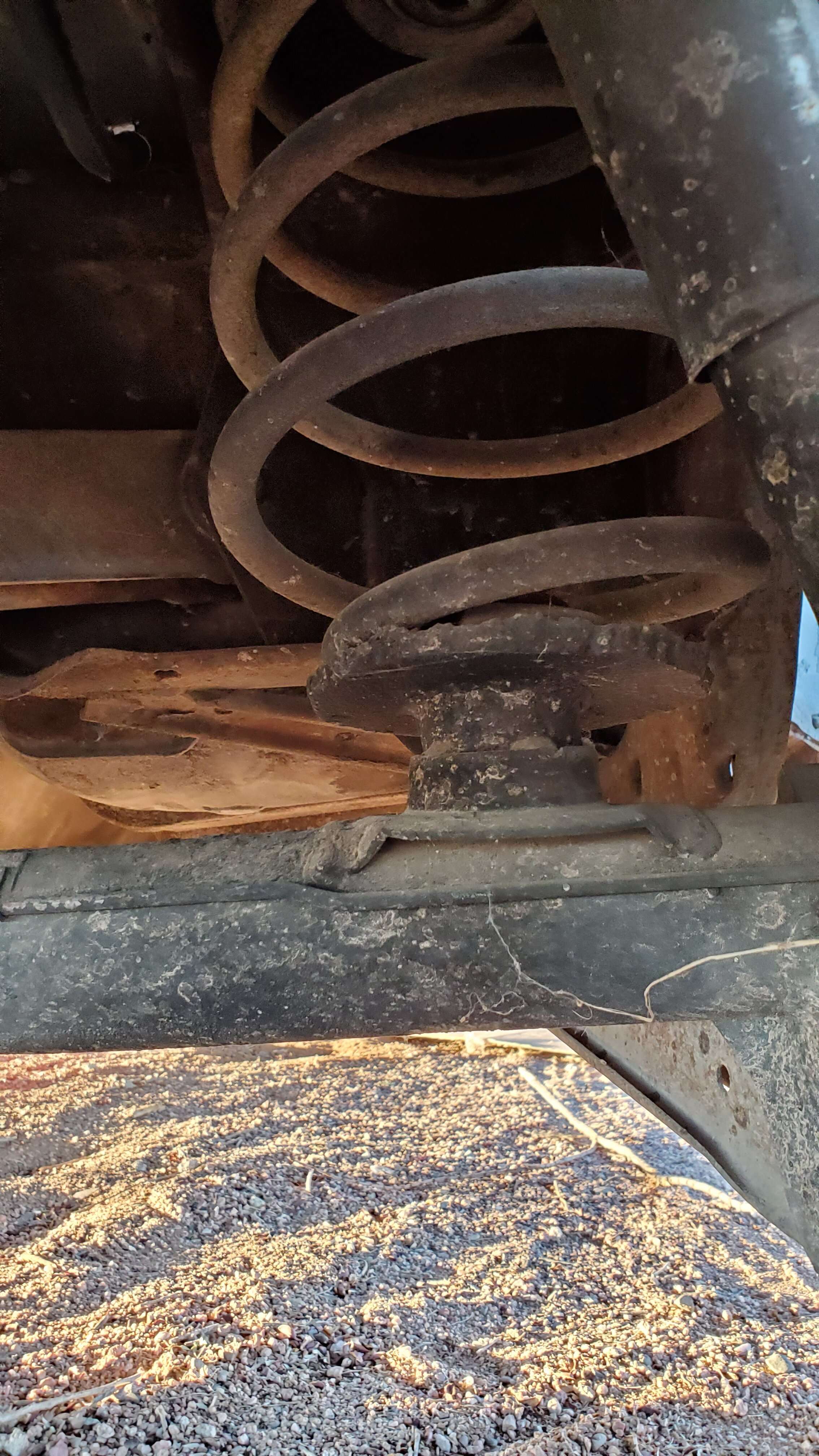

This is what the current springs look like,

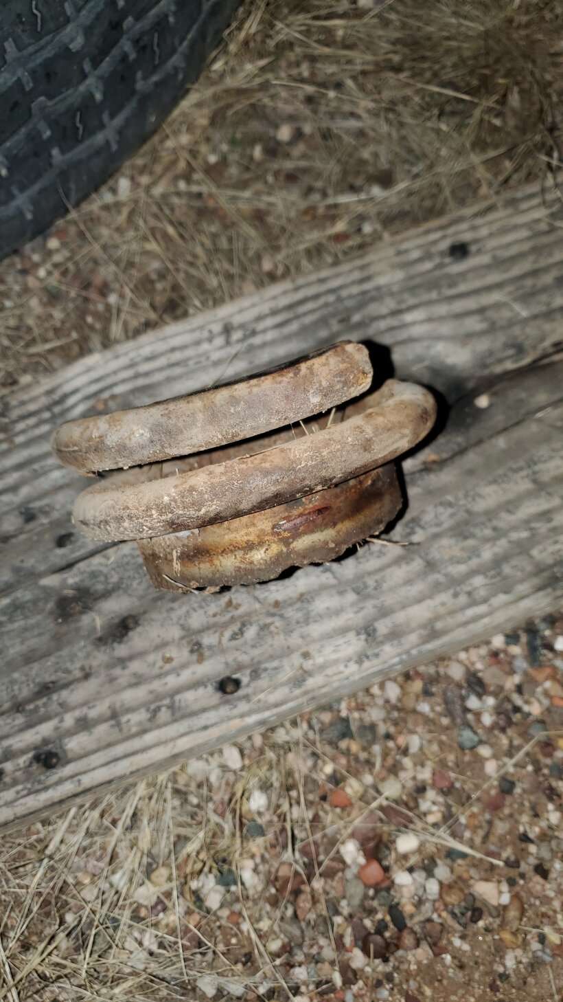

They had these terrifying homemade spacers above the springs,
  • Wow
Reactions: ELCAM
Wow, that's f'ugly!
Reactions: ELCAM
Sounds like someone was going for that Bosuzuki...Buzzoz.....fugg it. BOZO car look. (Azz clowns)
Lol, the hackery is real. Most of my work on the car so far has been to make it actually safe to drive.
