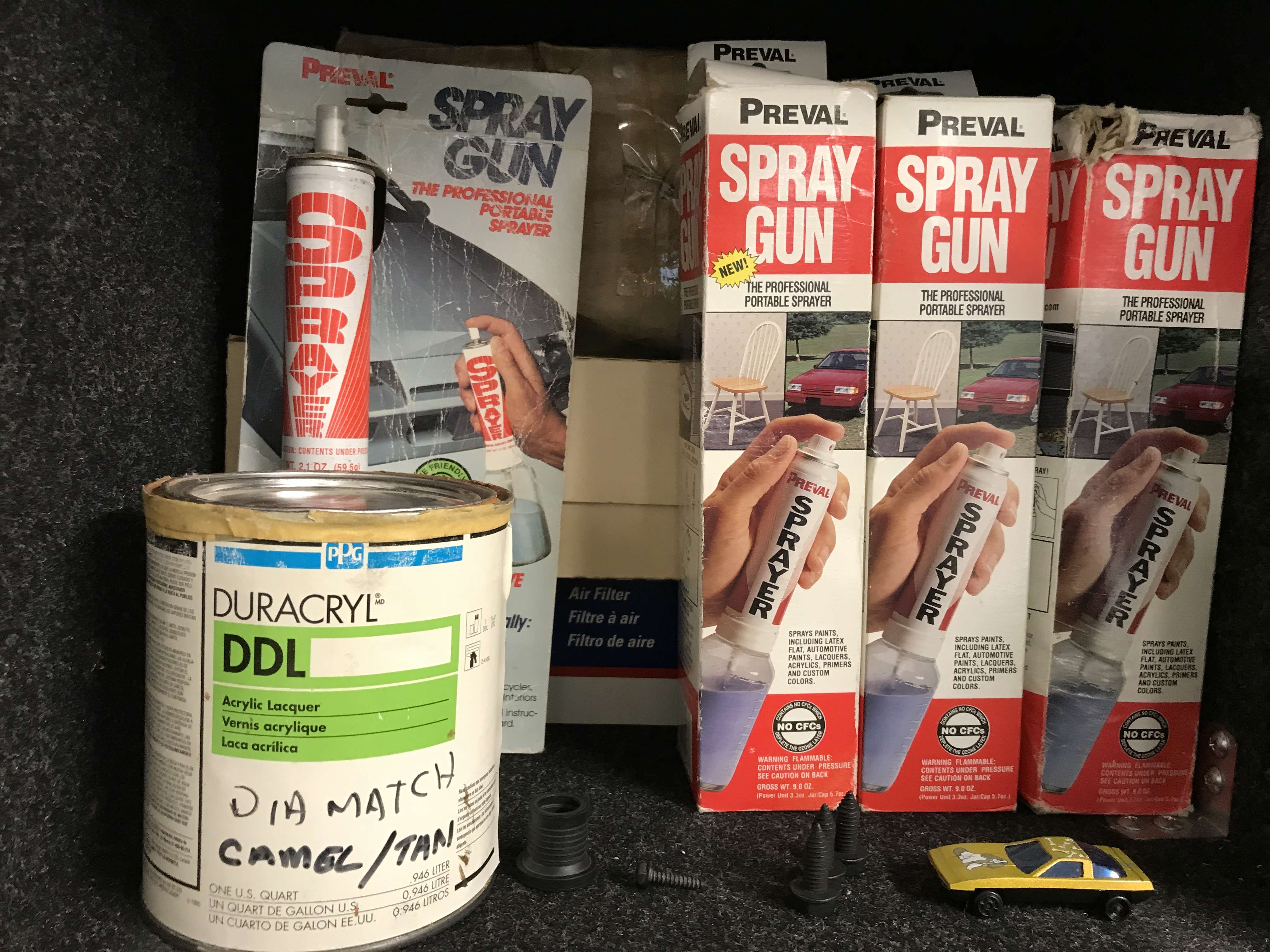

Here's what yo need to make life easier, the color codes. In my PPG book list it as darl claret, GM just called it claret. The GM code is 79. PPG codes which can be used for cross referencing is 50994 for semi gloss & 50996 for low gloss (dash & other reflective prone areas). Even though '85-'88 claret looks simular but not dispite using 79 as the code for those years. Any automotive paint supplier should have access to interior colors in the brand(s) they sell. In my opinion I would suggest PPG but others here have had great experiances with SEM.
FYI, there is never a guarantees on a 100% match due to age, plastic color lots used & variance between plastic, vinyl, cloth & painted metal.
