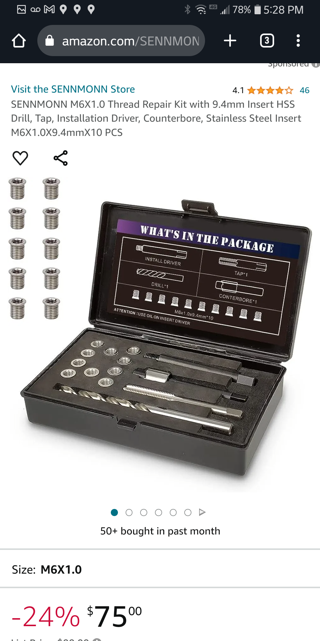

The Time Sert kit looks like it would definitely work, yet the issue might be cost.
As an example... This Amazon supplied kit is 75 USD. A simple tap and die kit and use corresponding sized studs would be much less
It's a nice kit, but as you said, it's bit pricy for one simple repair. For less money you can probably find a decent replacement mirror.
