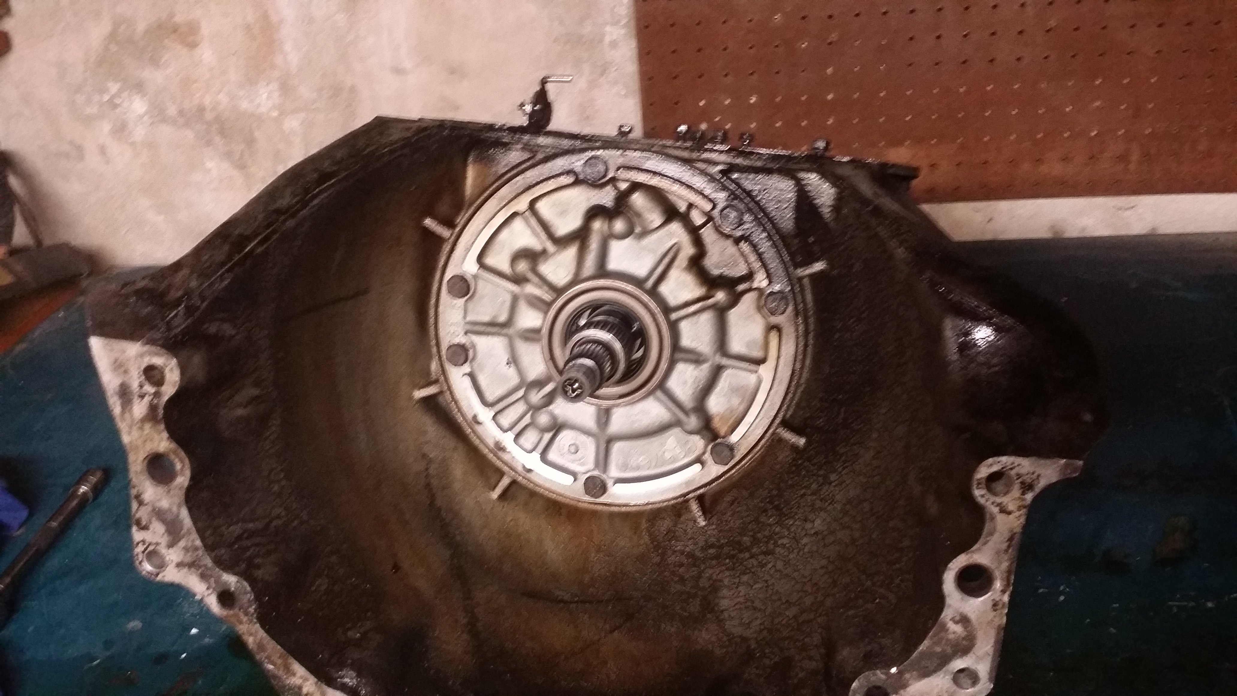

Next: Pump removal. I know of a few tricks to remove the pump but im not sure witch one will work.
Reactions: V8 Rumble
The two methods I can think of to remove the pump is, one, the designated puller, and two, using a large screw driver and be careful not to damage the surfaces. I was able to remove the pump using method two

Today managed to pull the front pimp off. Anyone recognize this tool lol. I used what i had. It worked for me too.
