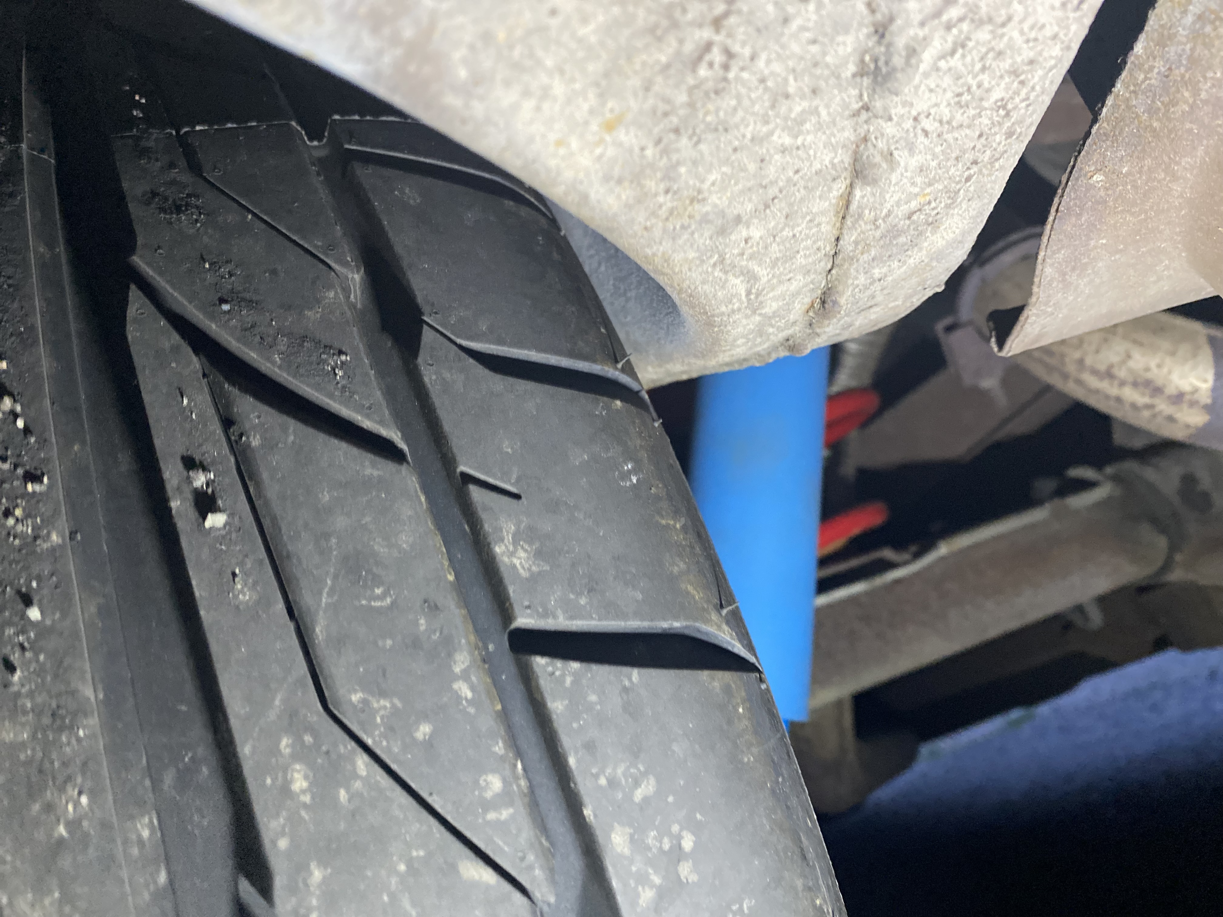

My cutlass has 17x8 with 4” backspace with 275 50 17 on rear lowered 1 1/2”
All stock brakes and diff housing
I had to trim fender lips and there is about 3/8” to frame on backside of tire

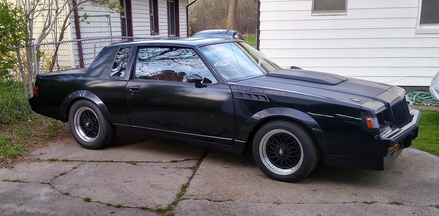

When I first bought my Regal I put some ARE 15 x 8 rims on with Cooper 235/60 fronts and 275/60 rears, I liked how those sizes looked on there so when I installed my 17 x 8.5 rims I went with Nittos 235/50 front and 275/50 rear to match the height and width of my 15" rims.
I have always liked bigger rear tires on my Gbody's.
What series are those on the brown car? They remind a lot of the factory 87/88 Oldsmobile aluminum 14" rims. The ones online look more like factory Buick/TA rims.
You quoted the answer: ARE 15 x 8 rims with Cooper 235/60 fronts and 275/60 rears,
I assume you already know but the brown car is the black car
Reactions: olds307 and 403

Is there room for more positive backspace? You can run the outside to fender pretty close. It shouldn't really move closer unless there is aggressive driving but inside to frame will get closer as soon as the axle articulates.
There is no room to go in or out , I am very close to frame at rear of tire
