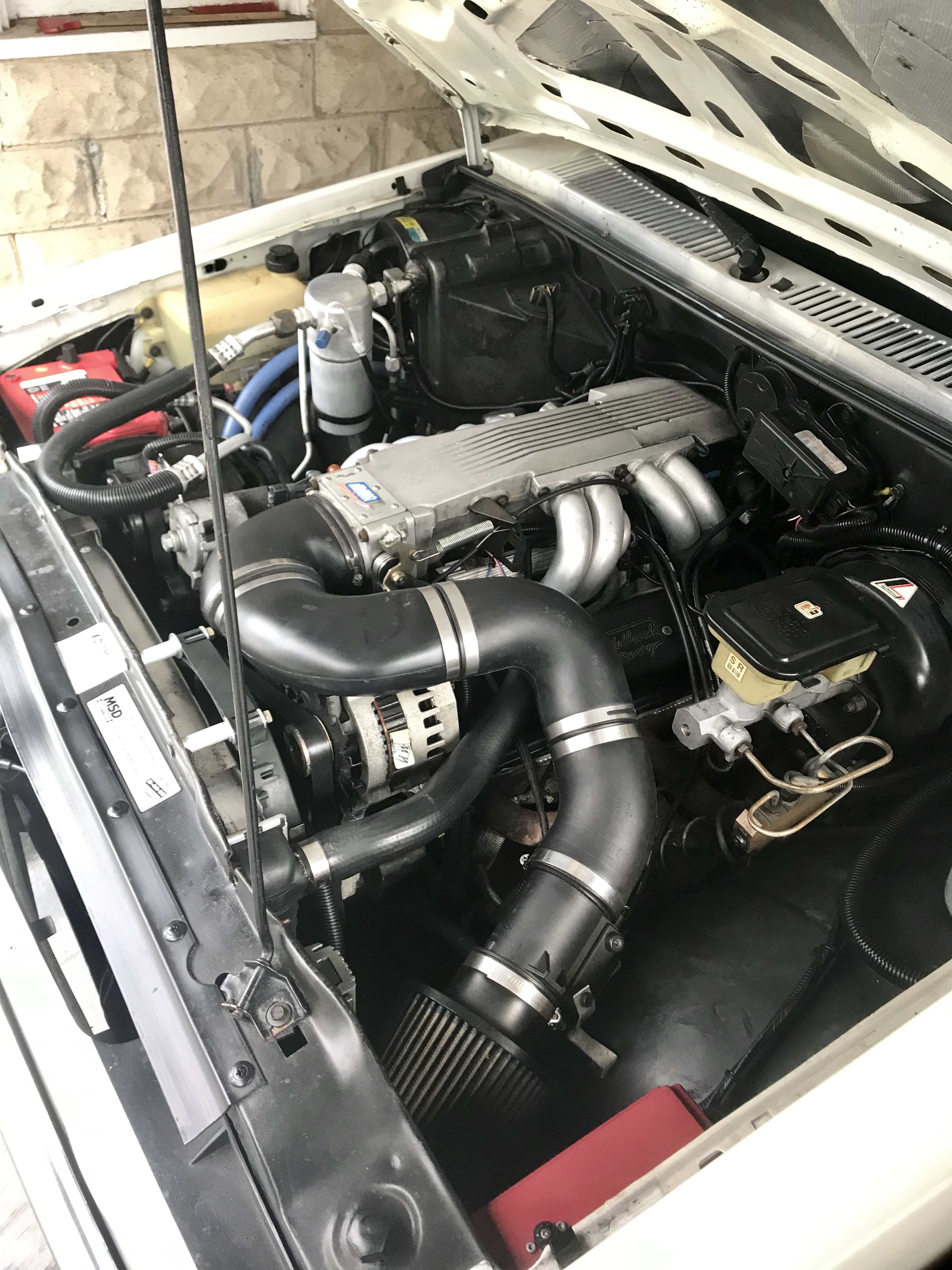

I run it in my 88 s15 Jimmy 350. Engine runs great and good low end torque. Ive owned the truck for 22 years and this setup has been in there since 2002.
