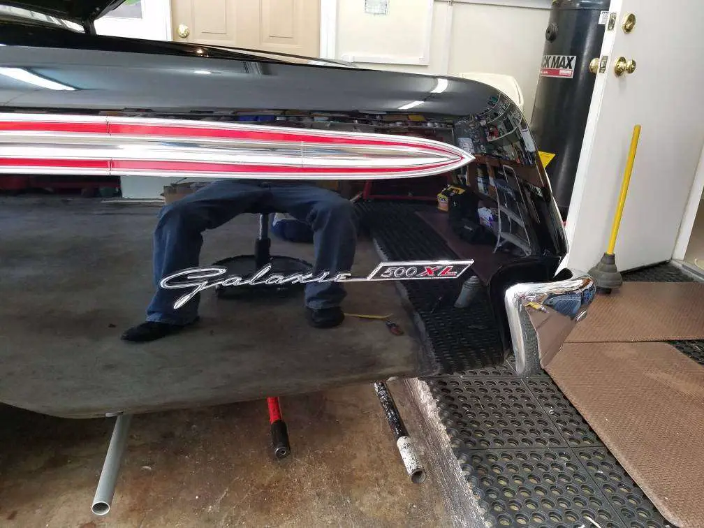

Dad's Galaxie was painted with Centauri in 2020. Gloss Black.

Where's the rest of that car? That is like a chick with huge b**bs wearing a sweater. 1 of my favorite cars ever, 65 Galaxie 500 coupe. My favorite Ford for sure.

yeah his dad's ford is sweet.there's a build thread on it. https://gbodyforum.com/threads/dads-62-ford-galaxie.61338/
