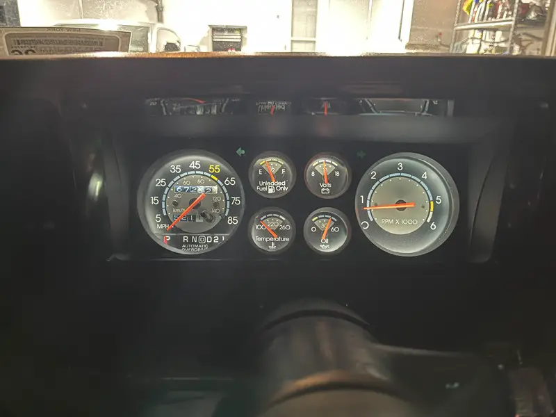

Well I replaced one light bulb socket, and used contact cleaner and an eraser to clean the rest of the printed circuit board and bulb sockets. After a test fit the Tachometer, Speedometer and rest of gauges are working with the LS. The speedo is definitely off by at least 20% or more (reads too fast compared to GPS) so I will have to switch the speedometer gear in the tail shaft of the trans.
The gear selector cable now seems too short, anyone know how this cable is supposed to be routed over the steering column?
New LEDs with bezel back painted white:
Gear selector cable:
