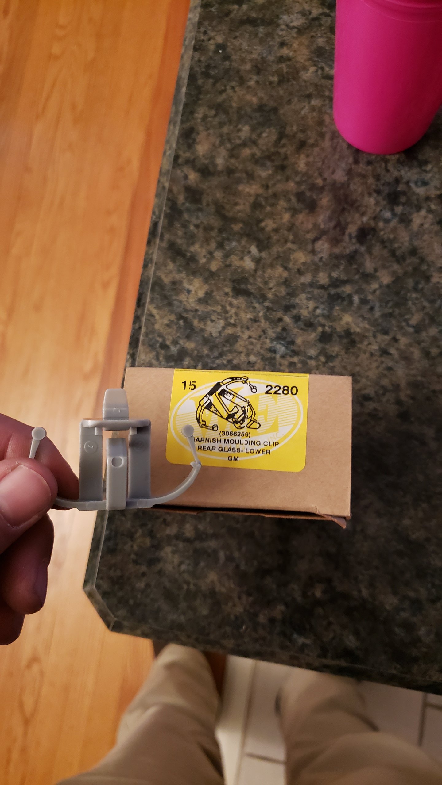

Looks really good. How in the hell did you shatter the window removing the top? My top came off easy and only small gaps to fill so I did and left the vinyl top windows in. Sucks that new seals aren't available, the majority of cars have vinyl tops from what have seen up here.Alright, here is the quick and dirty. To switch to a hardtop you'll need hardtop quarter windows. I learned the hard way when I shattered one of the vinyl top windows on mine during teardown. You'll also need the rear window trim which is 5 pieces, along with the screw studs 565 linked already. Then the trunk filler panel rivets need to be ground down, and you'll need 8 of the clips in the pic below.

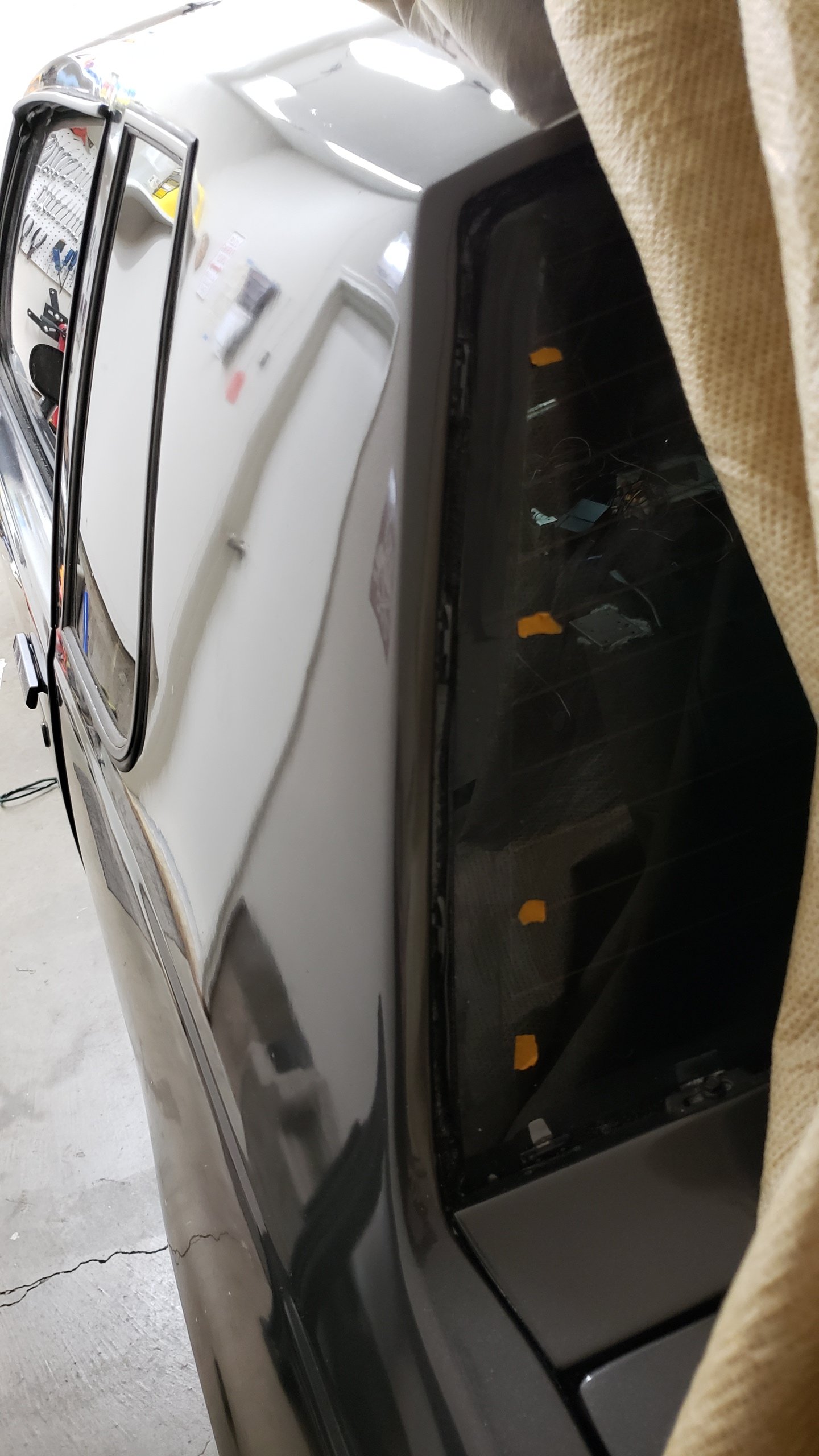

I had to do a whole roof skin swap due to rust on the rear roof area. My car was originally a hardtop so it already had the trim under the vinyl. We cut the old roof at the lead joint, melted it out, then grafted the skin from a donor 87 onto the structure. Here are a few pics I just snapped. Let me know if you need more. View attachment 127825 View attachment 127826 View attachment 127827 View attachment 127828 View attachment 127829
I shattered one of the quarter windows trying to remove it. I thought all 5 nuts were off, but missed one...start pulling and prying to break the butyl free and bam!Looks really good. How in the hell did you shatter the window removing the top? My top came off easy and only small gaps to fill so I did and left the vinyl top windows in. Sucks that new seals aren't available, the majority of cars have vinyl tops from what have seen up here.
Also, whoever did the vinyl top install swapped the hardtop windows for the vinyl so it was a blessing in disguise. The car I got thr hardtop windows from also donated the roof skin.Looks really good. How in the hell did you shatter the window removing the top? My top came off easy and only small gaps to fill so I did and left the vinyl top windows in. Sucks that new seals aren't available, the majority of cars have vinyl tops from what have seen up here.

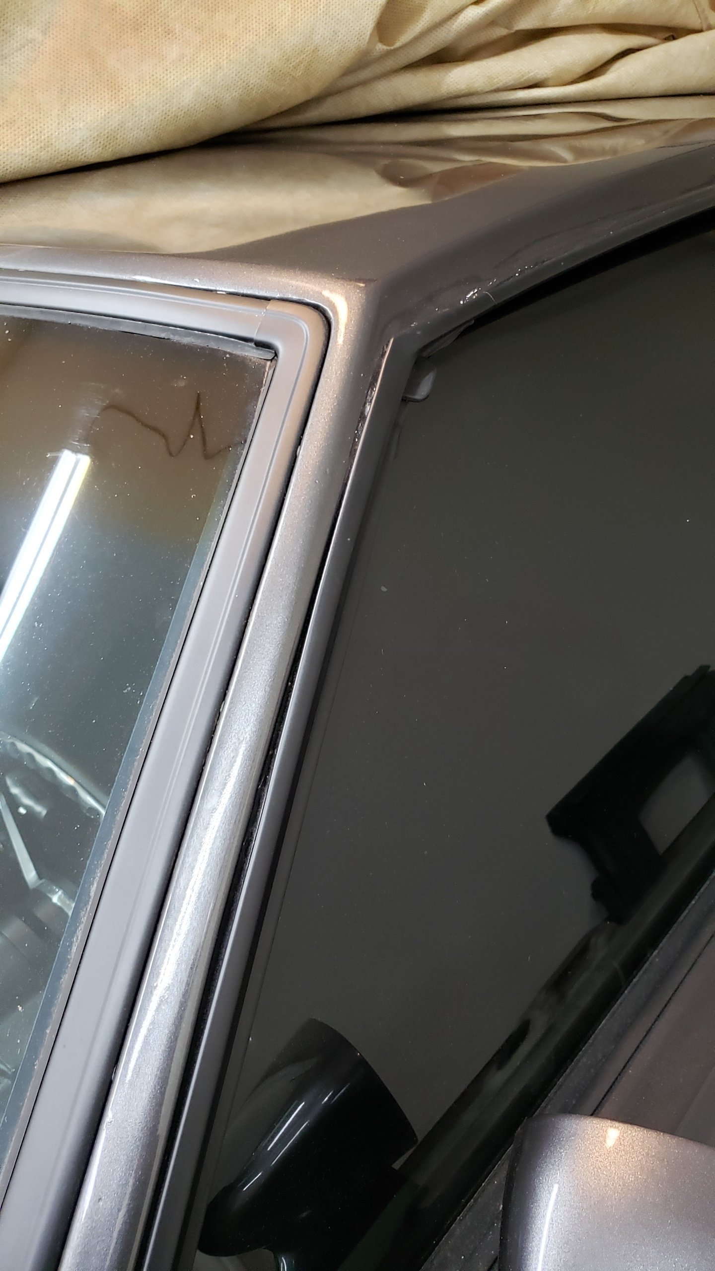

The way the outer seal sits on the window is different. Once you pull the vinyl look at the seals vs a hardtop window.Ok so this might be a stupid question but why aren’t the 1/4 windows compatible? From vinyl to HT? That I need them, I need them sure, I don’t mind that, but I’m just trying to understand what’s up with the window differences.
Its like 1/4 inch on the window surrounds. If your window holes in the 1/4 panel are tight you might not need the HT windows. A guy could build up the metal and smooth it nice to avoid it.The way the outer seal sits on the window is different. Once you pull the vinyl look at the seals vs a hardtop window.
