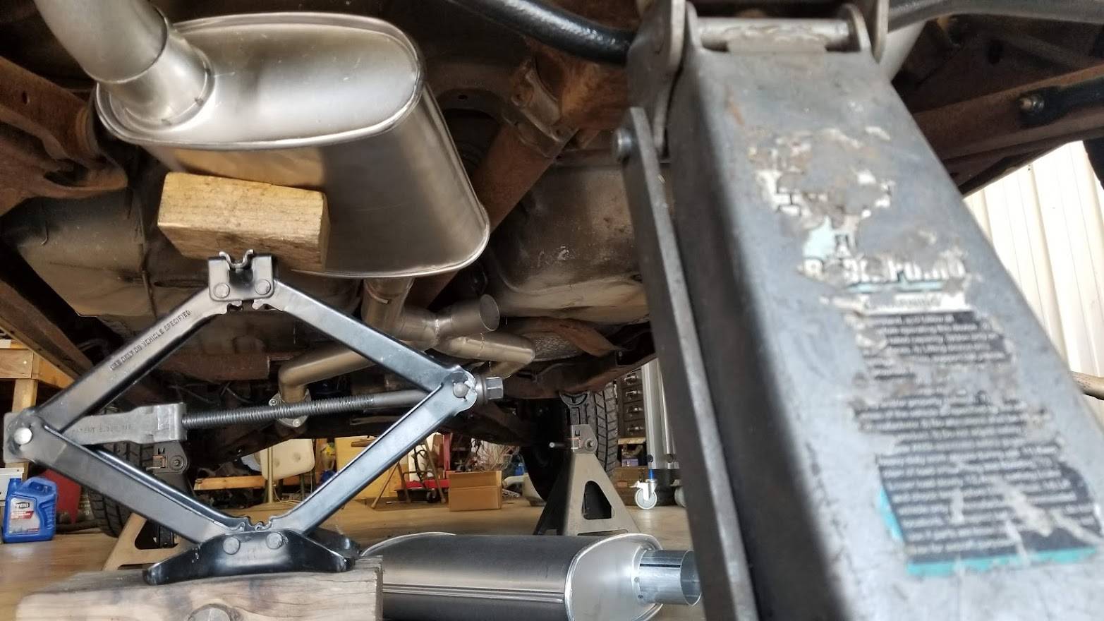

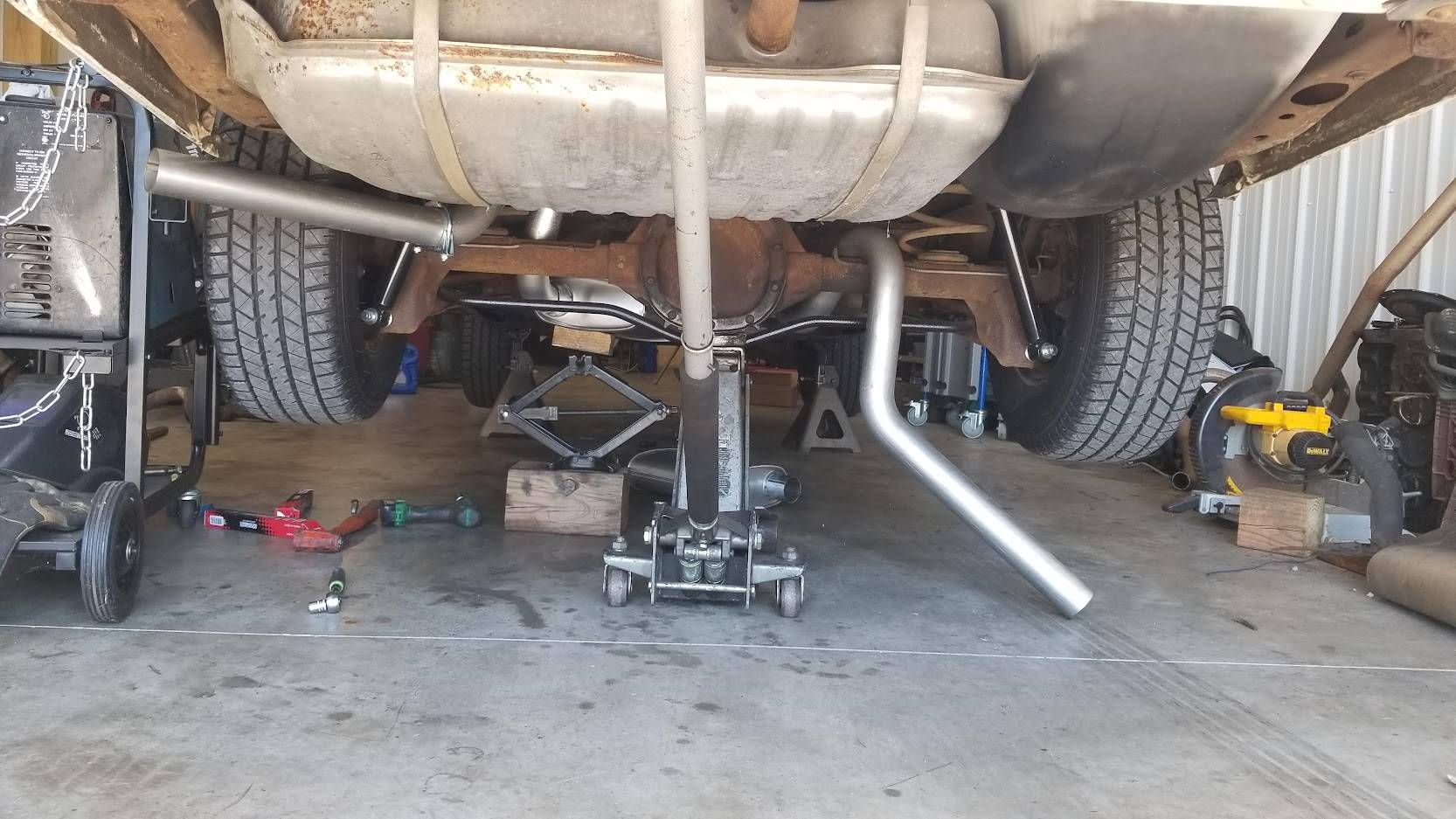

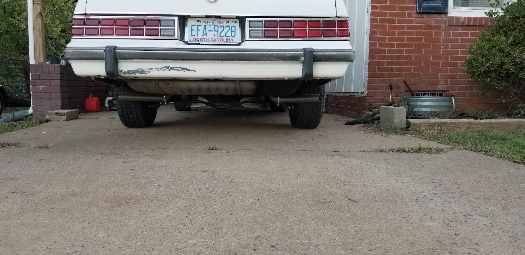

OK Im back, Had some crap to take care of . Got the exhaust done.
View attachment 188129View attachment 188130
Tucks up nice and tight.

A few pages pack...where did you find the mandrel-bent behind-the-wheel exhaust pipes?
