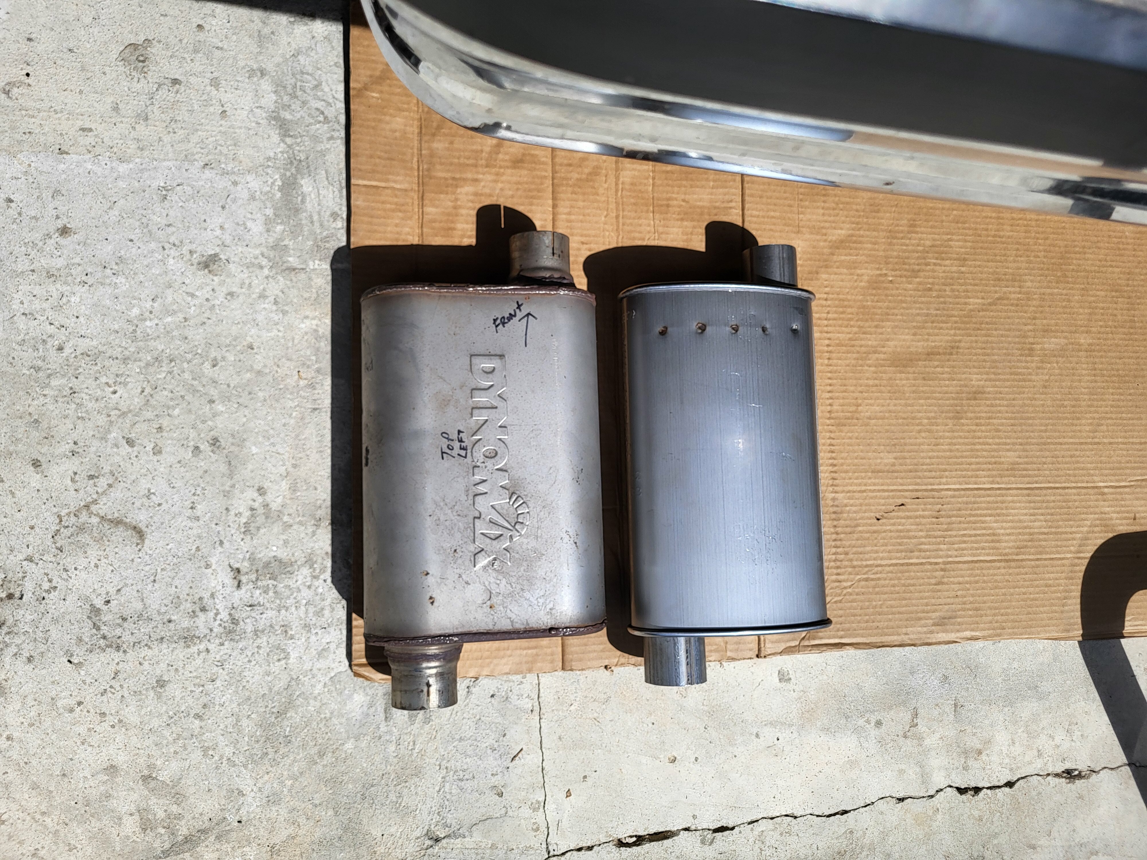

I ended up swapping my Dynomax Ultraflows for Walker Quiet Flows. It's amazing the difference. Still has a rumble at idle but is quiet inside and no droning. I need more seat time, but the 20 minutes I spent driving it today really left me impressed.
First is the Dynomax Ultra Flows
Second is the recently installed Walker Quiet Flows.

The Super Turbo's probably would have been adequate. I currently have them on my 70S, even the short version have almost stock noise levels. Did you notice any power loss vs the straight through mufflers?

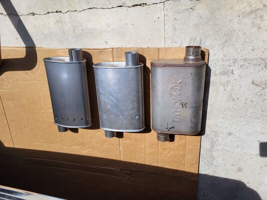

I have had the Super Turbos and they are still louder. I still have a pair of the Super Turbos. I can best describe them as being between the Ultraflows and the Quiet Flows. The Super Turbos still drone at cruising speeds. Here is a pic of all 3 together. If there is a power loss it mostly is not a lot.
