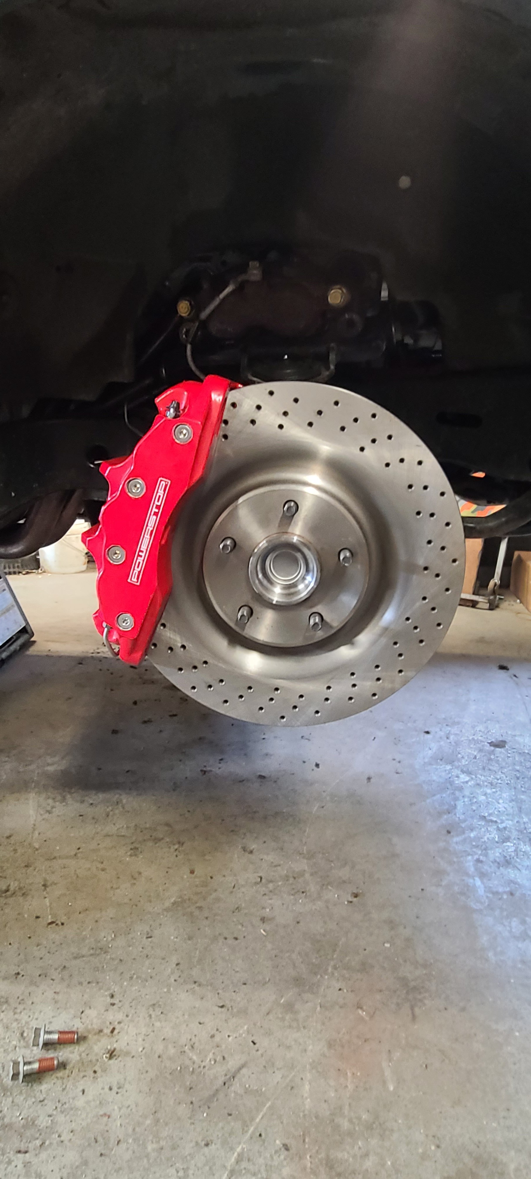

When I put the C6 ZO6 6 piston calipers on mine I ended up going with the Blazer spindles, to each their own

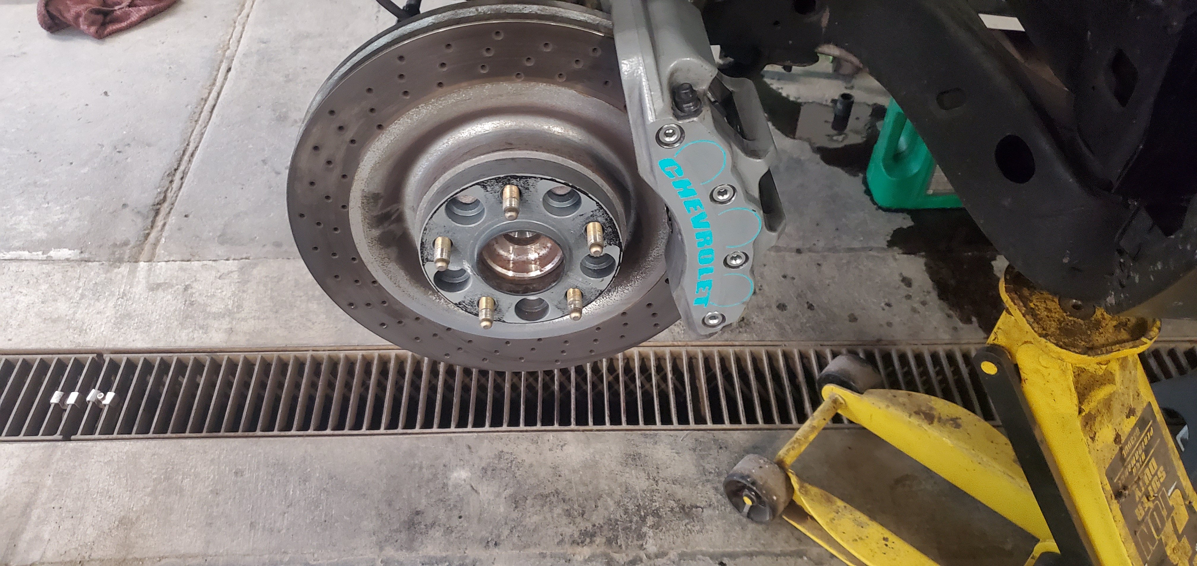

Personally I’m running stock moded spindles. With cut hubs and brackets from Big Brake Upgrade.
Daily drove the car 60miles a day for over a year with no issues. Currently in the process of switching to Wilwood hubs because I want to run 5x4.5 bolt pattern.
Blazer spindle is a nice option, I've ran them with the stock blazer brakes on two other Gs and loved then.

Blazer spindles with C6 Z06 calipers with 14" rotors here as well. Simple process. I saw the CPP spindles well after my swap was done. I would probably do those if I had to do it again.
