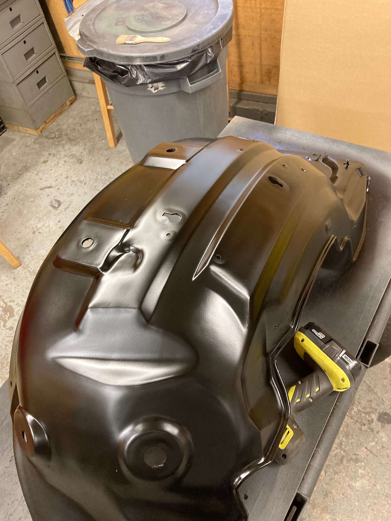

I used SEM Hot Rod black on the inners for both of my cars. Im happy with the look. I used 3M Body Schutz for the underside. Figured paint wouldnt hold up well.

How’s the 3M holding up on the underside and did you use it on both the metal and plastic ? That pic of your inners look great by the way also.
Glad you like the inners ! To be honest I havent had any road time on either car yet but Ive been using Schutz since the 80s. Not expensive, it blends well and if you crank up the pressure when you spray it it comes out pretty nice. I undercoated both of my cars with it and also a couple of my trucks when they were brand new.
That being said, if I could do it all over again I'd probably use U-pol Raptor. Nicer finish at a high PSI, hard as a rock and its tintable. Back when I used it on my Malibus Raptor wasnt an option.
