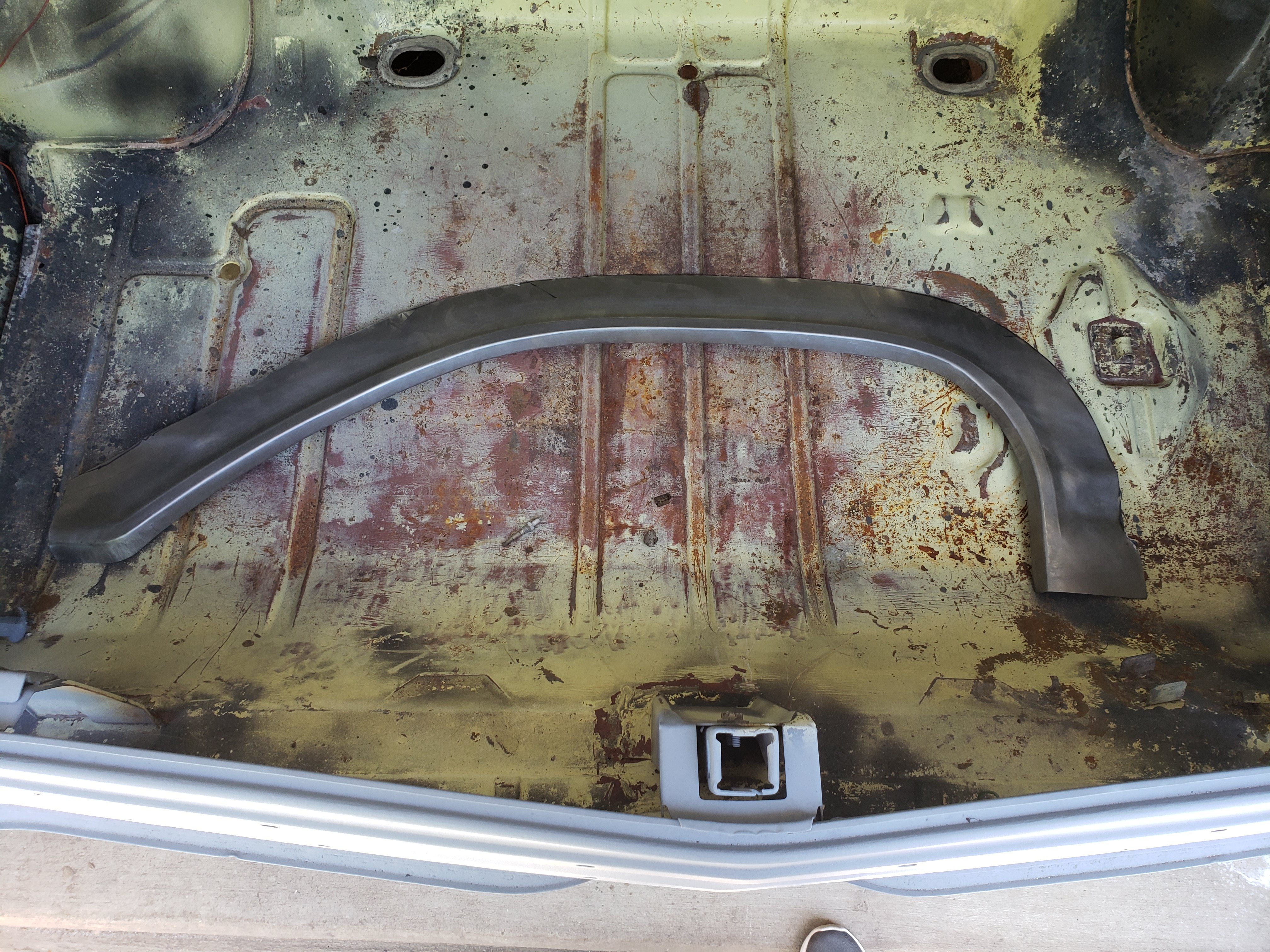

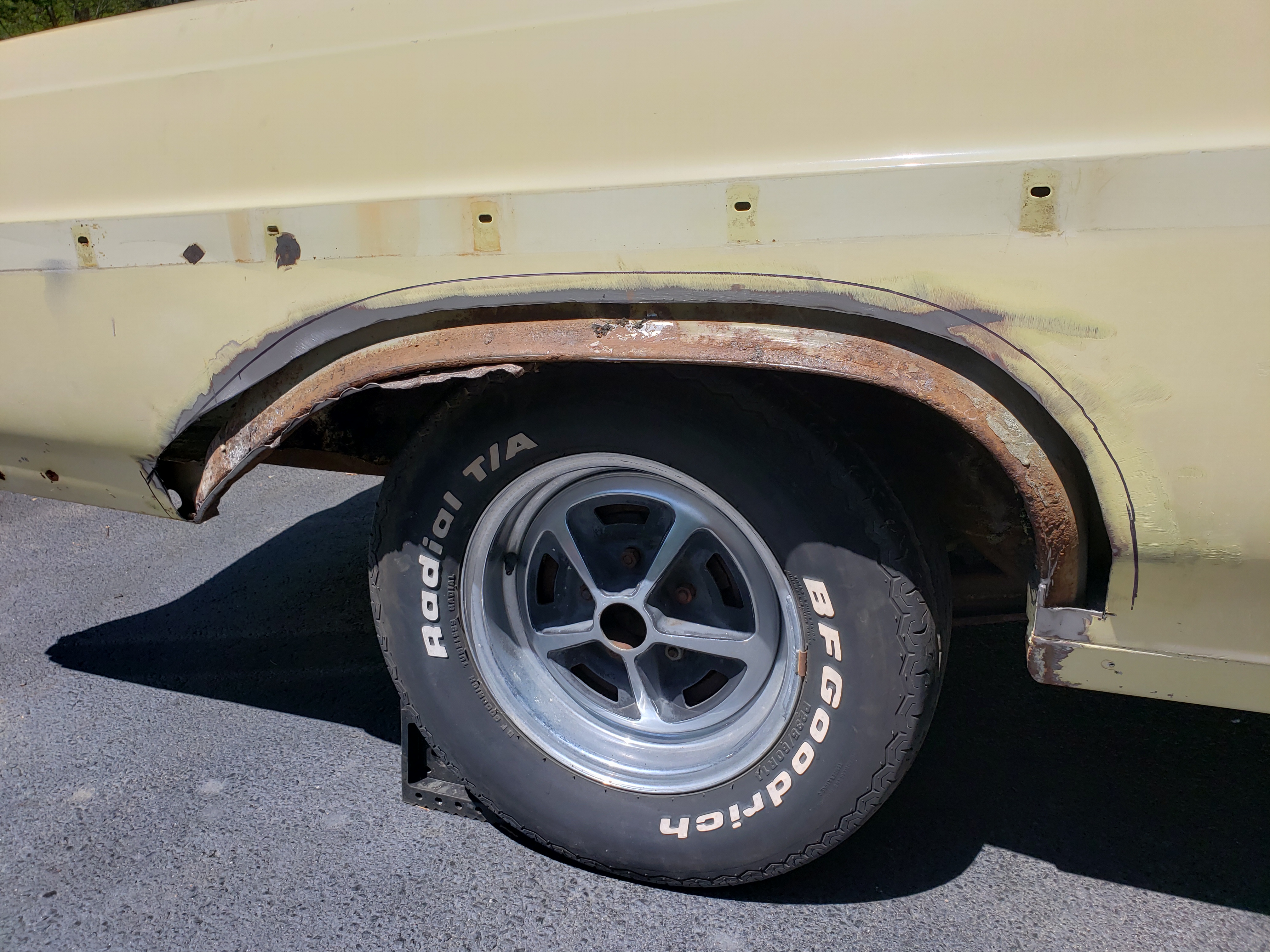

Began fitting up the arch panel today. Have it roughly cut to size. After trimming it down some, I think I should be able to make it work just fine. I'm not sure where I'm going to join the two patch panels as they overlap and the overlap area needs replaced. Just something I'll have to figure out as I go. Still not sure if I'm going to butt weld or lap it in.
View attachment 238823 View attachment 238824 View attachment 238826
Butt welding definitely takes a little more time and effort, but the end result will be much nicer and won’t create a dirt and water trap for rust to develop. I would strongly recommend it over lap welding. The longevity of the repair will last much longer as well.
Just my $0.02.
Reactions: 7 users
Also looks like you might have a little work to do to the inner wheelhouse first too. How bad is the corrosion damage to it? I can see what looks like at least a couple pinholes in the pictures.
Just my $0.02.
Butt welding is always preferred but because of this patch panel being a less than ideal fit, lapping might be the way to go. But It's kind of something I'll have to see as I go.
Stop finding more work for me! Yes there are some small pinholes, you can see them better in this picture. Nothing I'm too concerned about. Once I get it blasted I'll come up with a plan on how to handle it.
