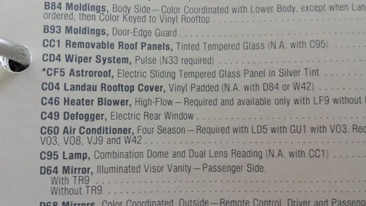

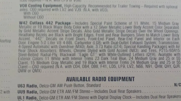

gp02a0083 said:
not sure about the H/O specifically. However I did find out from the brochures I have that you could have had a landu top on a legit 442. As 88hurstolds mentioned could have been a dealership only instillation instead of factory
Whatever brochure you're reading (which I'd like to see as well) is very likely not accurate. I've enclosed pictures of the Cutlass Salon option availability page from the official 1985 Oldsmobile ordering guide that dealers used. It specifically states that C04 was not available with W42 (and the two tone paint scheme D84 as well), and W42 was not available with C04 among other things. So both could not exist on the same car at the same time. The 84 ordering guide also says W40 not available with C04. VIN9 G-bodies came with no vinyl tops. Dealers did whatever the customer wanted, though when it come to cosmetics. I've seen aftermarket vinyl top 83 H/Os, as well as CONVERTIBLE 83 H/Os. Back in the day, a guy on the Navy base in Charleston, SC had a convertible conversion done on his T-TOP car! Paid about +1/3 of the cost of the car to get it installed. Ooof, that just didn't flow well on that car- top up or down.

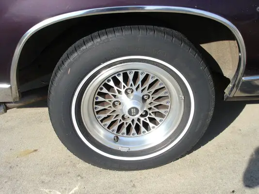

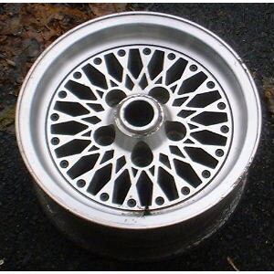

gp02a0083 my Dads 87 Cutlass Supreme Brougham had 205 tires from the factory with the chrome Super Stock wheels, he ordered the car and always order the oversized tires.
The "D" wheels Aluminum-Styled wheels with spokes, I actually really like them, my son hates them, a personal taste kind of thing. They do not look like GTA or GN rims in person, you see them more on 1988 Supreme Classics. It would be nice if they made them in 15" I agree. Found the 2 attached pictures online.
