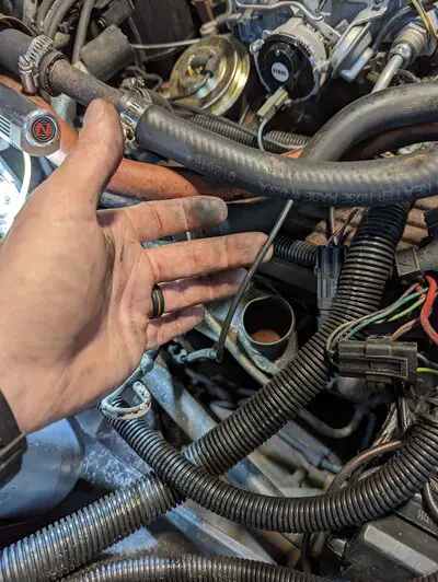

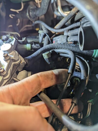

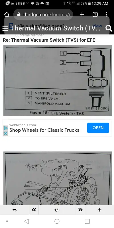

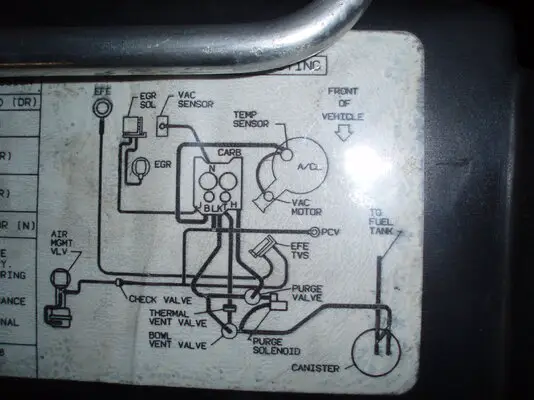

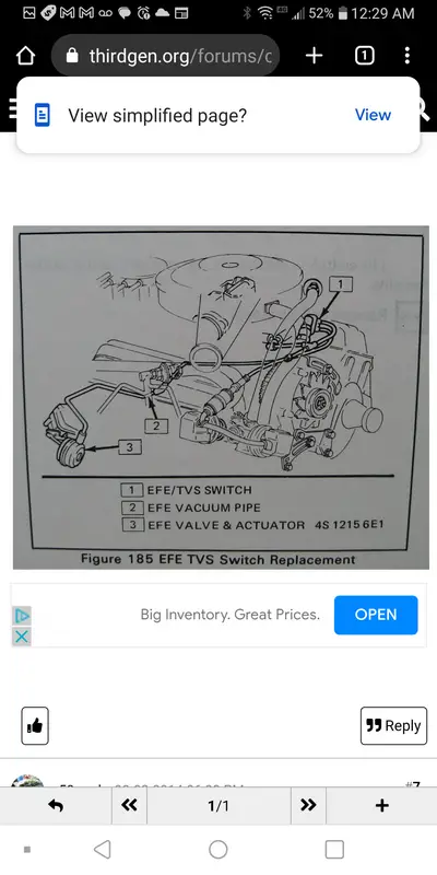

Found a broken hard line on the vac pot at passenger exhaust manifold and another on the top port of the switch mounted to the thermostat gooseneck. Am I right to connect these two or do they both connect to other spots?
Anyone have a stock 87 they can look at to tell me?
thanks!
