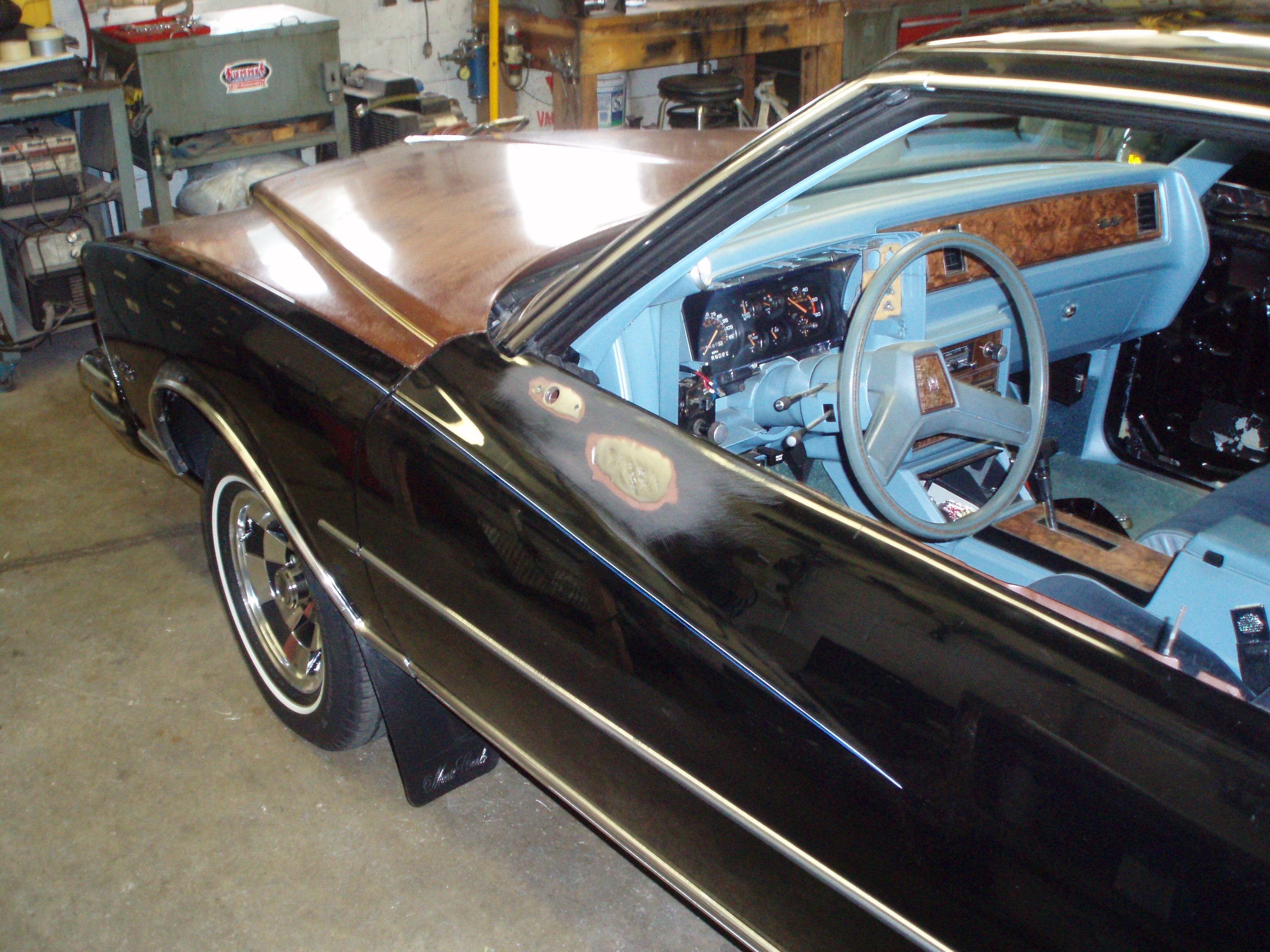

The heat only dash will still use the center vents while the outside vents will be eliminated as Blake442 stated above. I had put an 86 El Camino A/c dash using my heat only ducting into my 79 Monte Carlo. Again the heat only dash uses the center vents with block off plates where the A/C vents would route through at the ends. The glove box back pocket is specific for a/c or heat only.
Heat only dash in 79 Monte Carlo.
Swapped in 86 El Camino a/c dash converted to heat only in my first 79 Monte Carlo.
I have a black plastic block off behind the vent at the end of the dash filler panel on the passenger side as I could not locate a heat only burl wood panel.

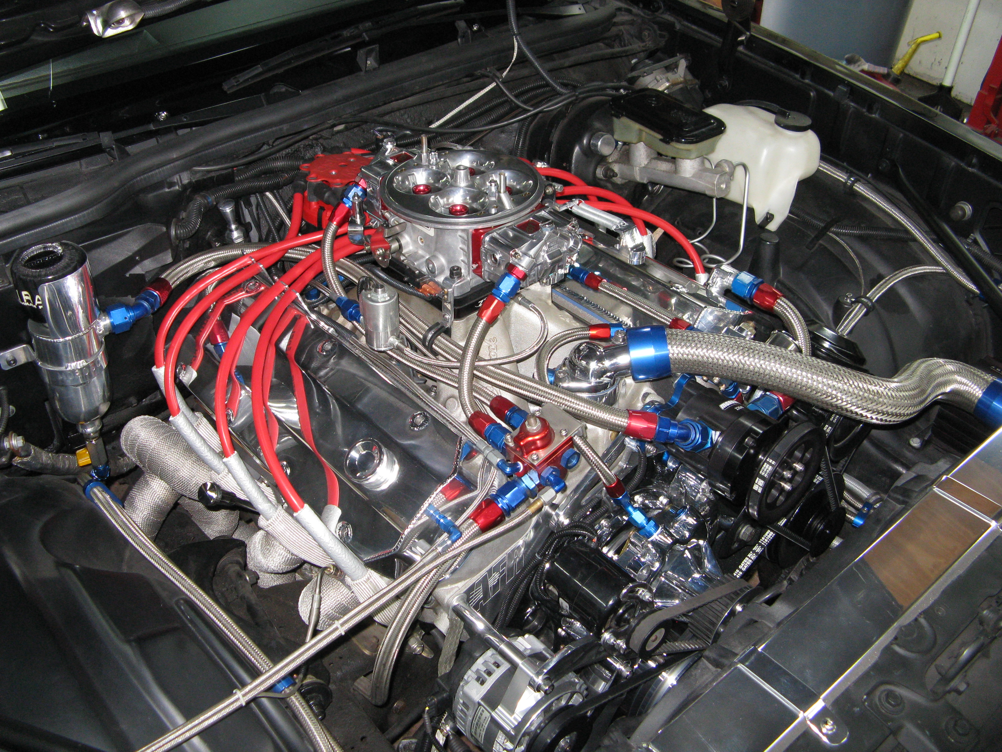

Back when I did have a functioning heat only box in my Monte I had a notch in both the main case and the fan housing to clear tall valve covers with a stud girdle. I later removed the heating aspect but kept the main case and fiberglassed the hole where the fan entered.

In the May '88 issue is where the late Marlin Davis did the write up & noted stock height valve covers clear the heater-A/C box.

When I had the fan housing on I was running Hooker 2241 headers which cleared the case, so the notch was just for the valve cover clearance.
The Lemons Headers that are on there now are much bigger and I installed those after removing the fan housing and glassing over the hole in the main case.
What issues did you encounter with the ductwork? Did you have to change all the ducting or was some of it the same? My car is sitting in storage at the body shop so I don't have access to see what mine looks like, plus the dash is still installed. I just received a complete heat only set-up so I have that ducting to look at. Thanks for your help, Rod
