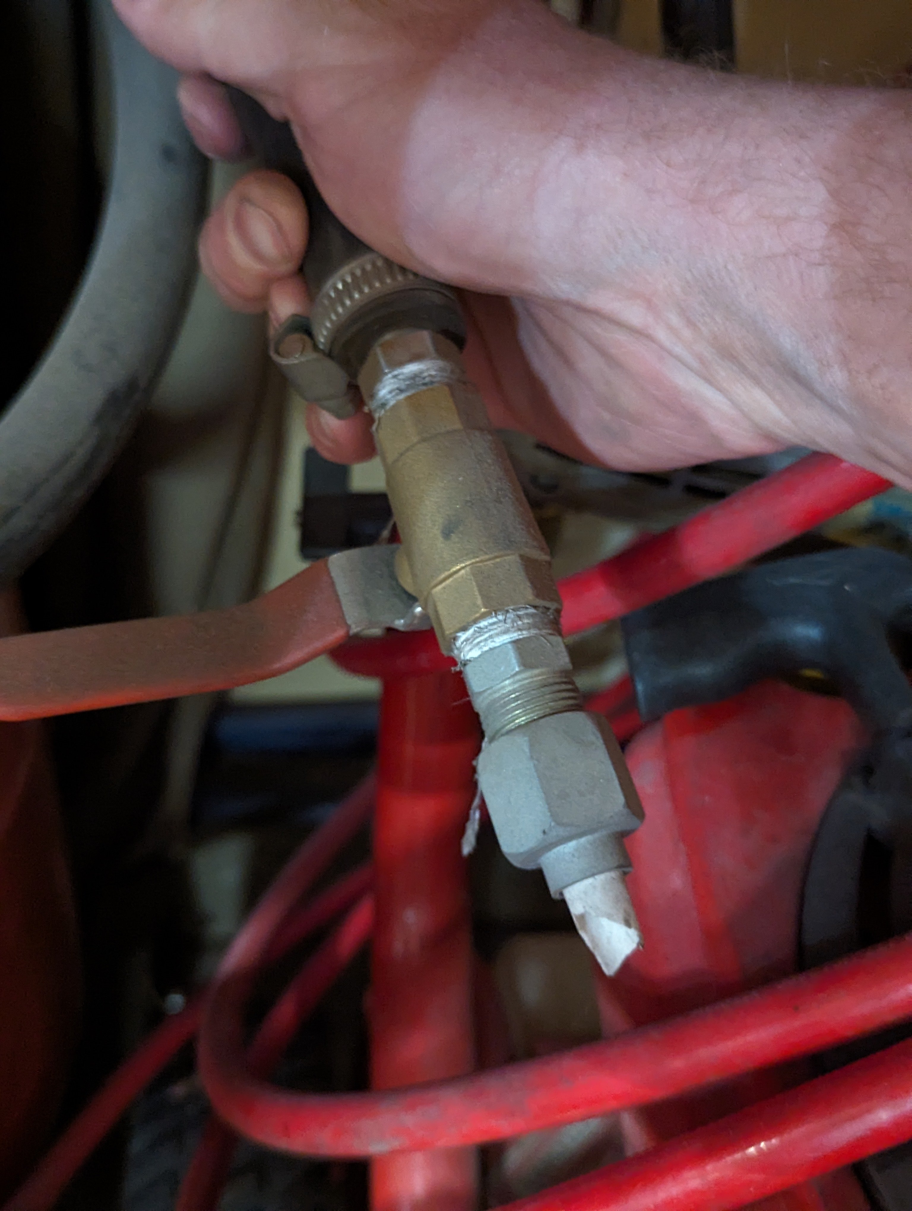

Your wand looks different than mine, can you get a better pic?
I will tomorrow. It's a dead man switch. I don't totally love it.
Sorry for taking so long with this. Here's a shot of it for you.
I added another disposable inline water filter to it as well. Blaster works really well and my compressor seems to keep up for small areas like this. I do think it could be adjusted so it doesn't go through the sand so fast, but I can't complain about the results.
