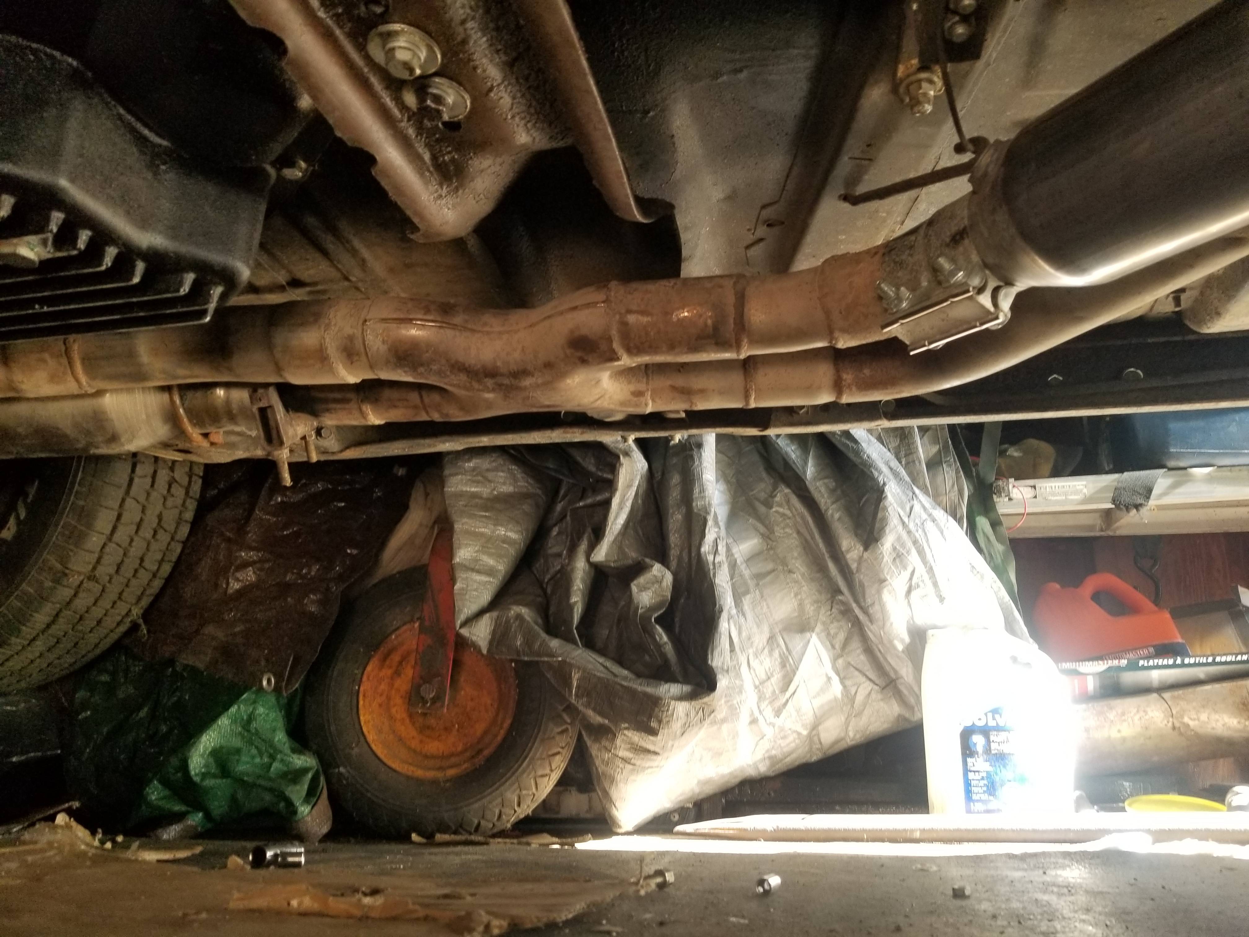

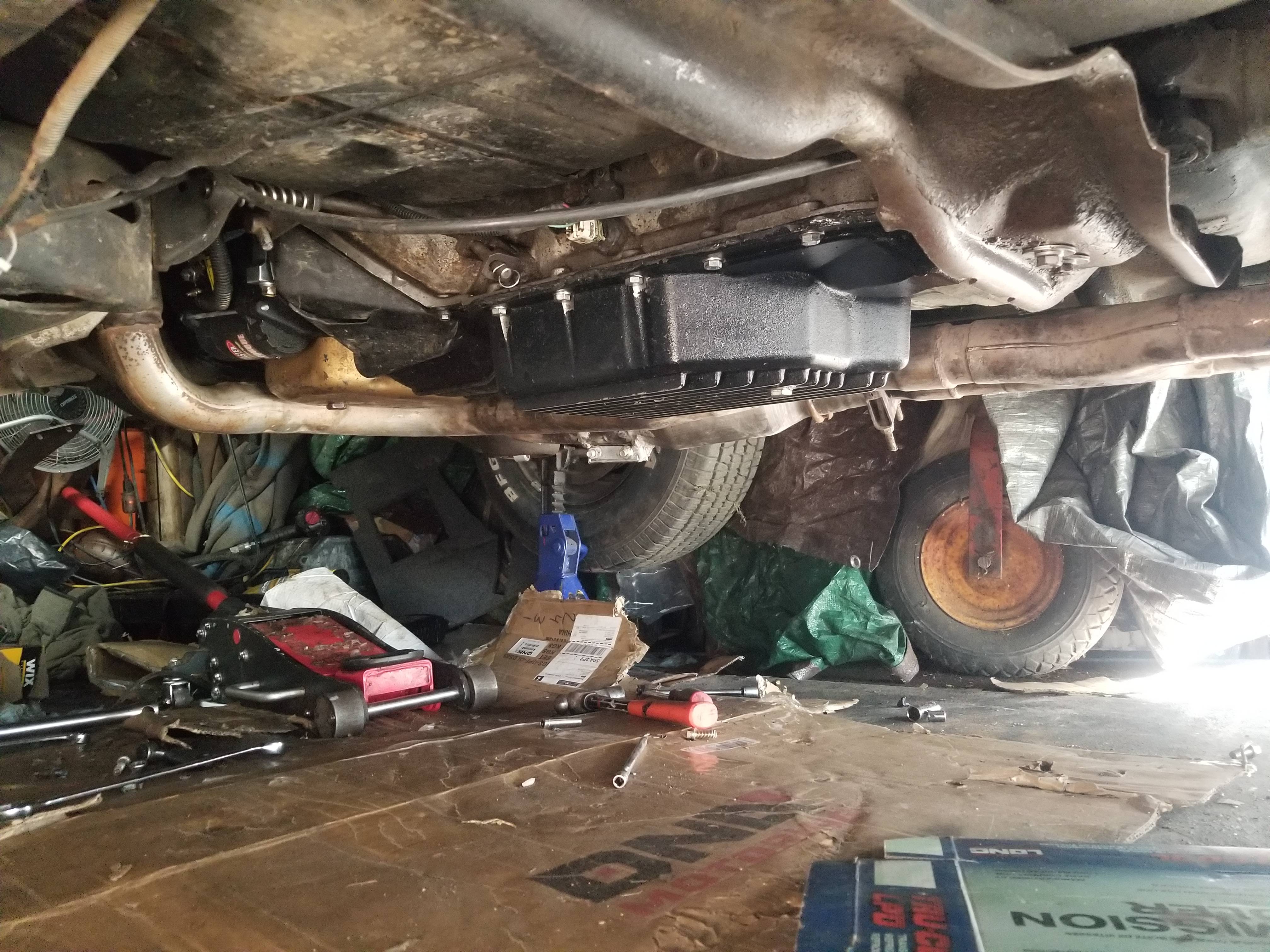

I wish I was, a G Body exculsive🤨. So last night after work, 4 hours spent on it, keep reading....I put together the exhaust and attempted to start it. Nothing, no spark and popped a fuse. I think I had the wrong terminal hooked up off the CS alternator. After unhooking and taping that off, still no spark and not flooded, pretty sure I cooked the Ignitor 3 module in that HEI. I swapped distributors and spark but not even a pop back through the carb. I swapped it 180, still nothing. I have 91 Premium in a spray bottle,maybe a couple of months old, so it should have done something. I installed the the timing chain without the heads on. The key way was in the right the position and lobes were both sideways, both lifters were down, dot to dot like I figured out was fine degreeing it. I have 25 psi cranking oil pressure, so the lifters should be pumped up. Don't know where to go from here. Everything is frustrating these days, now I know how Clutch feels. Here are the requested pics, none of the top, too tempting to set it on fire.

Listen in recent years I've found I can't even pay someone to fix anything for me and sometimes I just need to walk away. Look at the boat I'm in now. I drove a customers car home last night because I don't even have something to drive. My 78 had me so frustrated I was going to scrap them all 78, 87, Lauren's H/O the hole lot of them. The 78 still doesn't run right but I still own it lol if it was easy I'd be able to pay someone to do it. I personally think that cam companies don't make cams to correct spec for olds motors so they need to be put in with a piston stop and a degree wheel that's the first problem second is the people who truly know these motors are all dying off. Sad but harsh reality. Tonight I become a diesel mechanic because locally they suck too. What am I going to do though I need my truck or I'm walking the 20 minute drive to work on the GSP maybe someday I'll find a good mechanic that I can swap body work for until then I'll keep trying to figure it out
