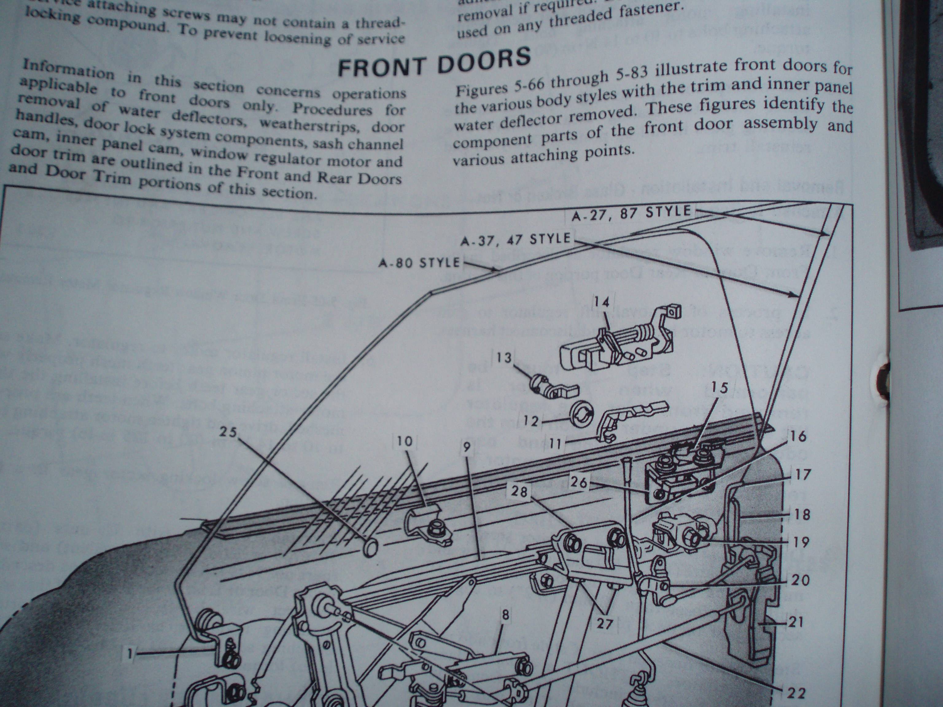

Thanks man.Malibu windows are longer than other g bodies, Lemans and Grand Am are also the same, but rarer than hens teeth.
That’s it!! Thanks a lot.This is from my 1979 manual.

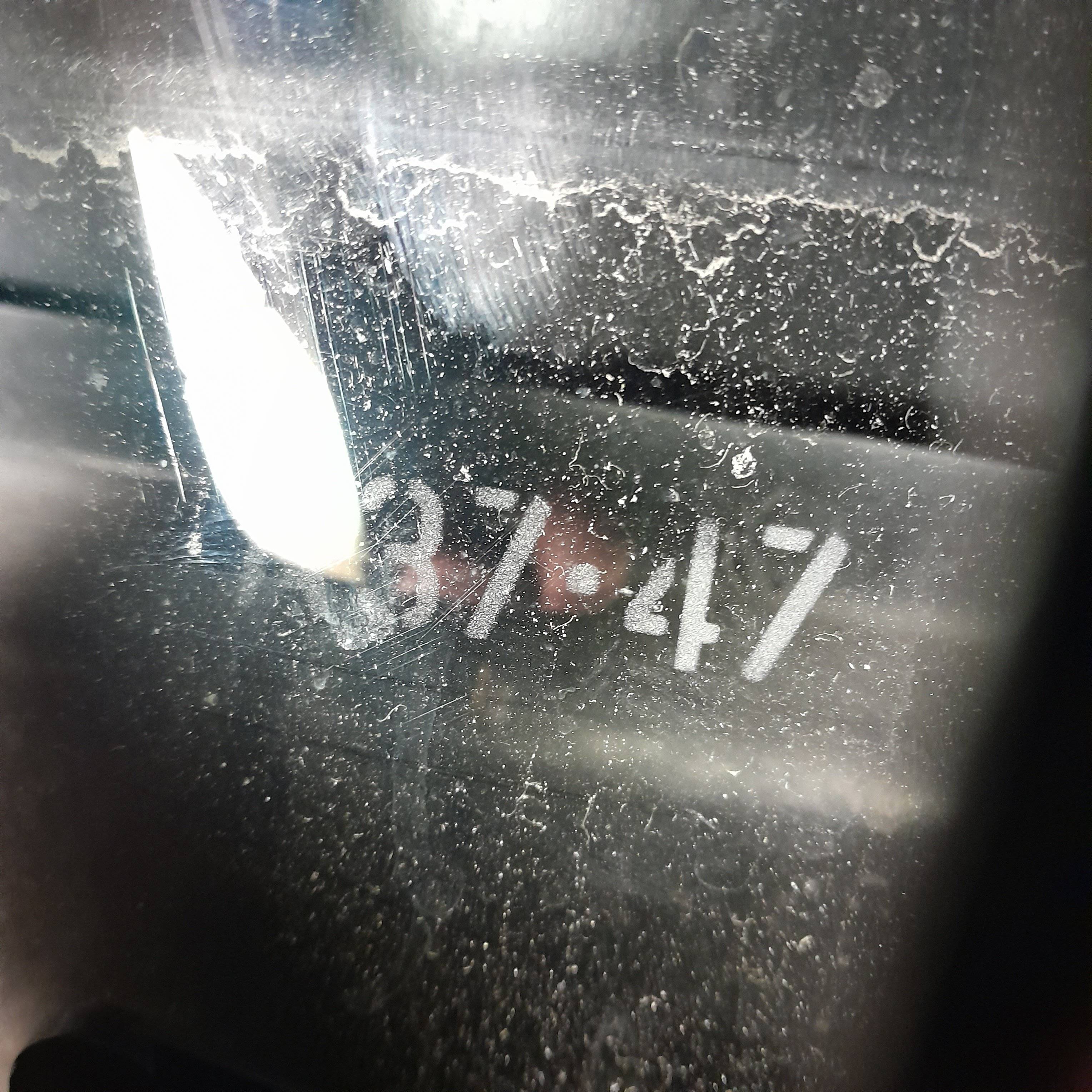

While not really clear here is the etched body style numbers you are looking for.
Great information. Totally why I need this forum!!You might of picked up 37/47 coupe windows for the "special" coupes, Monte Carlo, Grand Prix, Cutlass Supreme/Calais. Regal. You'll need windows for a 27 coupe, Malibu, LeMans, Grand Am ('78-'81). Not sure but might be able to use 87 coupe windows, Cutlass Salon, Century. Most windows sould have "27", "37/47", "87" on them below the belt line where you wouldn't see it unless the glass was out or the door panel is off.
