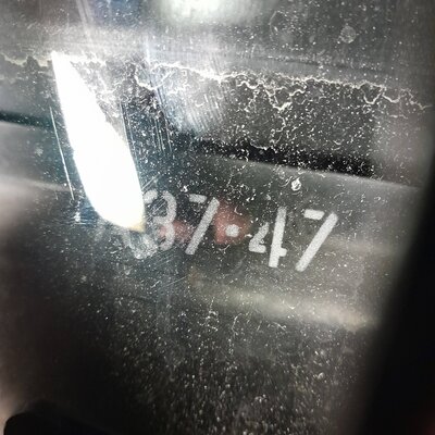

You might of picked up 37/47 coupe windows for the "special" coupes, Monte Carlo, Grand Prix, Cutlass Supreme/Calais. Regal. You'll need windows for a 27 coupe, Malibu, LeMans, Grand Am ('78-'81). Not sure but might be able to use 87 coupe windows, Cutlass Salon, Century. Most windows sould have "27", "37/47", "87" on them below the belt line where you wouldn't see it unless the glass was out or the door panel is off.

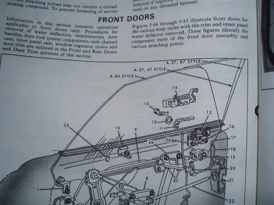

This is from my 1979 manual.
While not really clear here is the etched body style numbers you are looking for.

I never noticed there were etchings in door windows to designate window size and therefore model differences. I'm definitely going to look the next time my door panels are off.
This is one of the many reasons why This Forum is the best (and addicting). I have learned a lot since I have joined.
