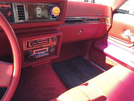

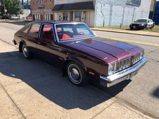

I’m installing a stereo in my 79 cutlass. The car is very clean and un molested, so anything I modify will be something that can be easily un done. I picked up a radio bezel and some kick panels, I would like to find speaker grills for the dash but if I can’t find them I will make some.
I have a lot of audio gear lying around from previous installs, so I’m going to use what I can. I know this isn’t everyone’s cup of tea, but I really enjoy music so it’s a must for me.
The plans;
JVC single din deck
Soundstream synthesis dsp
Kenwood X-802 5 channel amp
Undecided mini amp for midbass
8” dayton rs225 mid bass in the kick panels
3” dayton rs75 mid range in the dash
1-1/8” dayton rs28f tweets in pods on a pillar
10” Kicker comp vr sub
The sub may not be used, but I have the channel for it so I will Atleast wire it up. I am going to mount the amps below the dash on the passenger side. I will Fiberglass everything, cover it in vinyl and use a dye to match it to the interior the best I can. I will post pictures as I go.

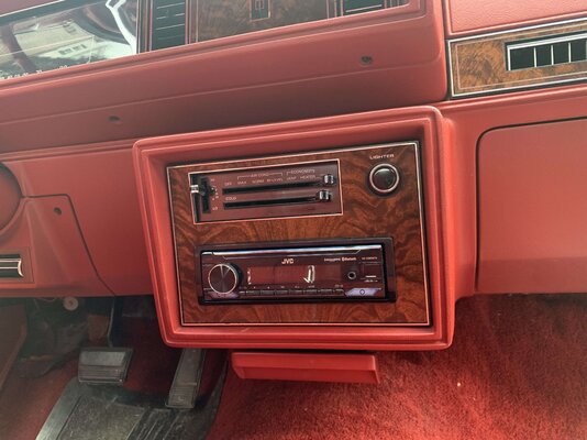

I ditched almost all of the gear I have and bought different stuff. I’ll post pictures up soon. I’m making it as bolt in as I can.

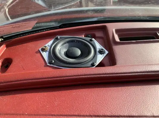

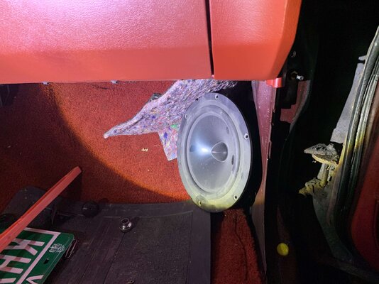

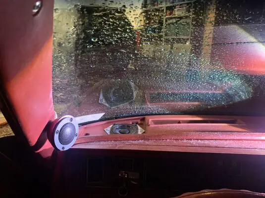

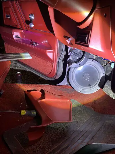

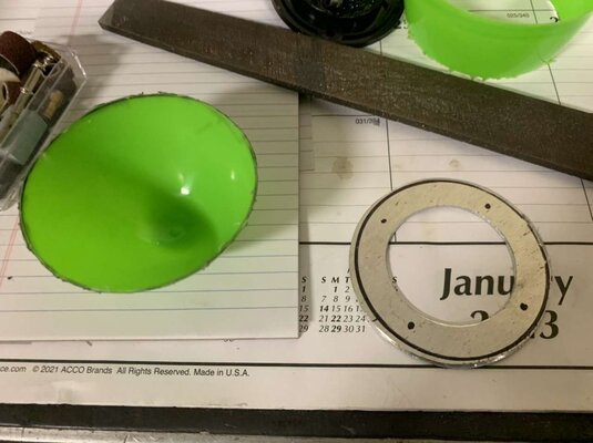

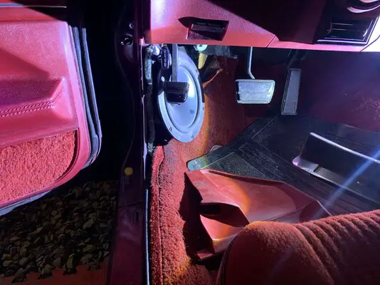

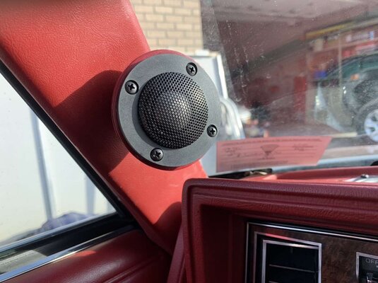

I’ve been slowly working on it, Got the kicks glassed and need to wrap them in vinyl. I wanted to use the stock speaker grills but doesn’t look like they will fit. I’ll have to make something.
I used toy Easter eggs for the tweeter pods lol. I ended up getting a cheap krylon paint that matched close.
