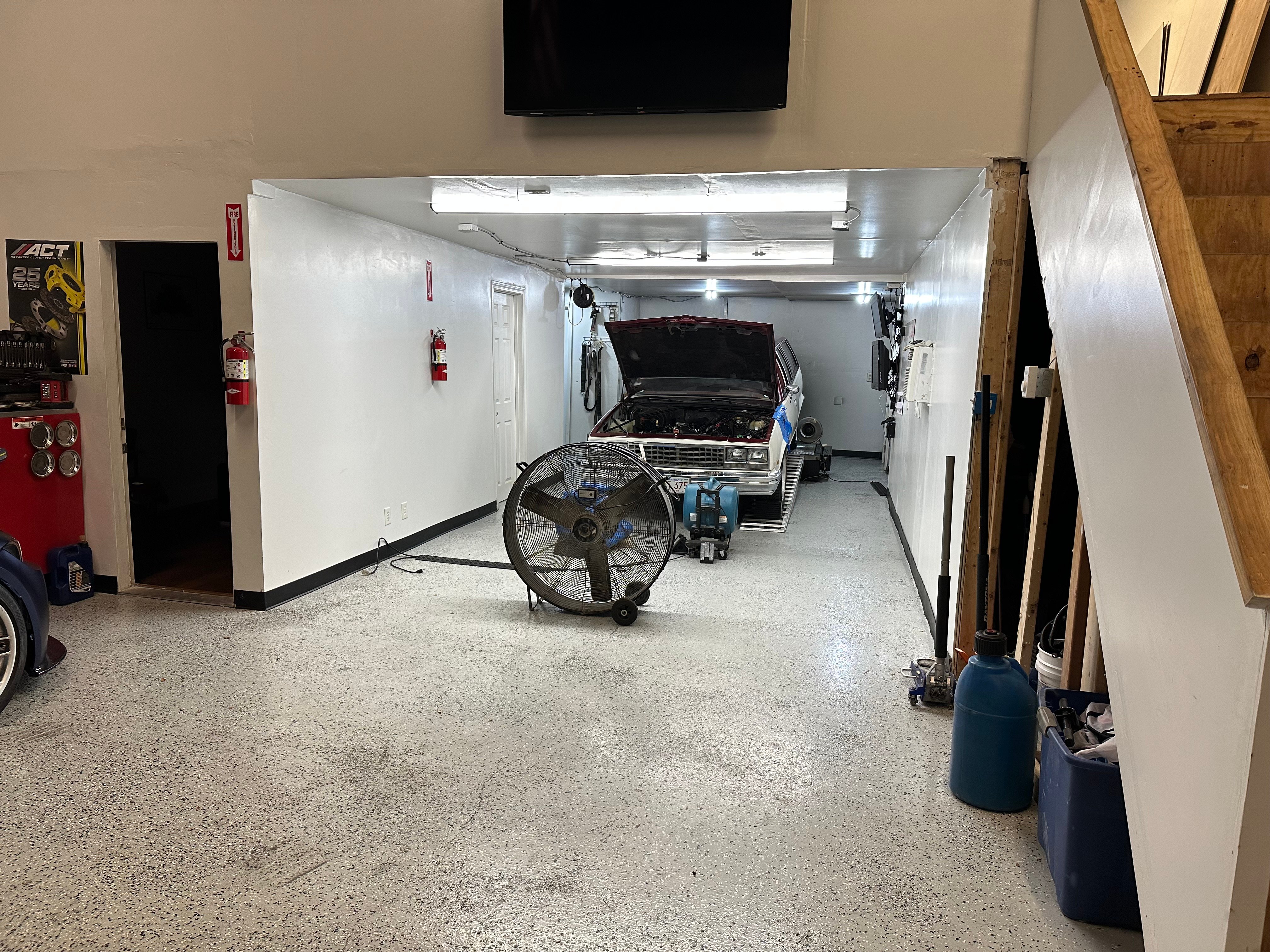

With the winter coming in New England, I’ve been sidetracked with construction and also house stuff. Recently started finalizing permanent heat for the garage, going with a ceiling mounted 60,000 btu heater. Hopefully it’ll arrive soon! Just got some new 6’ ceiling fans mounted, and can definitely notice much more air flow!
