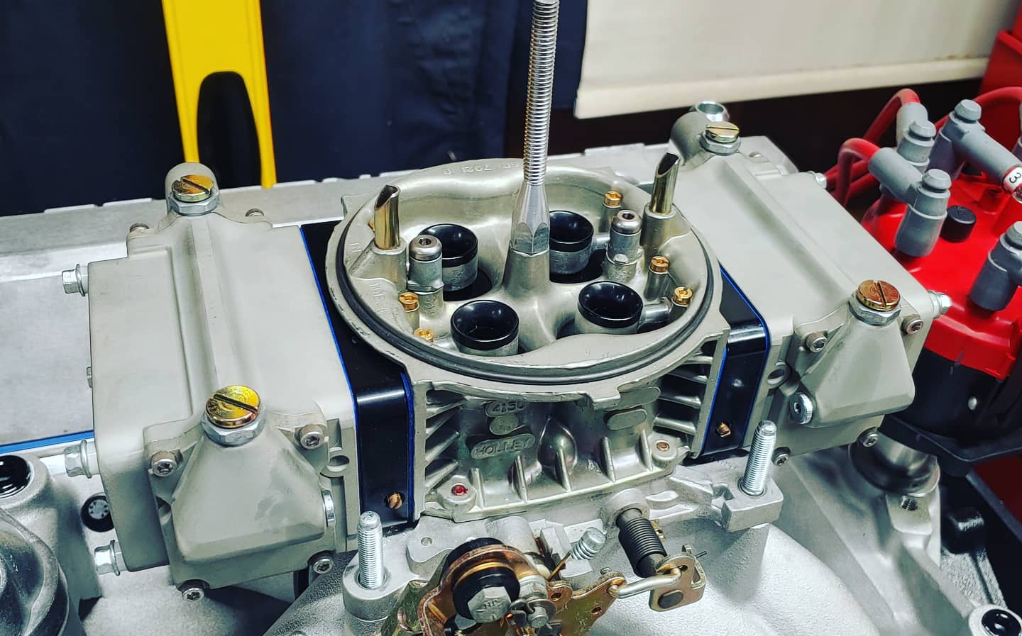

Got dual needle and seat bowls in. Cleaned the carb. Motor should be going to the dyno in a week or two.

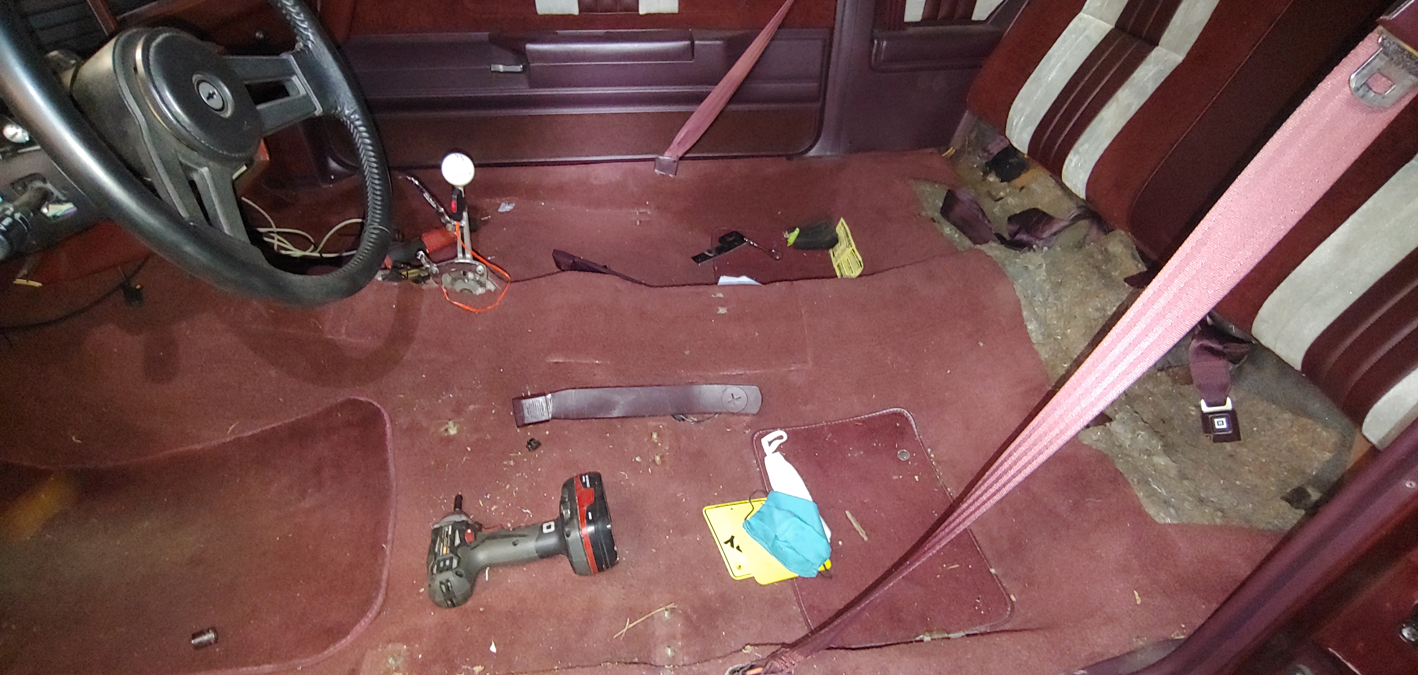

Started stripping the interior for the cage

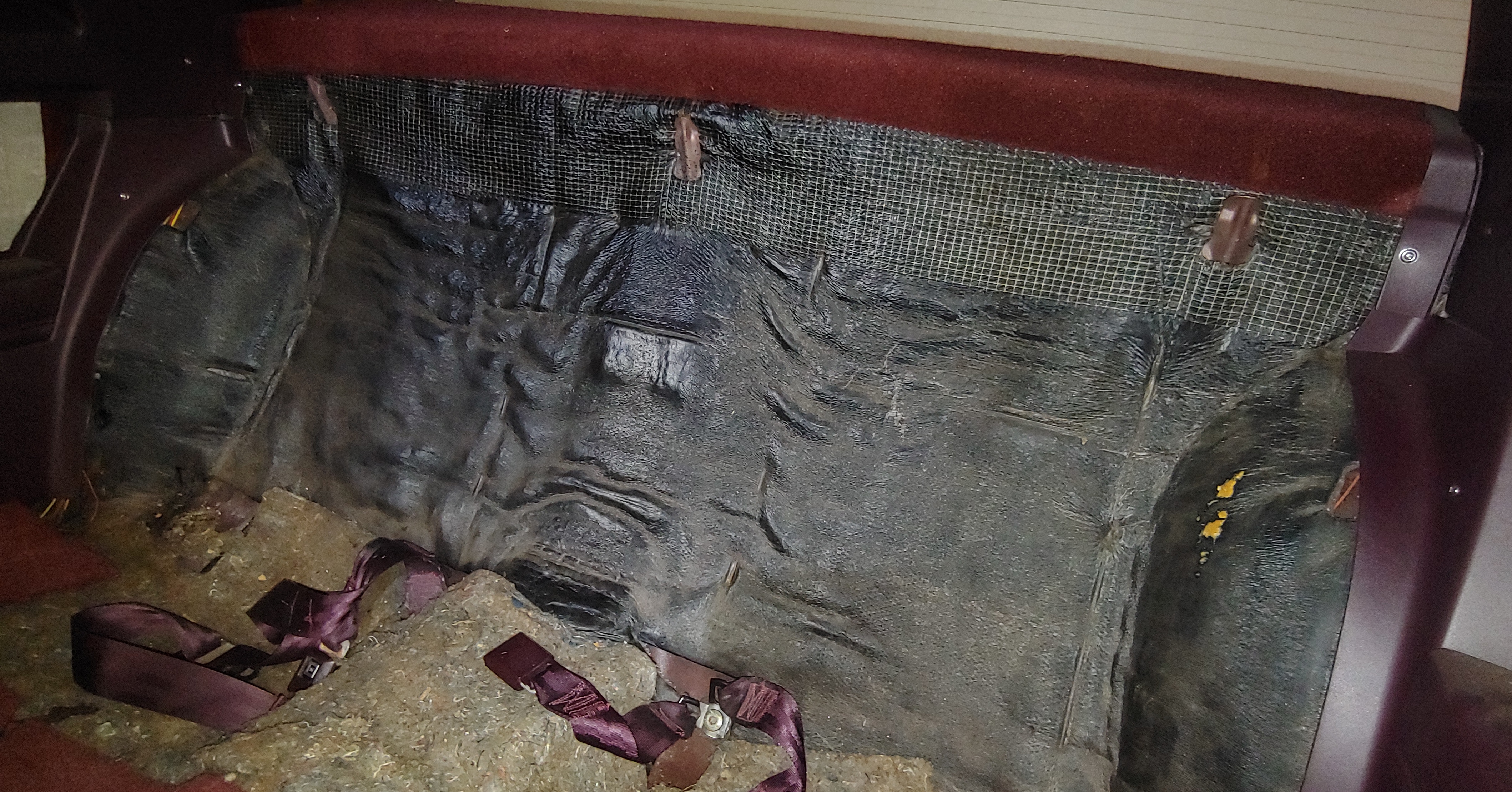

Started taking out body mount bolts. Tried 4 so far. Passenger and driver side furthest back by rear bumper came out fine and bolts looked amazingly good for 38 years old. The next two forward, the cage nut spun... So yay.
I have never seen a float bowl like that on a Holley before. What is the advantage to going with a dual needle and seat in each float bowl??
