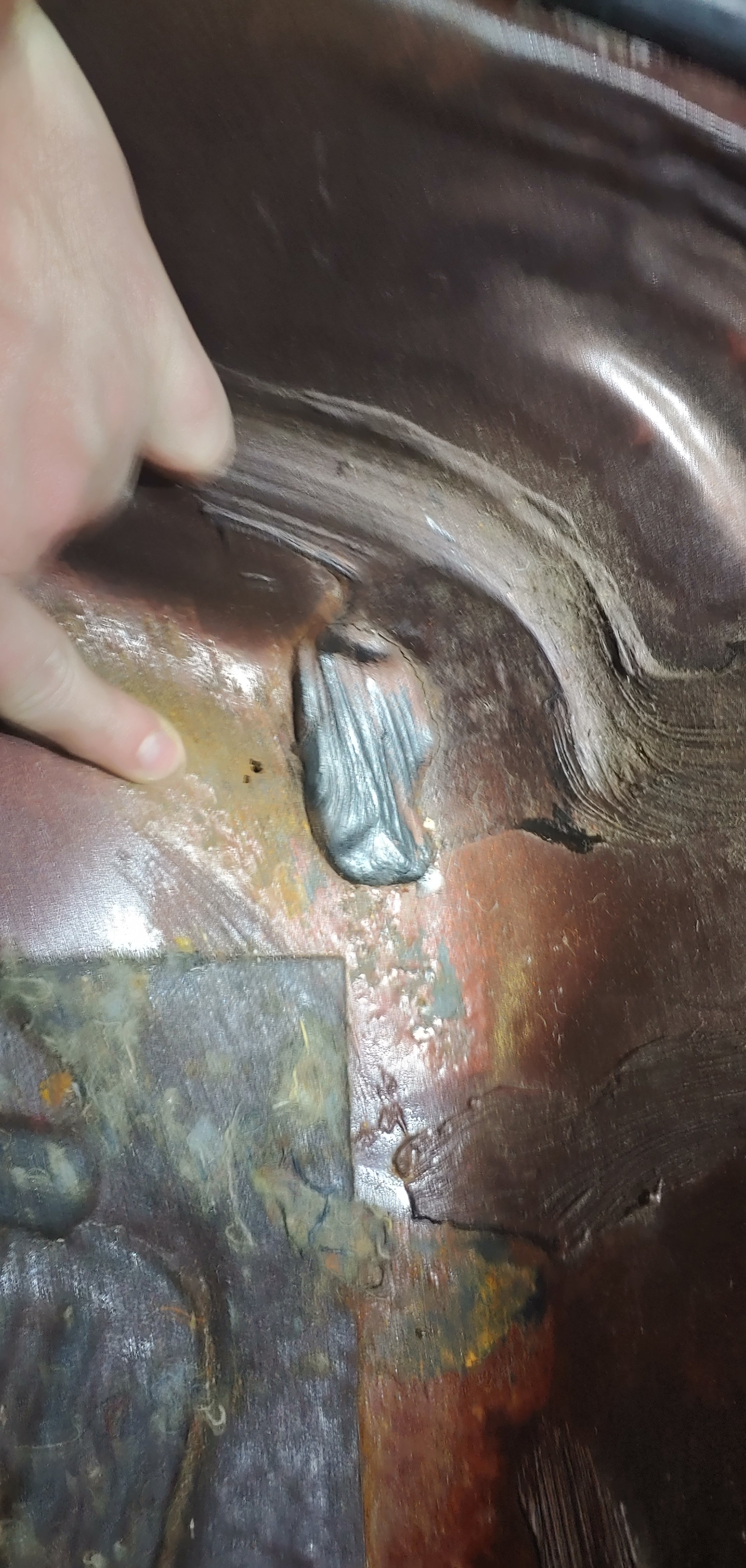

Started stripping the interior for the cage
Started taking out body mount bolts. Tried 4 so far. Passenger and driver side furthest back by rear bumper came out fine and bolts looked amazingly good for 38 years old. The next two forward, the cage nut spun... So yay.

I have been like that about them since I have owned the car, but I figure we are going to be swisscheesing the whole car anywhen when putting in the cage.... whats a few more holes lol.I am using the "if I don't look, everything is fine approach".
