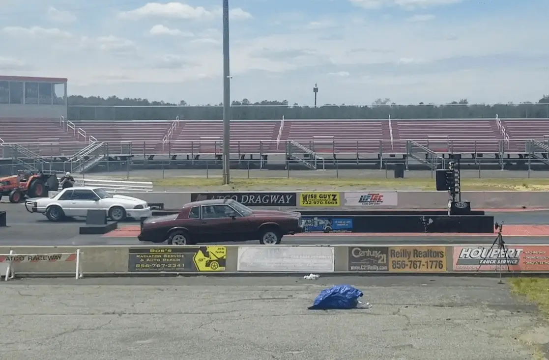

I made 4 passes. 1st one had to be aborted. First 10 cars down the track spun at 150ft out. It looked like there was so much pollen on the track that where they stopped prepping was like trying to drive on dust. One guy ahead of me ended up swapping lanes and I blew the tire off. I met my dad in the pits after and he said right after I went they held the lanes and went out and prepped some more. 2nd pass I foot braked it off idle, and I accidentally started in 2nd :blam:... I didnt even realize until I looked at my data logs and noticed only one shift. It ran a 9.6x @138. Next pass I left off the trans brake (in first!) at 3000 rpm and it ran 9.5x @140 with a 1.38 60'. Last pass(in the video) I left off the trans brake at 3500 RPM and it ran a 9.4x @ 141 with a 1.35 60'.
Converter is only showing ~4% slip right now. It will increase with another 150hp. I shouldnt have to spin it to 7500 to get to 150. Right now I am at almost 142 at 7000. Either way the motor is gunna have to do, what the motor is gunna have to do lol
