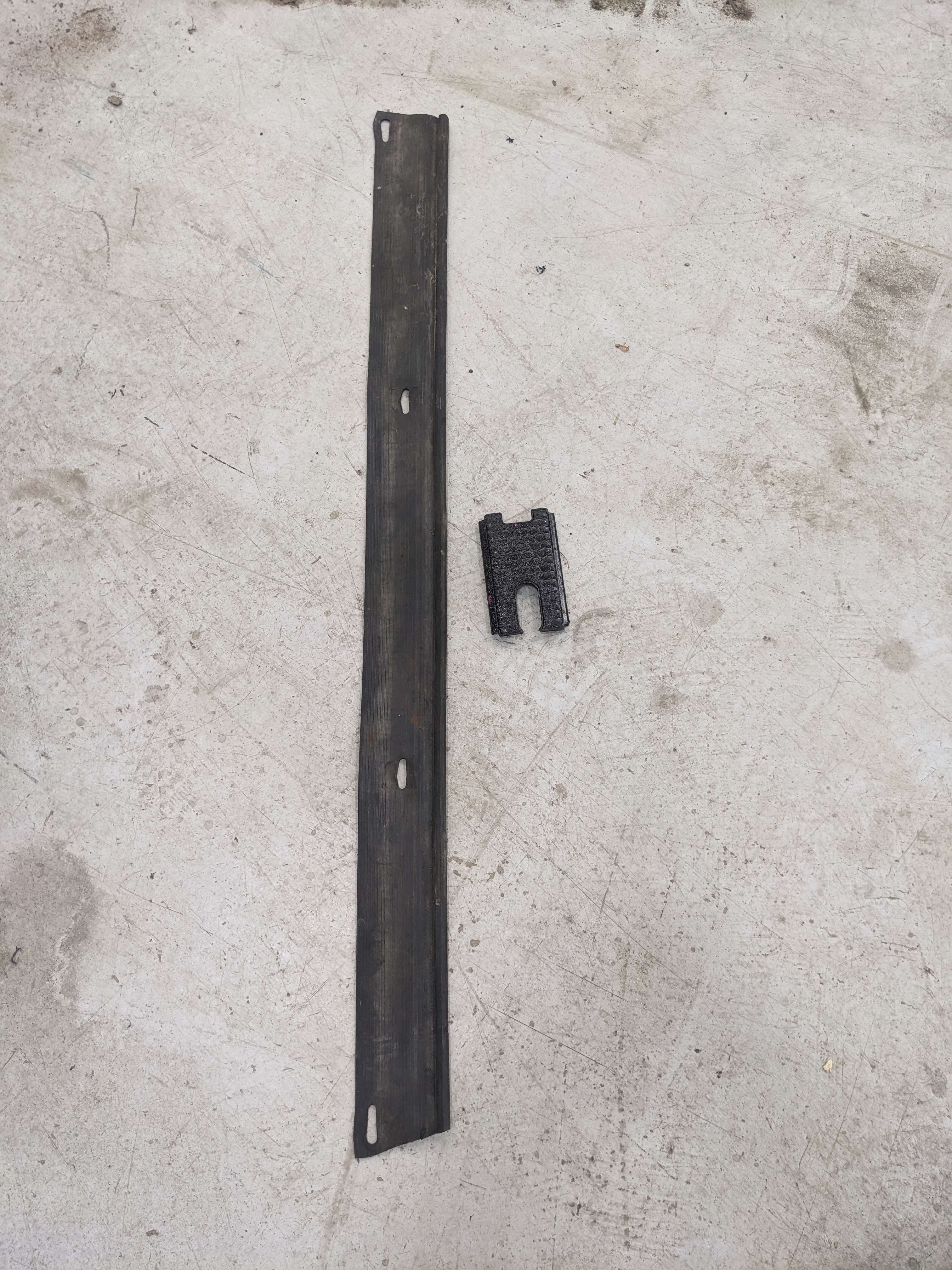

Truth be told, I'd like it to sit just a smidge lower (splitting hairs) to maximize fin exposure to airflow, but it's so much better than it was I really can't complain. Now that top cover sits as it should and I noticed the hood spring relief and bolt holes all line up. The thing was actually made for this car, it's not just a random piece. It's going to work beautifully. Success. Mostly. The hose fitting is sitting on the lower mount lip, I'll buzz that down tomorrow and try to get a rubber buffer back between the metal on metal. My dad had some lame foam tape that wasn't going to last forever on there but did its job.

Last night I spent most of my time cleaning up my mess. I was in a huge rush to knock out as much as possible before the fam got back so the mess took a back seat. That and I needed a lot of the crap I'd brought to do what I was doing. Once that was out of the way I whipped up an upper radiator mount. I still need to tweak it to sit down farther on the aft part of the radiator, but it otherwise came out pretty good for what it is.
It's deceiving to mock up as the core support deflects some as I tighten that bolt down. I need to make one for the other side too, but there's a bit less room to work around the shroud so we'll see what I come up with next time I'm out there. I next turned my sights to the petcock as it appeared to be weeping. M'fer wasn't even tight in the radiator tank so I removed it, cleaned the threads, applied thread sealant, and reinstalled. Time will tell if that's all it was, the rest of the petcock looked good to go. So that brings me to this little guy right here. This is where the Dakota temp sender was, but I moved it back to the factory location which was previously occupied my a redundant cheapo gauge, part of a cluster that was (surprise surprise) haphazardly installed. That mess is gone now, so I moved the sender and now I'm left with this.
