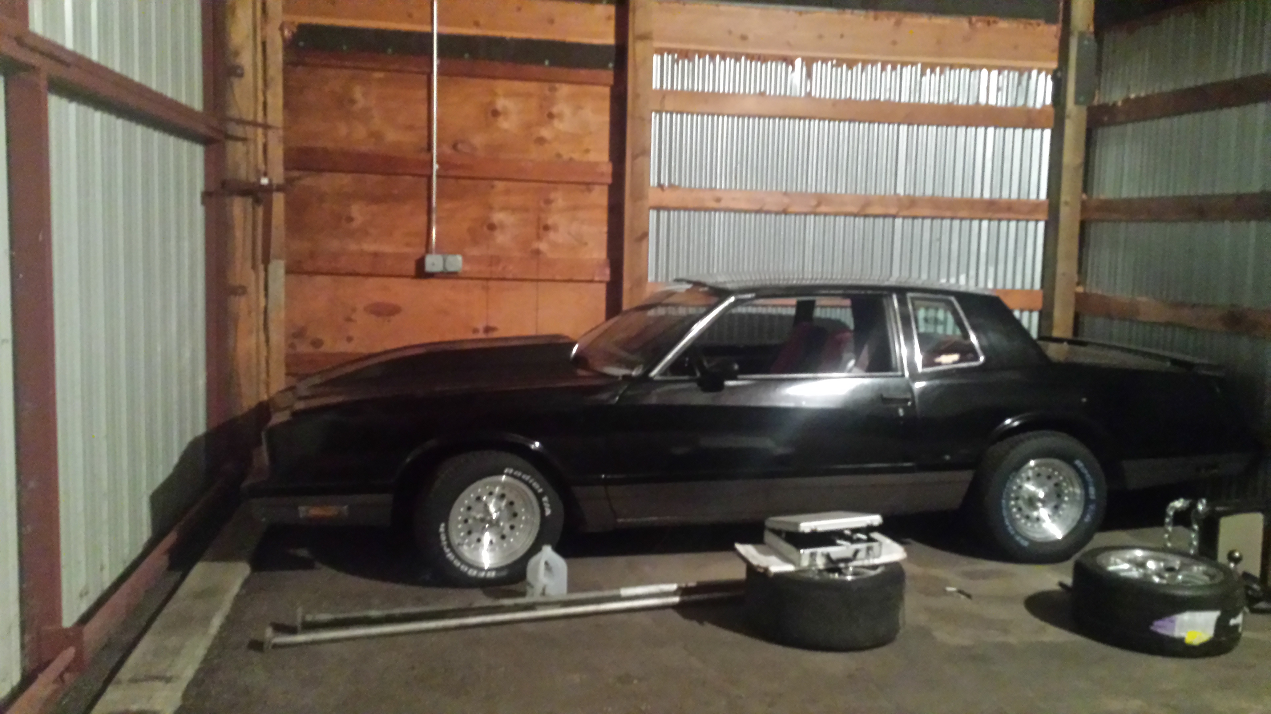

Prior to the first start attempt, but after the first rejet attempt, I took a peek at the alignment. 1/2" toe out, 1.8* positive camber on the driver's front, and 2.4* positive on the passenger front. Yikes. I went to shim the rear bolt on the right side to add caster and negative camber to the right side and quickly realized the shims were in the trunk. Doh!
I realized this after I loosened the bolts. Then I noticed 2 rusty shims laying on the frame, so I shoved those in and tightened it all back down. As I got to thinking I realized the added caster should help the pull, but the added camber would wash that out. Double doh. Oh well, I'll keep at it and get it eventually. I think by pulling those upper arms in more it'll toe the car in without touching a tie rod.
