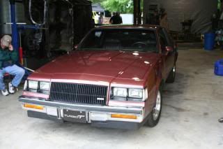

My valve covers have resorted to leaking again, I don't think I ever sealed them properly. I am now looking for cast aluminum covers to replace my cheesy stamped steel ones that don't even match. One is off of an earlier model, one is off of an 86-87 later model. Here is just an up-to-date pic of the car, with dad's Camry by its side and sis's boyfriend's GP behind-
