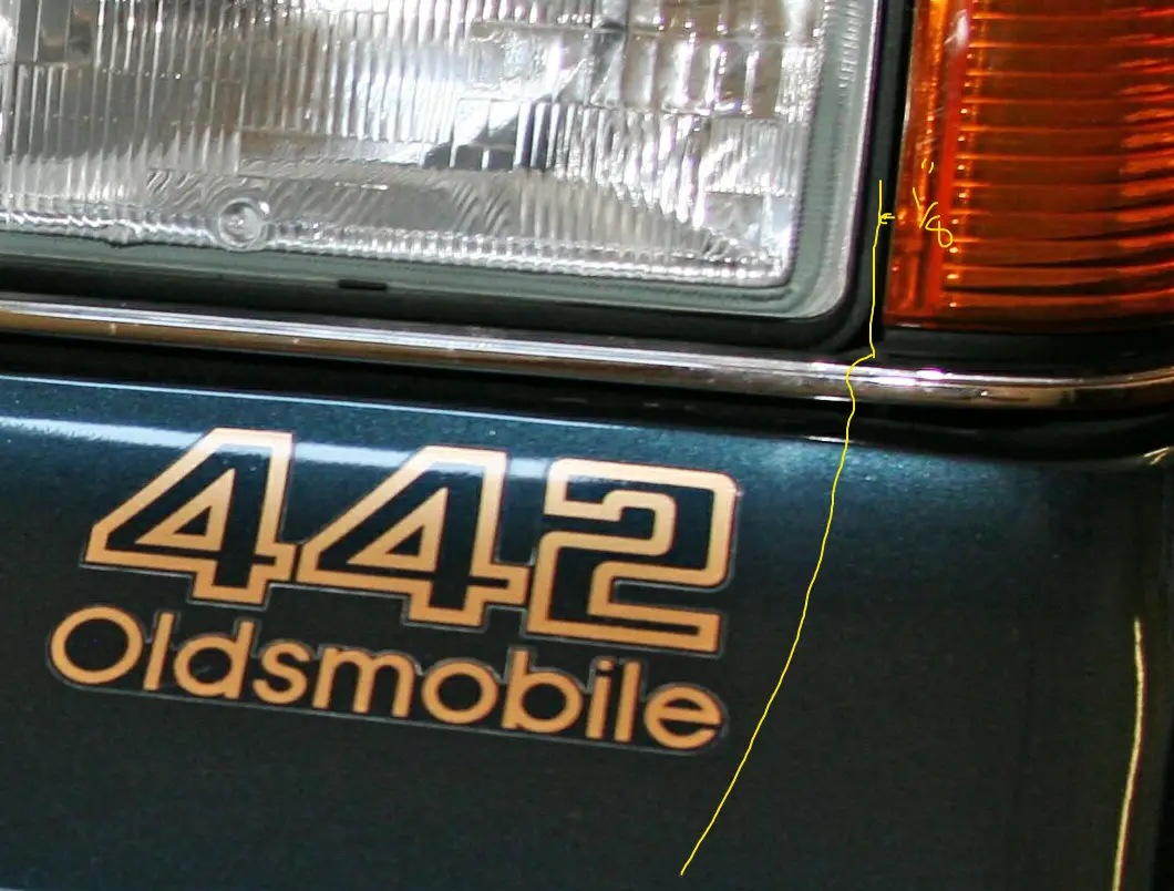

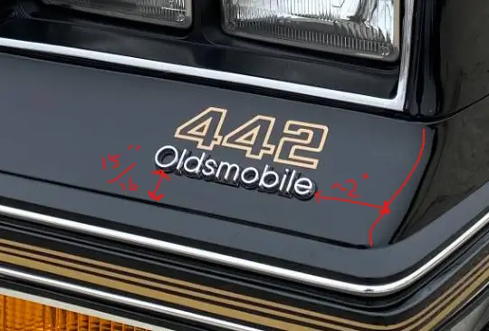

The bottom of the emblem for 81-86 Cutlass is 15/16" above the first "ledge" of the bumper cover. If you wanted, since the emblem never was there on an 88 in the first place, just get some 1" masking tape and run it across for alignment and call it a day. Only someone like me would probably notice or even care anyway.
It's JUST a BCH short of 2" from the edge of where the bumper cover bends.
Another option for left/right alignment for your 88 is to locate the gap between the LH cornering light and the headlamp. Measure in about 1/8" inward from the cornering lamp and then go straight down and that's where the "e" ends in "Oldsmobile".
Those emblems you have are both 85-up trunklid emblems, officially. The difference is they're not as pronounced as the 84-back Oldsmobile trunk emblems. Nor do they have the solid backing for the "m". The 84-back trunklid and front bumper emblems are essentially the same excep the front emblems mount with the pegs and not adhesive. If you want to nail down the front bumper emblem look, you would need to get the adhesive backed 84-back trunklid emblem GM p/n 555735.
Here's where you can use the side marker lamp to gage the end of the emblem. Can't go by the 87 442 decal because although the 442 part is the exact same size as the earlier decals, the Oldsmobile underneath is slightly smaller than the emblem.
