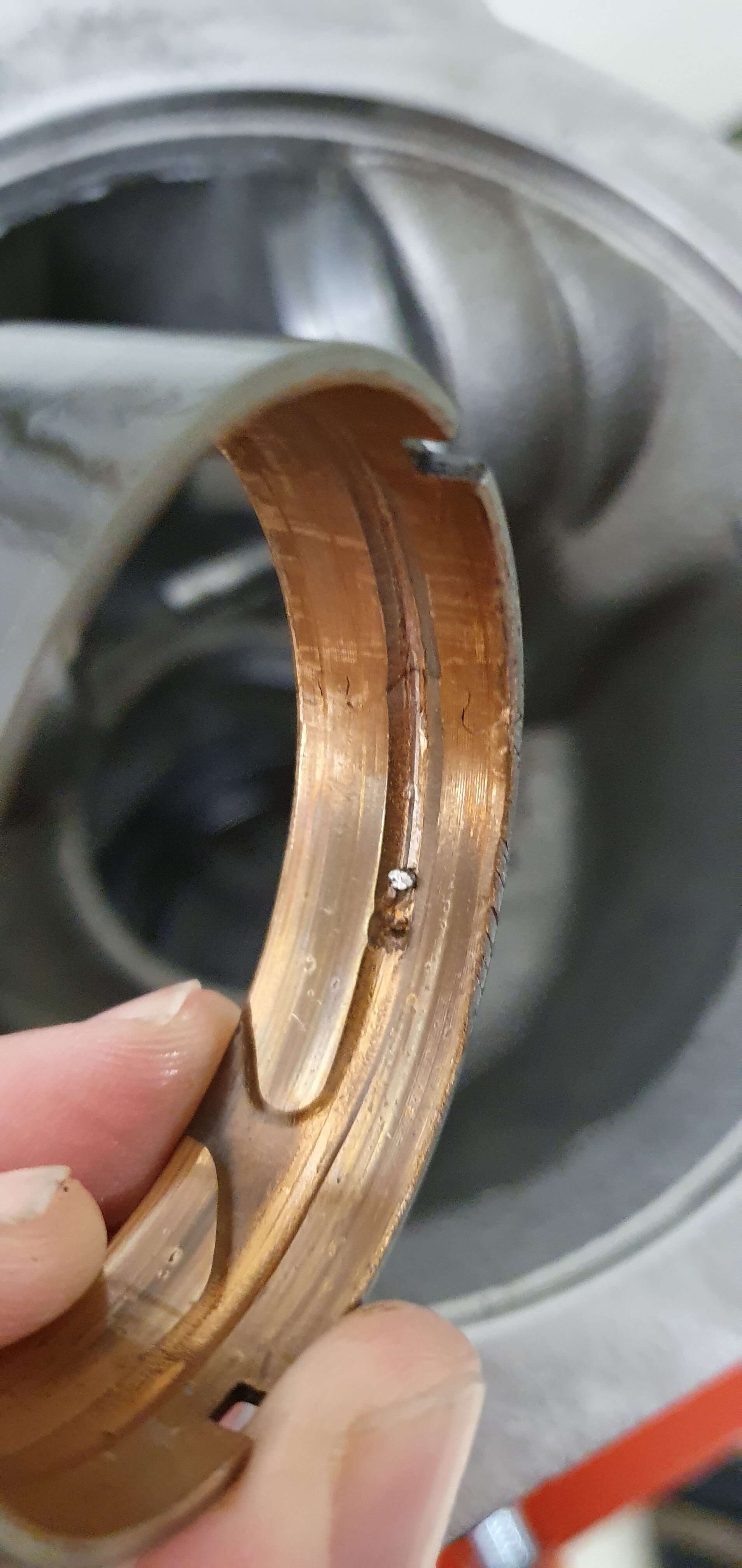

What wasn't so fun, is what I discovered while further disassembling and inspecting the TH400 (build by B&M).
The rear bushing ate some metal, but thank god, the rear output shaft isn't damaged in any way. It seems that this got assembled in a dirty place with no respect for quality.
View attachment 208172View attachment 208173View attachment 208174
And to ice the cake, there was a seal ring missing inside the main assembly.
I will post updates as soon as I received the parts for the rebuild... One thing is for sure, B&M will never get any money from me ever again...
