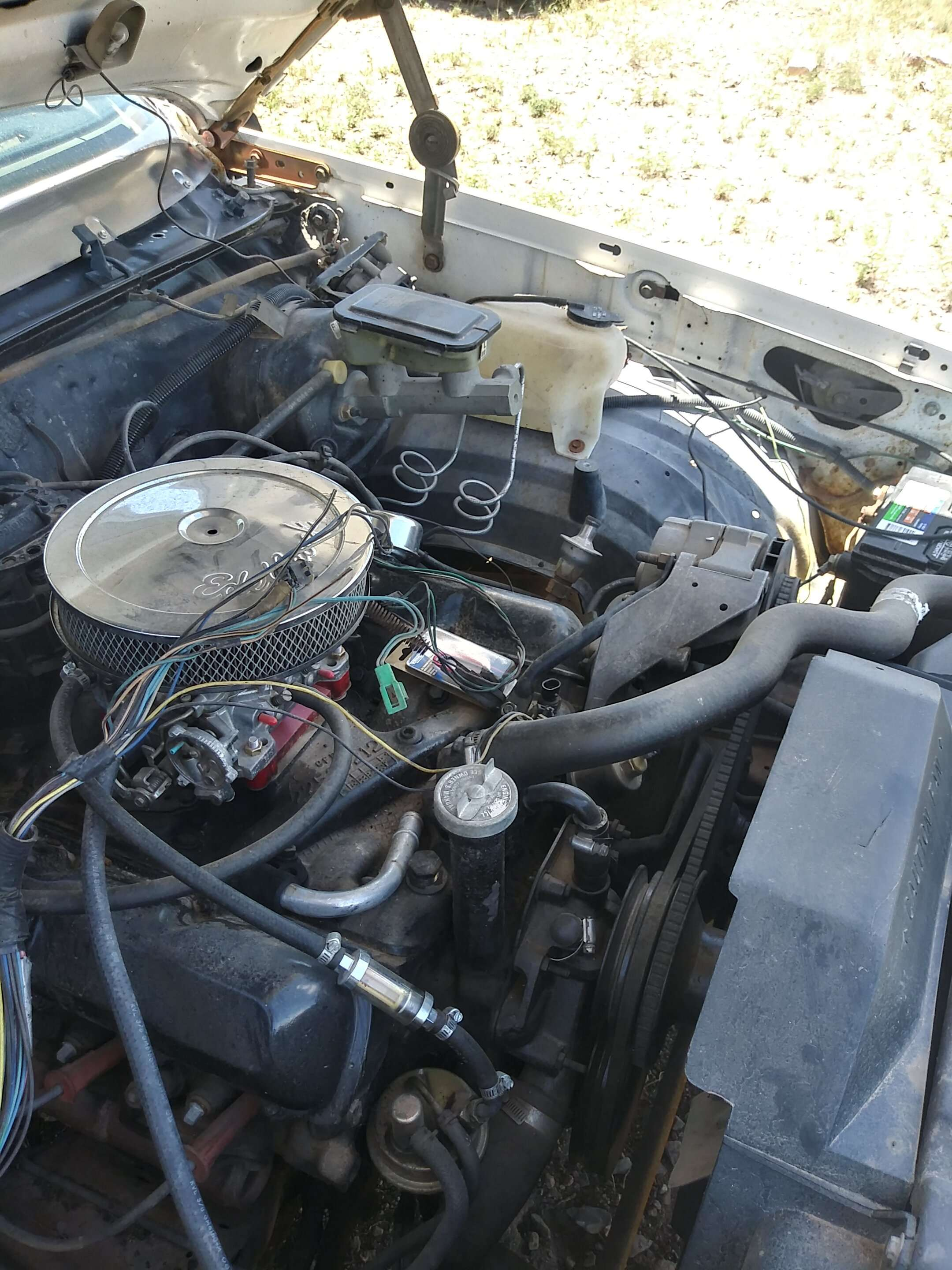

It's been awhile on follow up. All the parts were ordered for the conversion, still waiting on some.
Pic below shows wires left over from removing the C3 Q-jet on the 86. None of those wires are needed and can be cut off, just hadn't done it yet.
You really should not cut up good harnesses.
You are right, these were taped and zippie tied out of the way. Just example, showing OP many of the connectors not needed when converting over to a Carb non ECU system. I don't have to emission cert when I live, but if sold and the customer does..., the car has to be taken back to OEM and pass before can be plated.
Regarding the THM 350, the "350C" model has a lock up convertor, and has the "TV" cable. B&M makes a small controller that hooks to your speedo cable, allowing you select a speed at which is locks up the convertor. I bought a $10 vacuum switch, wired the power to the B&M to it, so when I tromp the gas, the convertor unlocks. Works great.
Someone said you can't use HEI w/o the computer....Accel has a HEI distributor on Ebay for $29 new, with damaged packaging. I bought 2, packaging was fine, but it's a good deal. Gets rid of the computer control and gives you a vacuum advance. Word of caution: the module in it won't tolerate a high energy coil...I put the MSD coil in and the module immediately blew out, so I replaced it with the 2nd one and it blew too. A NAPA module ($35) works, but I've now upgraded with the MSD high reliability "circle track" version ($60) .
Regarding the "check engine" light, not sure if the 4.3 is the same as the 5.0, but if it is, there's a plastic module taped to the IP harness on the right side (closest to the door) of the glovebox door. If I recall correctly, it's green plastic. There's a plug in PCB in that module that's the check engine lamp driver. Unplug it and the light goes off.
Reactions: 78Delta88
Gotta get rid of that up there 👆 Glass filters are a insurance loss claim in waiting.
Haven't had any issues with them thus far. That one was in there to see pump sufficiency and see what fuel is going through as it sat for 12 years before I got it. Tank was dropped, cleaned, and replaced with new sender. Lines were blown out but still ran a couple gallons fresh at a time for a few times until fuel would run clear.
I'd still replace it. Back on Easter, the wife's nephew had his square body burn down in his driveway after returning from Easter services. Was told over five years ago to replace it but never did or even service it with new O-rings & filter & his luck ran out.
