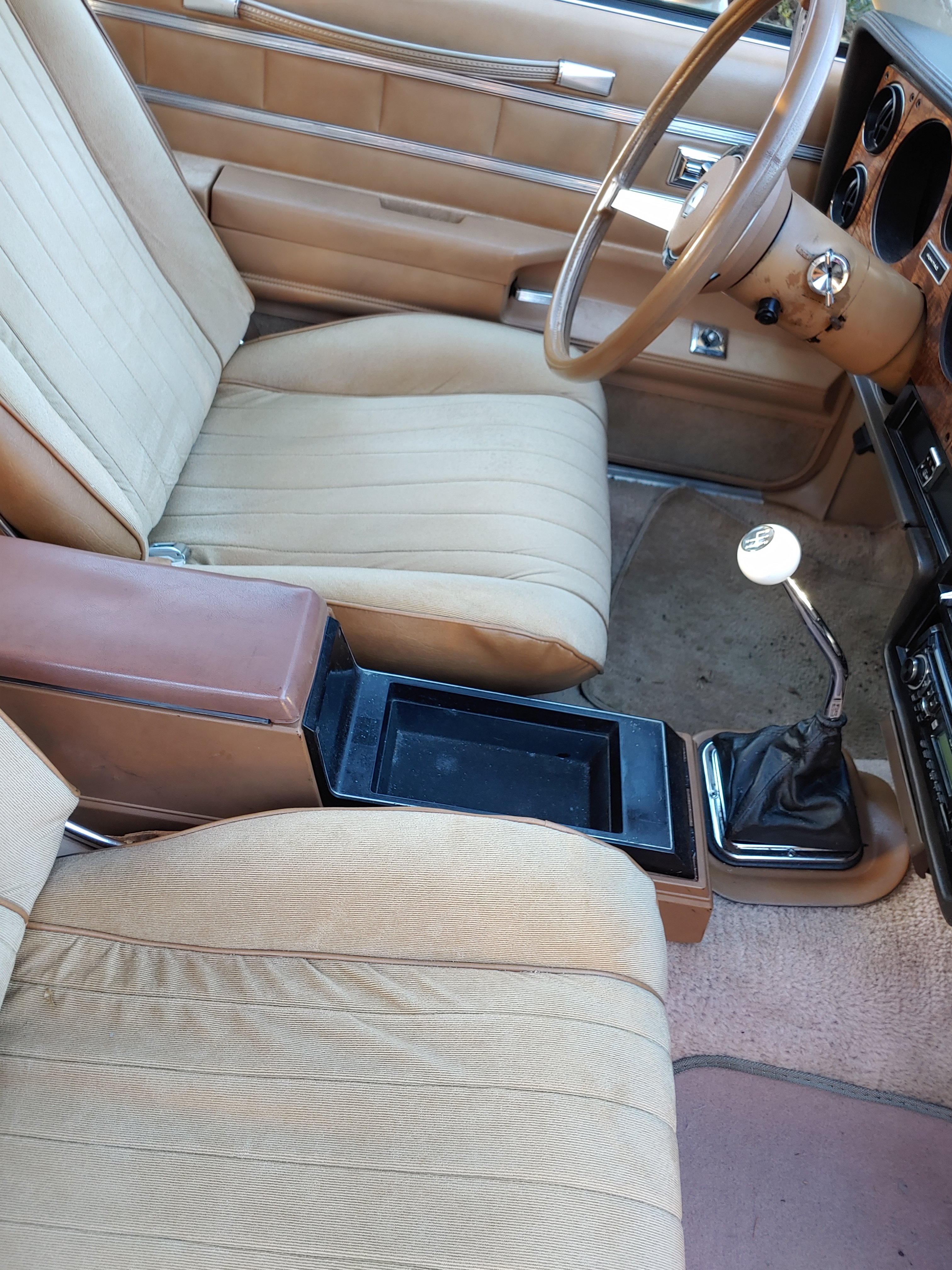

I've got a 1987 pontiac grand prix it was originally a automatic in the floor since then I've converted it to factory z bar and installed a 4spd. I'm wondering what you guys are using for consoles after this conversion!
Here is my 85 Cutlass Salon 4-speed conversion with ultra rare console. at time of these photos it was a 5.0L H.O. Muncie M21 8.5 Posi. Last summer I put i na 68 455 C heads with 11inch clutch. Working on headers and exhaust this year $$$.
