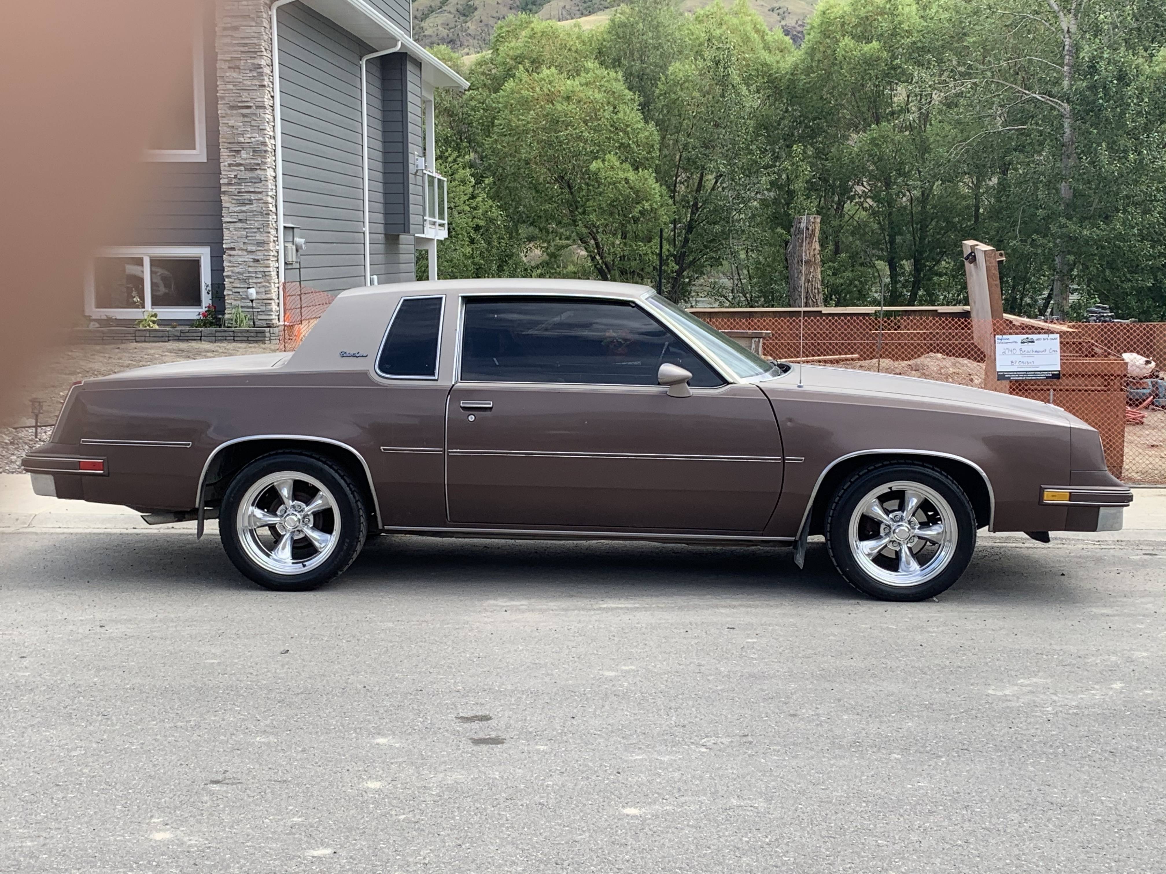

If using 5660 spring with half coil removed and bmr 1 1/2” drop rear springs , can a guy still use stock height shocks ( bilstein) ?
I eventually want this car to be a tight handling highway / road car but for now I just need to get it down over the wheels a little more
I eventually want this car to be a tight handling highway / road car but for now I just need to get it down over the wheels a little more View attachment 180489
Your car but I think it looks great just the way it sits. What size tires and rims ?
this is a view from both sides, it’s parked on slightly uneven ground ,that’s why it’s different one side to the other .
there is a pretty good fender gap there that I want to shrink

thank you ,I really like it but there is too much air over back tire and I want a little bit of rake to her
The wheels are 17x8 all 4
With 4 3/4 backspace front , 4” bs on rear
245 45 17 front and 255 45 17 rear

Thank you for saying it! I love the thumbs up I get …well the car gets lol
I’m really happy with the staggered backspace front and rear , it helps give the effect of having wider wheels on the back because you see more lip
