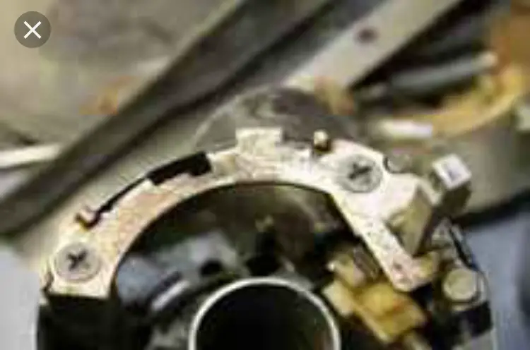

Not mine but this is what it looks like I believe it may be called a detent plate

#19 on the drawing:
Here's a picture of the non-tilt Gate. Can't find one for the tilt gate.
