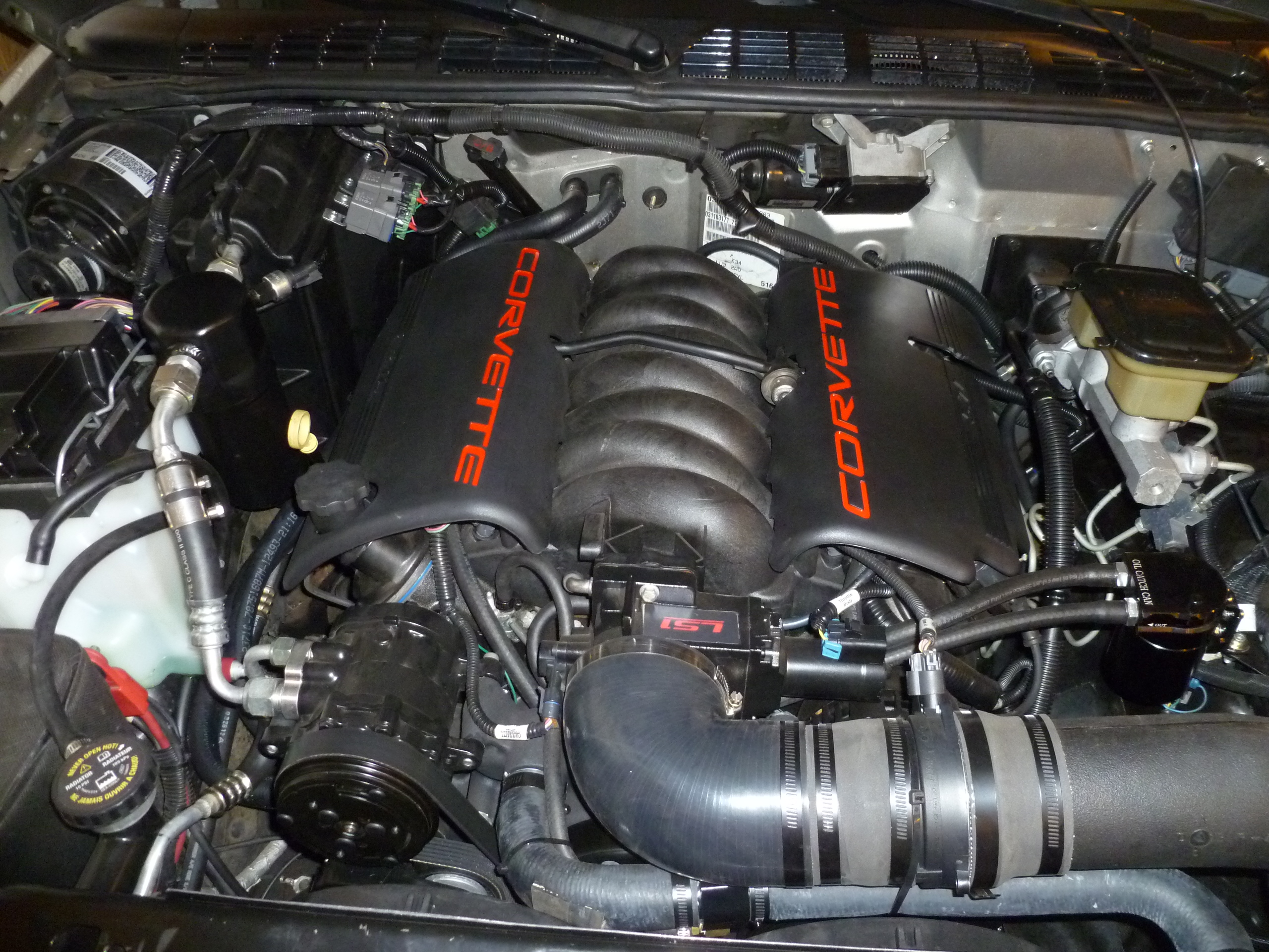

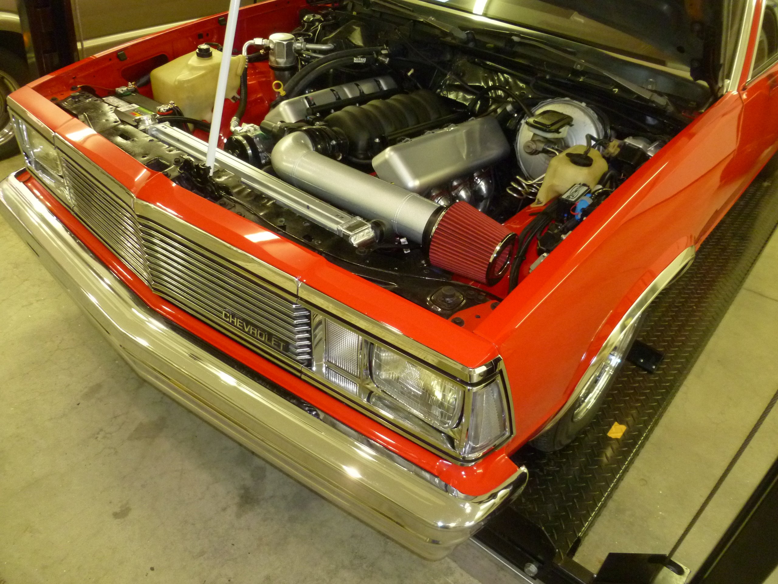

Cool truck. I totally dig the LS swap, but I imagine you will generate a lot of hate for discarding the turbo 4.3. I've done 4 of these LS swaps. the best two were with L96 truck motors with LS3 intakes (so they wouldn't look like ugly truck motors), lots of Holley parts (too expensive but the most compact accessory systems), Dirty Dingo mounts, etc... My 03 Sonoma needed the Holly evaporator side panel and hydro boost to get room around the engine. The G bodies are a little easier (the extra few inches of width make a big difference). My 81 Coupe de Ville was the coolest, L96, LS3 intake, 4l60e trans and Impala SS suspension, rear axle etc... Y

Cool truck. I totally dig the LS swap, but I imagine you will generate a lot of hate for discarding the turbo 4.3. I've done 4 of these LS swaps. the best two were with L96 truck motors with LS3 intakes (so they wouldn't look like ugly truck motors), lots of Holley parts (too expensive but the most compact accessory systems), Dirty Dingo mounts, etc... My 03 Sonoma needed the Holly evaporator side panel and hydro boost to get room around the engine. The G bodies are a little easier (the extra few inches of width make a big difference). My 81 Coupe de Ville was the coolest, L96, LS3 intake, 4l60e trans and Impala SS suspension, rear axle etc... YView attachment 250056View attachment 250057View attachment 250058View attachment 250065View attachment 250066View attachment 250067View attachment 250069View attachment 250071
