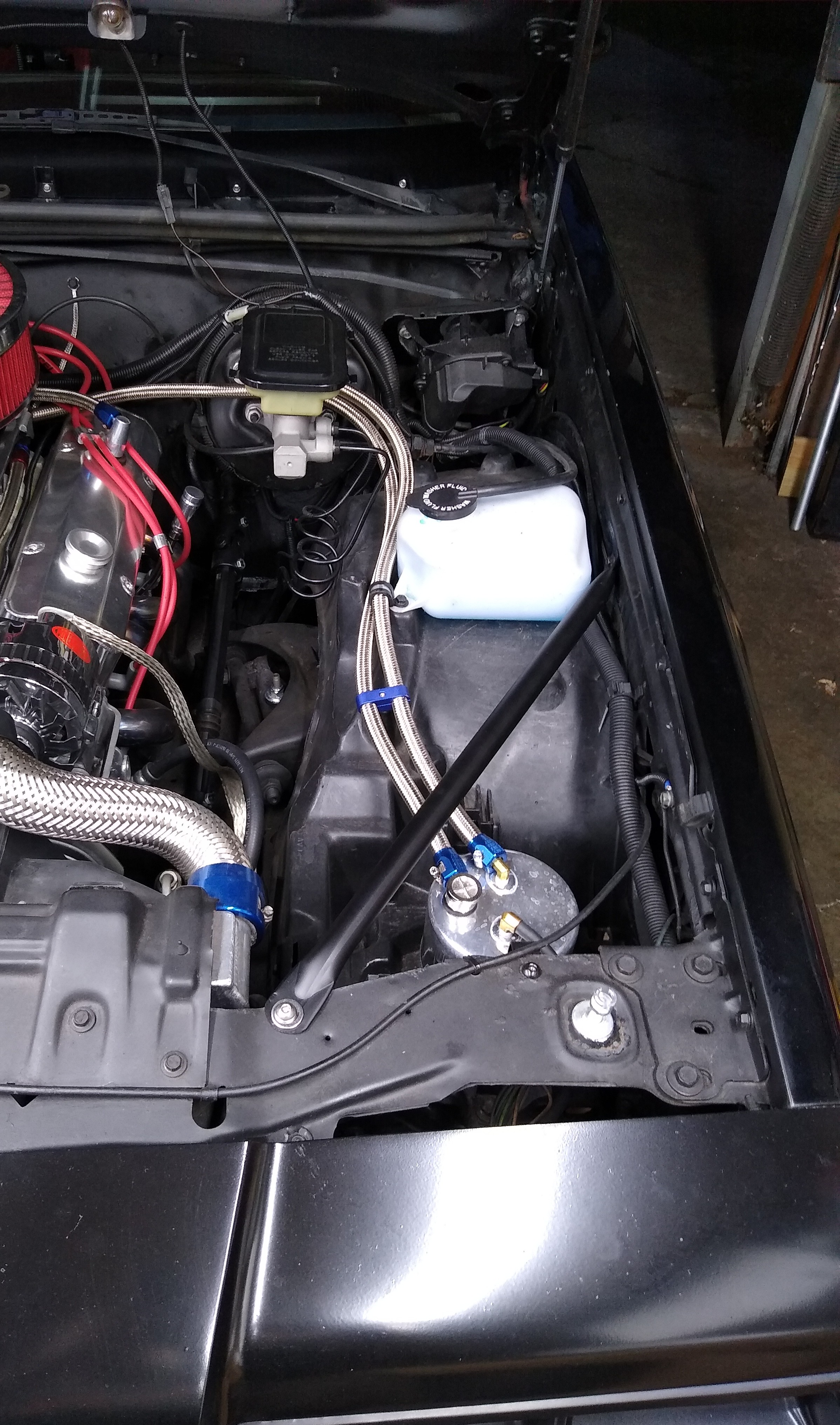

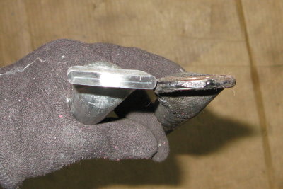

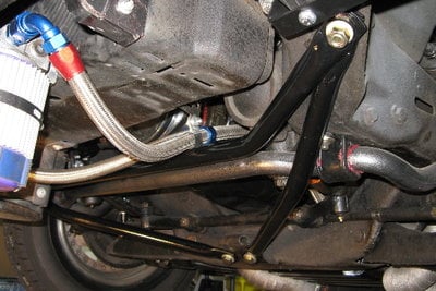

I made both of my jounce bars and GP bar out of rigid conduit, which is nearly twice as thick as the factory bars and I also made a crimper to put a nice crimp on the ends which I also used when I made fender to core support braces.
I feel like this set up made a vast improvement even over just having the stock set up.

Do you know who sells those Fender to Care Support Braces? I saw someone that had them but couldn't find a vendor for them in my searching.

Do you recall what the wall thickness was of the conduit used for your home-built braces?
I believe I used 3/4" rigid EMT which is .107" wall thickness.
