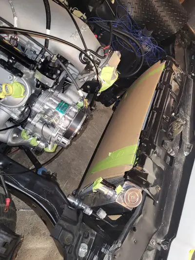

I would buy a Gbody radiator for the LS swap so you don't have to run that ridiculously long upper radiator hose to the driver's side.
Passenger side top hose. Any size or style you want since they are threaded adapters. Bottom hose is pretty close to the frame.
Most importantly, it has the connection for the steam port.
Definitely not a cheap radiator. From TurboNasty.com
