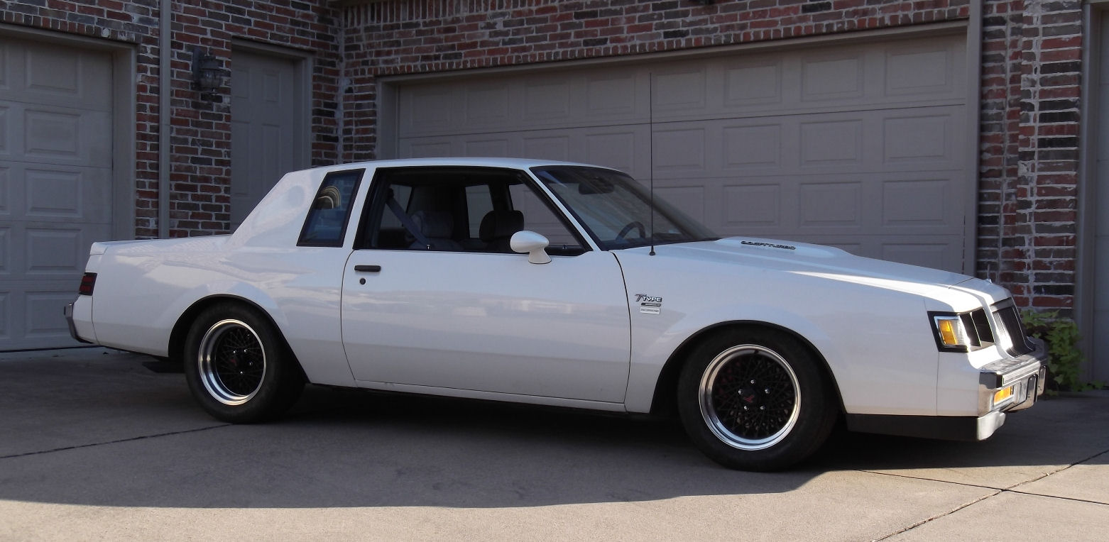

Bilsteins give an excellent ride. On my lowered Buick, I've got cut 5662 (706"/bl) front spring, 1/2" taller LBJ's and S10 Extreme Bump stops and ride is excellent with no suspension bottoming in normal driving with 255/50's on GTA's. It should be harsh, but it is not.
Another vote for Bilsteins.. I already have them on order. I have a friend who has them and I was sold. I havent been able to compare them to anything else but whatever came on my cutlass, which is probably oem or worse.
UNGN: That is perfect.. What do you have in the rear?
